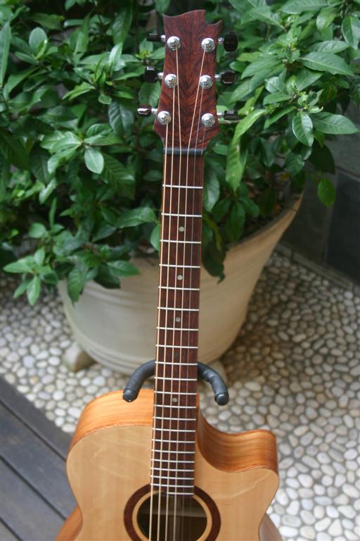

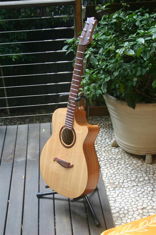

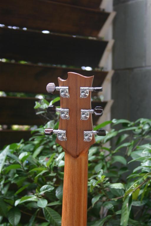

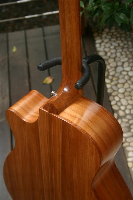

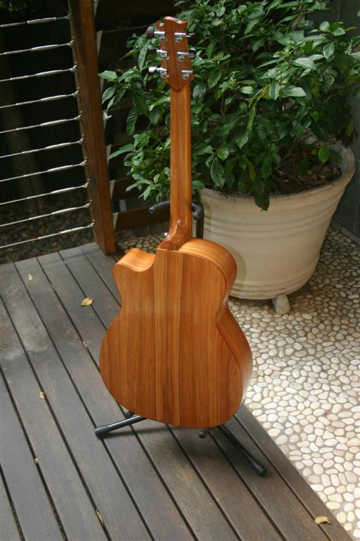

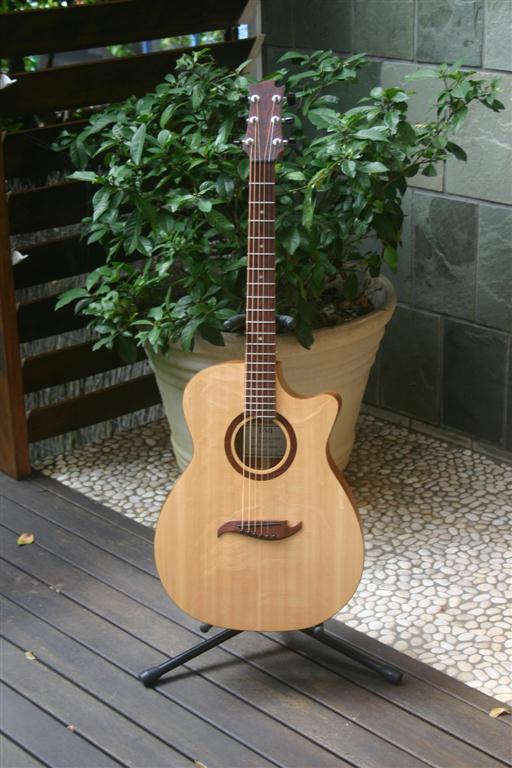

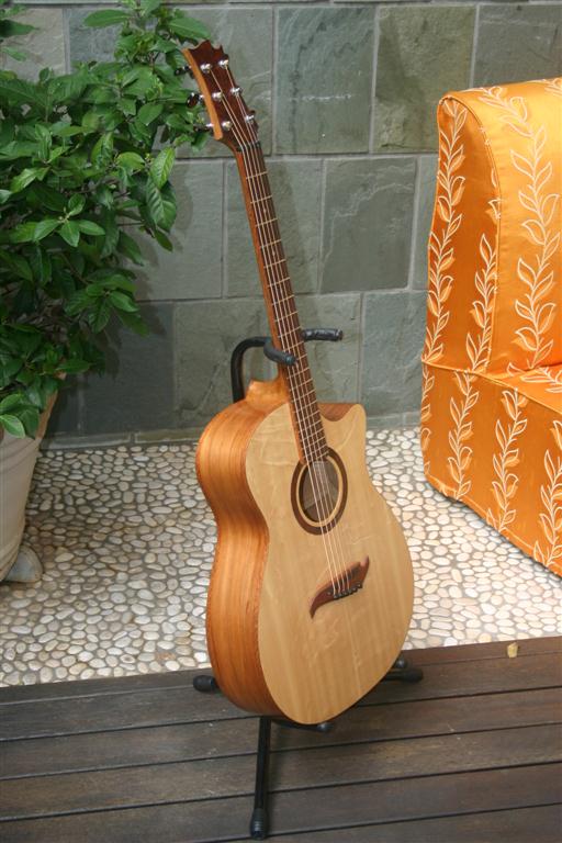

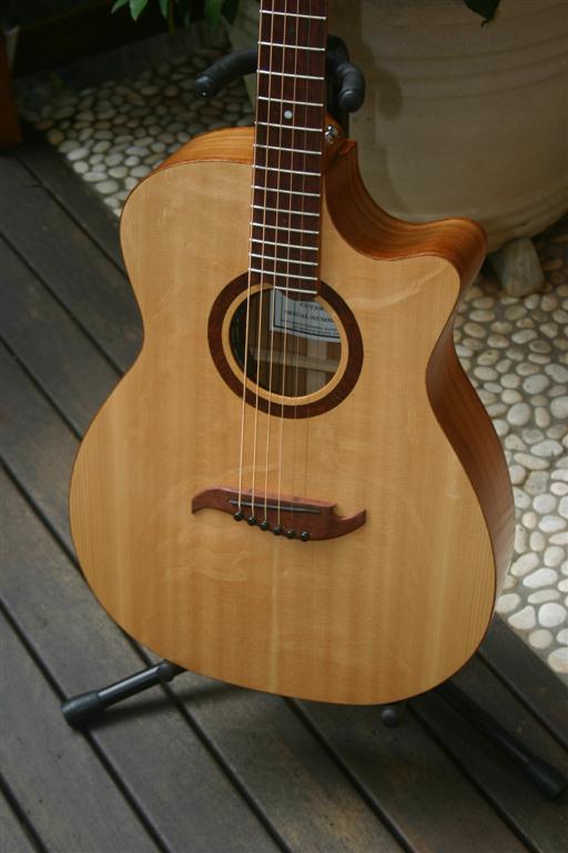

Post by nnickusa » Fri Mar 08, 2013 1:37 pm
Tho I call mine the Brunswick Rose(Cutaway)
Bearclaw SItka top, Rimu back/sides/neck, Jarrah burl headplate and rosette, Jarrah bridge and fingerboard. Lacewood bindings body and neck. Grovers with Ziricote buttons, and black buffalo horn nut and saddle with ebony pins. TRu Oil finish-just wipe on-wipe off.

Still not perfect, but quite a bit better than the last two, and sounds pretty good for day one! Also has a Fishman Matrix Ellipse in it....
Thanks for looking

Hi Nick,
I know you will agree , Nobody should buy any Heart Rimu it clearly looks terrible , is hard to work and sounds terrible, ( Christian if you wan to get rid of that Stuff, Nick and I will take the rest of your hands cause we are good blokes and want to help) I'm sorry you had to work with that stuff , I'm still in trauma. :( :( :( :(
But your bridge looks very nice , as does yor neck , headplate , rosette , soundboard , bindings , fretboard and the Shape of your headstock is really cool . :cl :cl :cl :cl :cl :cl :cl
I also love the soft natural look of the oil finish!. :cl :cl :cl :cl despite being applied to Pore Ridden, Ugly timber that no one else should buy, especially Martin.
Again don't buy Heart Rimu , it's too late for Nick and Myself , I'm already burdened with 4 sets , plus two more on order and whatever else Christian will sell me, but no too late for others, especially Martin.

Hi Nick,
Looks great. I like the way you've tied it all together with the bridge and headstock motif.

Ohhhh Woe is me, clearly burdened by the weight of 3/4 of a cube of this revolting timber on my doorstep.... perhaps a stray match.... would relieve me of the day to day disappointment of looking and working with this scourge of the tonewood world.
Love the Guitar Nick!!! its a really nice design, especially the the headstock and echoed bridge design.
and very well made indeed !!!
Congrats Mate!!

I'm set on the bridge, but am still playing with slight changes in the headstock, mostly for straighter string lines from the nut. The next one is subtly different, and I think I like it better already, even in the early stages.
As we discussed earlier, I think the less-glossy finish of the Tru-Oil really sets off the Rimu. Might try a combination soom. Tru-oil on all but FP on the top. I think that would have made the bearclaw jump more.....20/20 hindsight...
Anyway, this one is done, in my book, and it's my best so far, so I'm chuffed. Time for a celebratory :gui

Nice Work Nick, I like the bridge,but it looks heavy , have you weighed one ?
nnickusa
Posts: 901
Re: Another ANZUS Guitar
Post by nnickusa » Fri Mar 08, 2013 7:20 pm
26gm. this one

Nice job Nick, you've complimented that Earthy Rimu nicely with the other appointments (bindings and top don't over power it) and the tru-oil finish. I think Rimu is one of those timbers just made for an oiled finish. :cl :cl :cl
