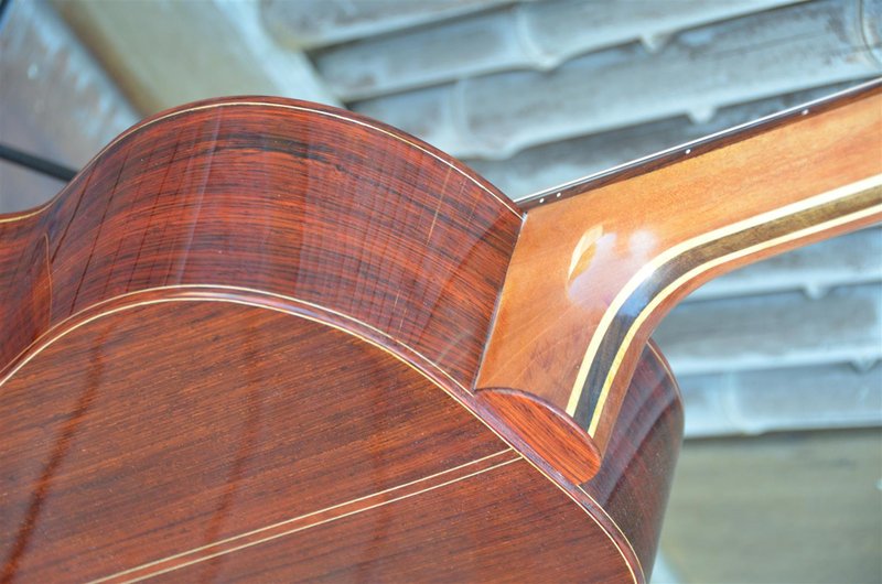

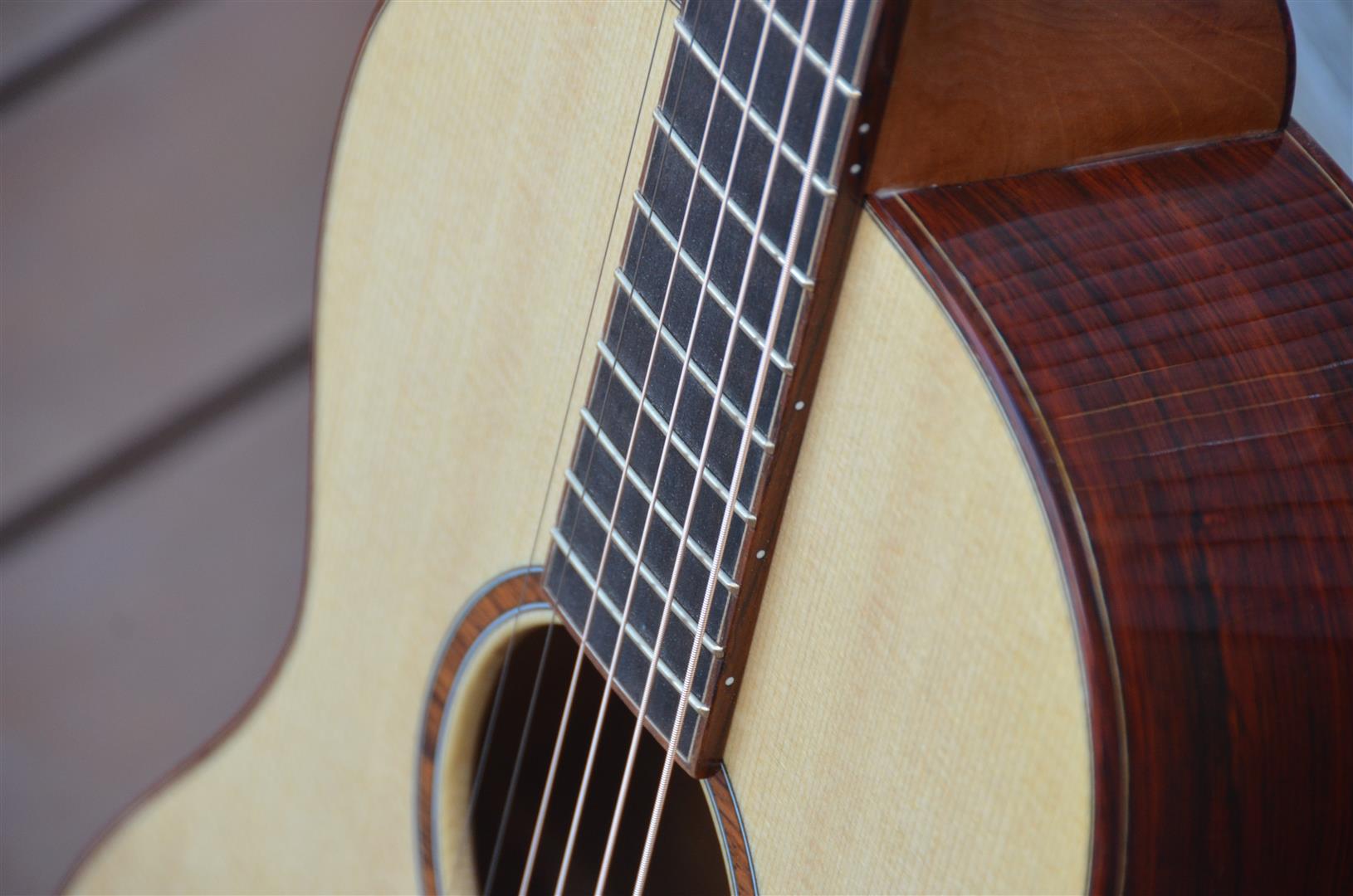

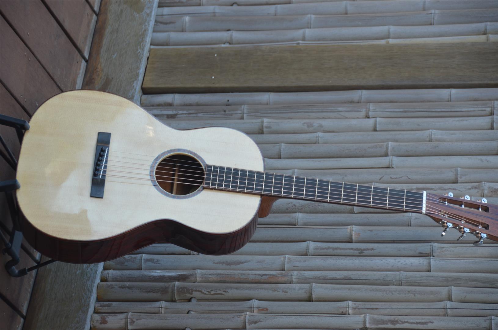

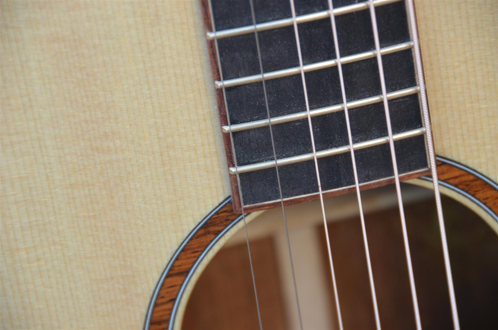

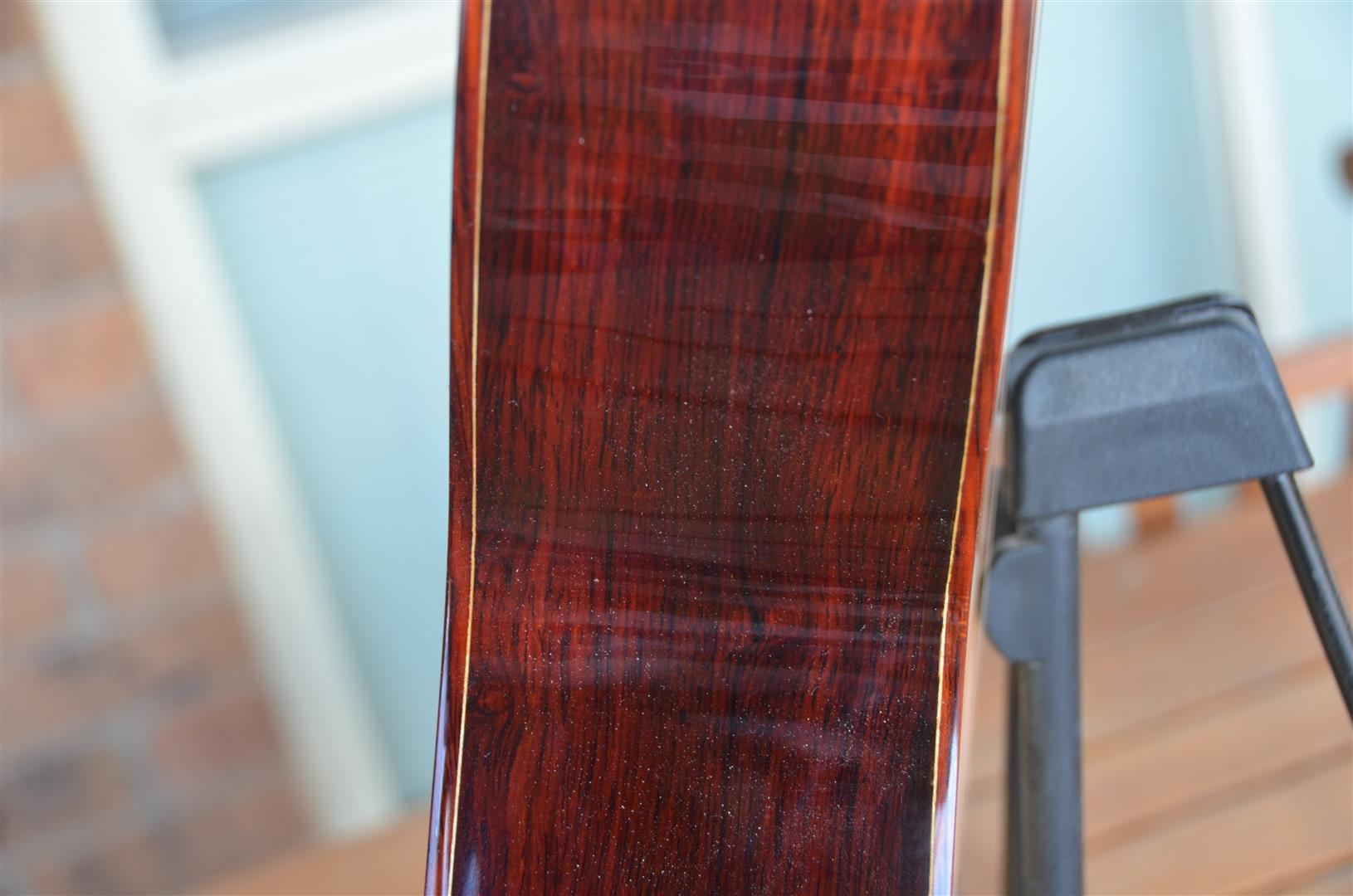

Post by Bob Connor » Mon Feb 04, 2013 6:27 pm
This going out the door in about half an hour but I'm getting it back to show down at Port Fairy in a month's time.
Specs
Left Handed
Back/sides/bindings/rosette/peghead overlays : Cocobolo
Top: Euro Spruce
Fingerboard/bridge:Ebony
Neck: Mahogany/Satin Box/Blackwood/Satin Box
Tuners: Waverleys
Frets: Gold Evo
Sounds pretty nice but it's pretty hard to get a sound out of a lefty.

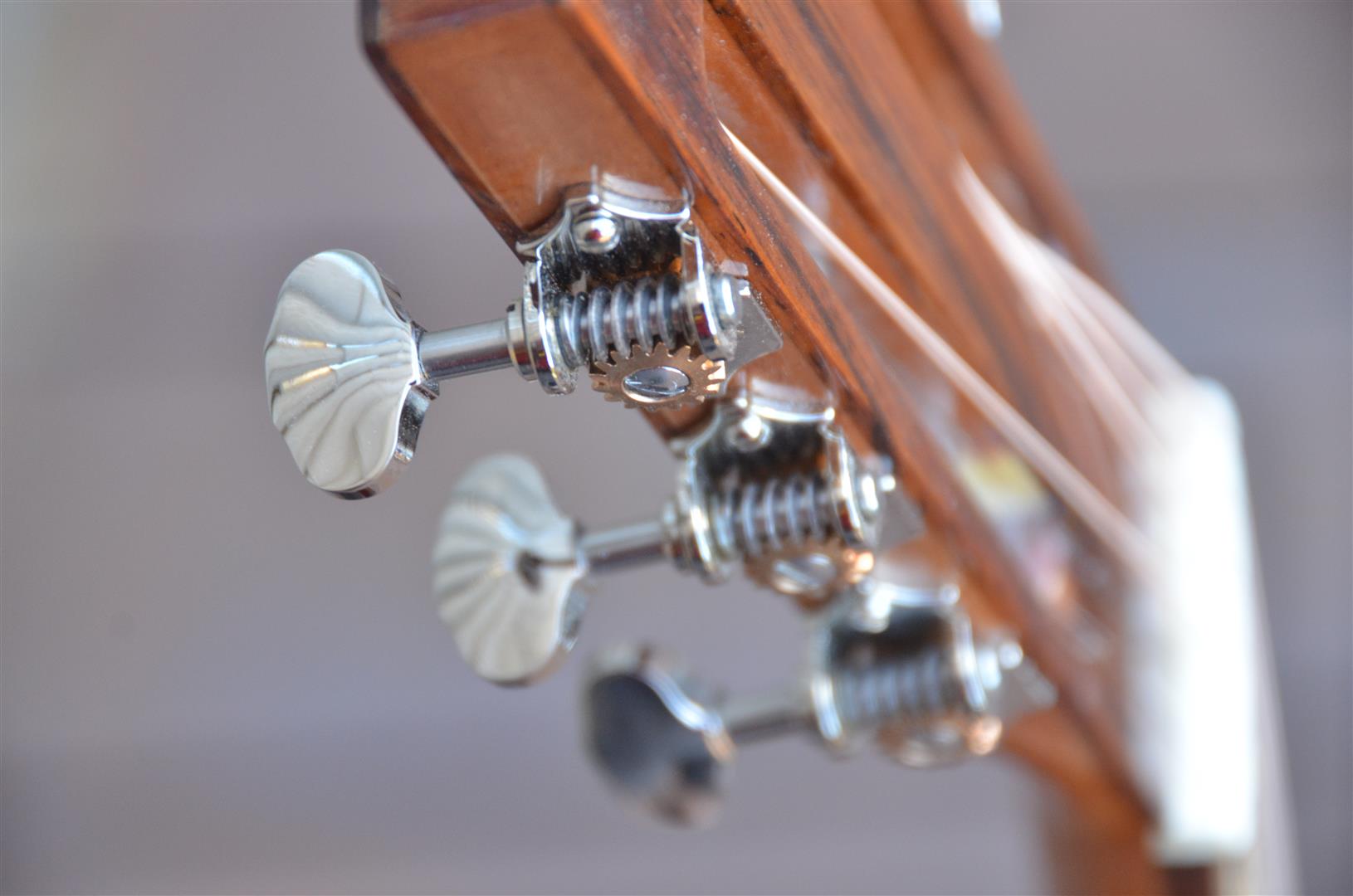

I just love little guitars with slot heads Bob. That ones a real beauty. The buttons on those Waverly's are pretty swish too!

Very nice Bob, coco sure is a beautiful looking timber. Wayne

Allen - those Waverley's are standard butterbeans. They look swish due to the reflections of the bamboo I took the photo against. :lol: I had to look twice at the pics when I first looked at them on the PC.

Lovely work Bob. The cocobolo really does the trick. I like the simple elegance of the bindings being the same as the back/side wood. Sometimes we tend to overcomplicate the colour scheme - this is great. It is a nice touch around the fretboard also. It must be frustrating not being able to play the bugger when it is done!

Very very nice Mr Connor, nice clean simple lines and the slot head just adds a touch more class. The gold EVO frets, were they a customer request or your choice? I find myself leaning more toward the EVO wire these days if I'm left to decide, they just add something a little extra against a dark board and are a little harder than the Silver/Nickel.

That's a class act Bob . Beautiful looking little guitar . With the Cocobolo and Euro spruce I'll bet it sounds like a winner too.. The Coco bound ebony fretboard is certainly a good look !

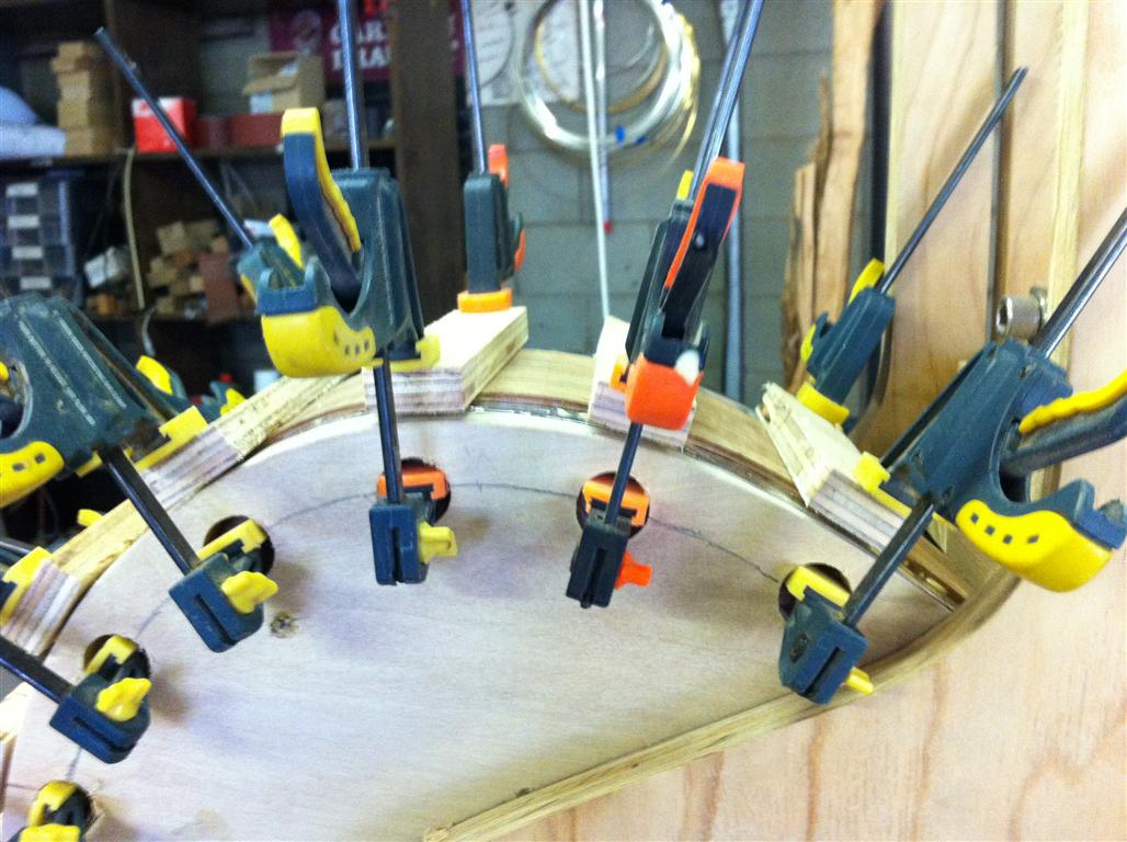

Bob Connor wrote:
Rod - the Coco bent easily. It was only .040" thick. :D I use double sides on anything I build and then glue the two laminates together with Titebond. Makes for incredibly dense, stiff sides that have very little ripple and no springback. I think my instruments sound much better since I started doing it.
G'day again Bob, I'd like to build with the double sides approach. A few questions ;
How do you go about joining them without gaps between the two.?
Does it require a solid mould or can you get away with the type with the bar separators ?
You say your Coco was .040. what wood do you you use for the inner and how thick is it ?
Craig Lawrence
Re: Cocobolo O-18 12 fret
Post by Bob Connor » Thu Feb 07, 2013 8:19 am
I usually use Blackwood as the inner side (just because I have lots of it) and it's around .040".
A solid mould is necessary.
I glue with Titebond and tightly tape the two sides together with blue painters tape every 2 inches before clamping on the solid mould.
I have had the occasional gap but they can be fixed with clamps and a little heat after the sides are removed from the mould. If you do leave gaps you can have problems when you are routing binding channels as the outer side will be susceptible to chipping.
I know some of the US builders use epoxy for glueing the sides but I try and avoid epoxy as much as possible. Besides the joint has so much surface area you could probably glue it with flour and water :lol: Maybe they use epoxy for it's gap filling properties,
The first time I did this procedure I couldn't believe how stiff the side was when I took it out of the mould.
These sides are virtually indestructible (i.e. the won't crack or split) and there is no need for sides re-inforcing tapes/strips.
Here's a pic of a Weiss side being clamped. (That was before I started using the painters tape.)

Another very classy little guitar Bob. The euro looks very clean and the fine grain of well quartered cocobolo is a perfect match. Slothead, Waverlys and the black and red contrasts all bought together with the ebony fretboard...she's a real looker. :cl :cl :cl

Thanks for all that double side info Bob , I'll be giving it a shot. Definatley loads of advantages . Like you ,I also try to avoid using epoxy . Titebond's ability to pull the surfaces together as it dries makes it a good choice for the job. It's quite a big surface , I imagine you brush it on to speed up the glue application ?. Do the sides cupping ( when applying Titebond ) cause an issue ?
Craig Lawrence
liam_fnq
Posts: 590
Post by liam_fnq » Fri Feb 08, 2013 9:06 pm
Bob that is one sharp guitar. Very nice.
I do my ukulele double sides using titebond. The 1mm sides are glued together in an outside form and synched up using the same dressmaker's twill tape I use to synch the bindings.
Post by Bob Connor » Fri Feb 08, 2013 10:09 pm
Craig wrote:Thanks for all that double side info Bob , I'll be giving it a shot. Definatley loads of advantages . Like you ,I also try to avoid using epoxy . Titebond's ability to pull the surfaces together as it dries makes it a good choice for the job. It's quite a big surface , I imagine you brush it on to speed up the glue application ?. Do the sides cupping ( when applying Titebond ) cause an issue ?
There is bugger all cupping with the double side method Craig.
I wear rubber gloves and just smear it on with me fingers.
I draw some witness lines on the sides but a quick sand with 80 grit flattens it out in about 5 minutes.
Regards.
