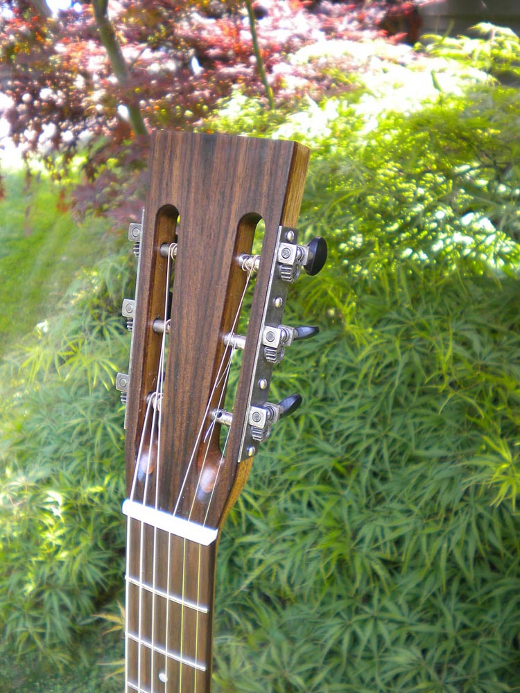

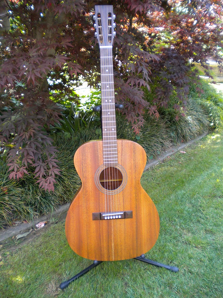

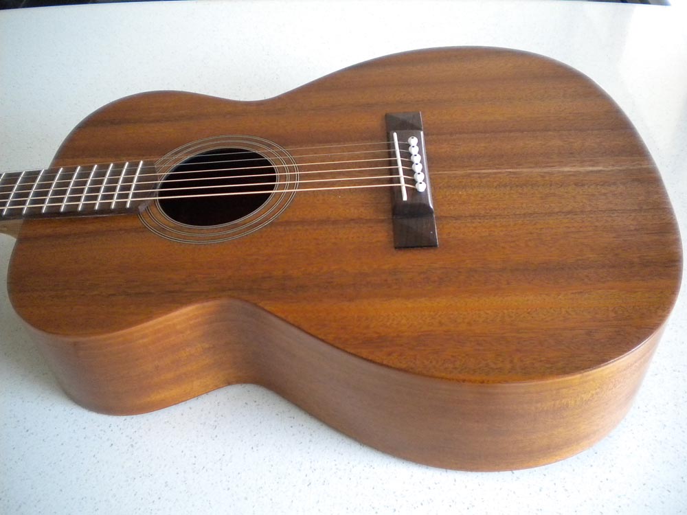

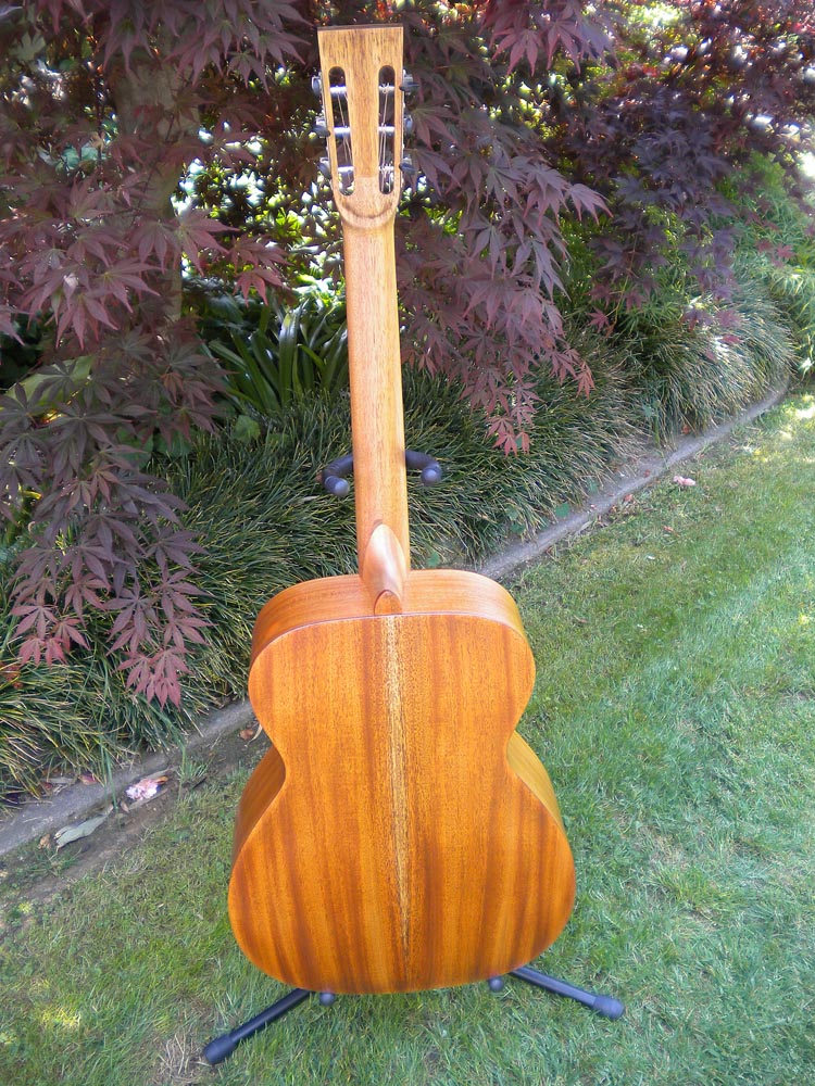

Some pictures of an all mahogany OM that I finished recently.
Plain and unadorned, it looks like a guitar and even sounds like one.
Top back and sides Macassar mahogany bought on eBay.
Neck Qld maple
Finger board EI rosewood
Tuners Golden Age from Stewmac
[/attachment]
Neck Qld maple
[/attachment]

I like that a lot - good job! The 'plain, unadorned' look has always appealed to me.
What was your finish type and procedure?

Beautifully simple and elegant Bruce, love it.
Although I'm a bit sus on the plant in the background of the headstock shot, seeing as it's in Canberra I thought maybe that's what makes the politicians carry on like children during question time

Very cool looking guitar you've made there Bruce. Loads of class & style..

Hi Dave
The finish is Danish oil, several applications worked in with 400 and 600 wet and dry.
Initially I sealed the body/neck with dewaxed blonde shellac then started the oiling using
400 wet and dry to spread the oil. I applied the oil generously and evenly then wiped off
any excess with a clean soft cloth after about 30 mins. Then I left it for a couple of days
until the surface was dry before applying the next coat. I repeated this procedure changing
to 600 wet and dry.
to 600 wet and dry.

Dear Matthew
The vegetation you refer to is a seven lobed dissected leaf variety of Acer palmatum, very common in Canberra.
I have no idea as to what you are alluding to. (TICFIB)
This guitar was partially completed when I attended Trevor's course in June, so I was not able
to apply everything I learnt at the course to this one. I will only say that the resonant frequencies
for T (1,1)1 and T(1,1)2 are well above the suggested ranges and there is no obvious T(1,1)3.
I have fiddled with the bracing and sound hole diameter to move the resonant frequencies away from
note frequencies. I think it worked.
Dear Matthew

Thanks Bruce, I'm glad it has worked out well for you, it certainly looks the goods.
Thanks also for the info on Acer palmatum ( Now that I think about it that might be the politicians problem, they're smoking the wrong plant

Very nice Bruce. I like the all mahogany look. Your headstock looks grand and the workmanship is first class.
Thanks for sharing the pictures.

Nice one Bruce. Very Martinesque.
I bet it sounds killer with 13s and a slide.
