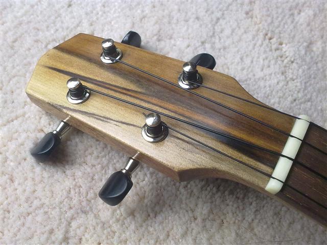

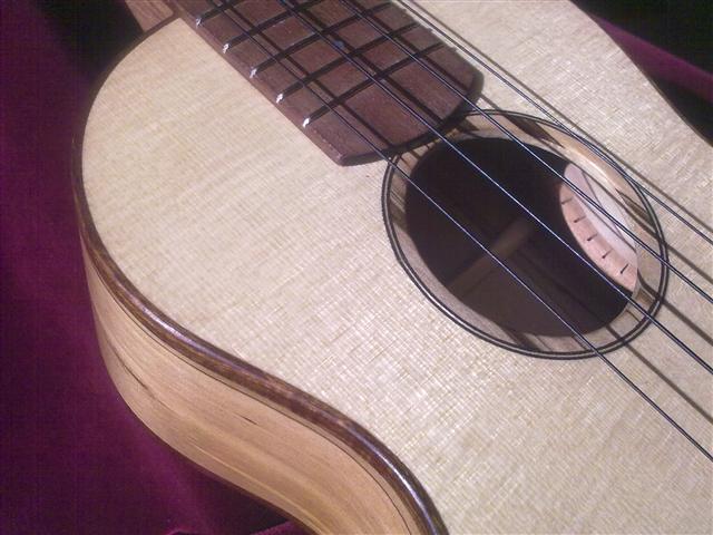

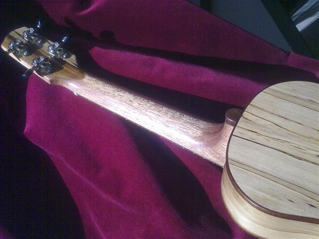

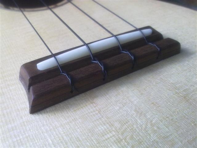

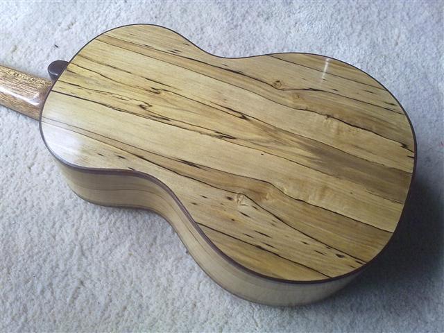

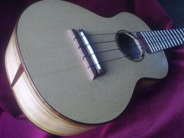

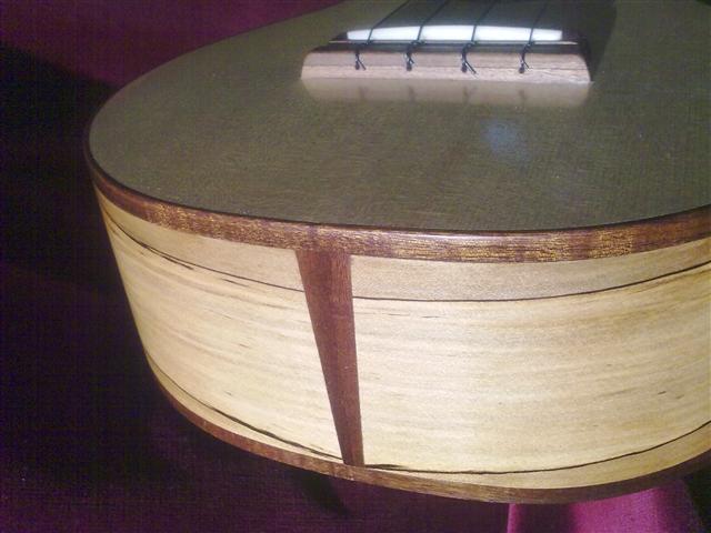

And finally there's these to complete the 'picture' :lol:
Englemann Spruce & Black Hearted Sassafras
Bound in Gidgee
Australian Desert Oak fingerboard
BRW/CF/BRW bridge

Thanks for the pics Craig - I've been waiting to see how it all came together.
Beautiful Sassafras and fine work indeed.
Oh and that bridge did match the fretboard and binding didn't it ? Handy.
Two quick questions -
What finish did you apply and what strings did you try out ?
Congrats. :cl

Thanks guys.
Strings are D'Addario J53's.
Allen put me on to them but I hadn't gotten around to trying them out till now.
Finish is my good old Ubeaut Hard Shellac, applied with my psuedo french polishing method.
I will get around to spraying nitroc again, but it's been a while now & I still had some Hard Shellac in the bottle.

Clancy wrote:Finish is my good old Ubeaut Hard Shellac, applied with my psuedo french polishing method.
It's funny you say that - I'm looking at the opposite at present!
For two reasons; somewhat for toxicity but also due to weather restrictions. :evil:
I get about four months of solid rain or 98% humidity here to go along with -4˚ to 12˚C days and nights. Not conducive conditions to spraying nitro outdoors... I do have a dry room, but not a spray booth. Therefore having a method of finish that did not require waiting for the right weather conditions is a primary concern, given those conditions can literally take 3 months to come about here.
A difficult one to explain to customers. :roll:

Very Similar to where I am instead of 4 months its been like that for the last 3-4 years. Before that it was a drought. I use 100IMS and have no problems at all french polishing when its raining. We have/had a spray booth but my father has become very sensitive to Nitro/thinners based Lacquer over the years and can not be around it or use it. I just do the polishing in the dry room and it is fine.
