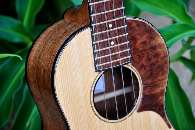

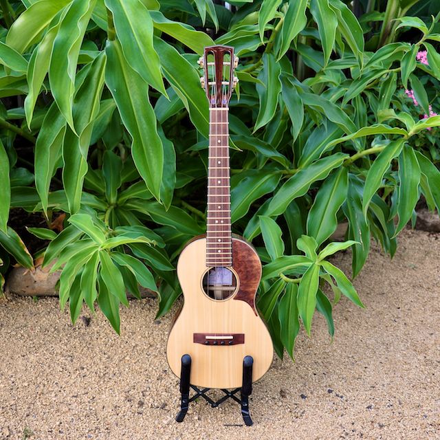

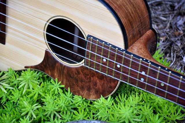

This one has had the a fair bit of bling added to it, along with a new bracing pattern that I'm working on. Honduran Rosewood body, fret board, head plate and bridge. Neck is Qld. Maple. Scratch plate is some burl that I got from Tim Spittle quite some time ago. Top is the off cut from the recent style 5 zircote guitar you can see in the gallery as well.
The top was incredibly stiff and was thinned down to 1.6mm. Uses a CF bridge patch and 5 short fan braces.
Finish is Mirotone 3220 gloss over WEST Systems epoxy.

Very classy Allen - I love the headstock in particular. I am a big fan of slotted headstocks on guitars, and they look just as nice on Ukes.
What was the binding around the headstock done with. It appears to be bent around the corners rather than mitered - is that correct ?

Nice Job Allen, I'm also thinking the slotted headstock gives it a bit of class, looks a little more 'finished' to me as opposed to just posts, for some reason. Is that pickguard a bit of Mr Spittles York Gum burl? I got a few bits of this for headstocks & am quite excited at using it looking at your results!

I'm impressed and feel it is tasteful - not too bling at all. Makes me feel my current latest efforts might be a bit too much :? Obviously that slot head jig you bought has been worth the investment given the recent results. 8)

I love a bound fretboard. great looking instrument
