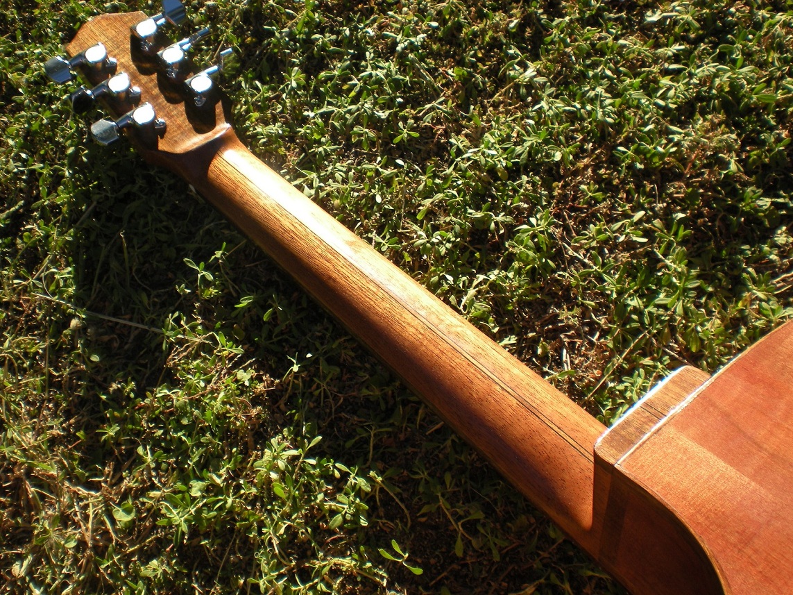

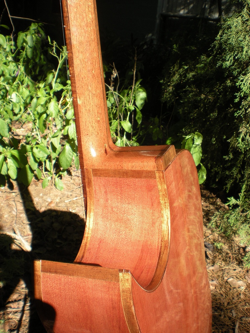

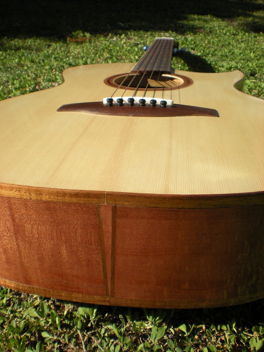

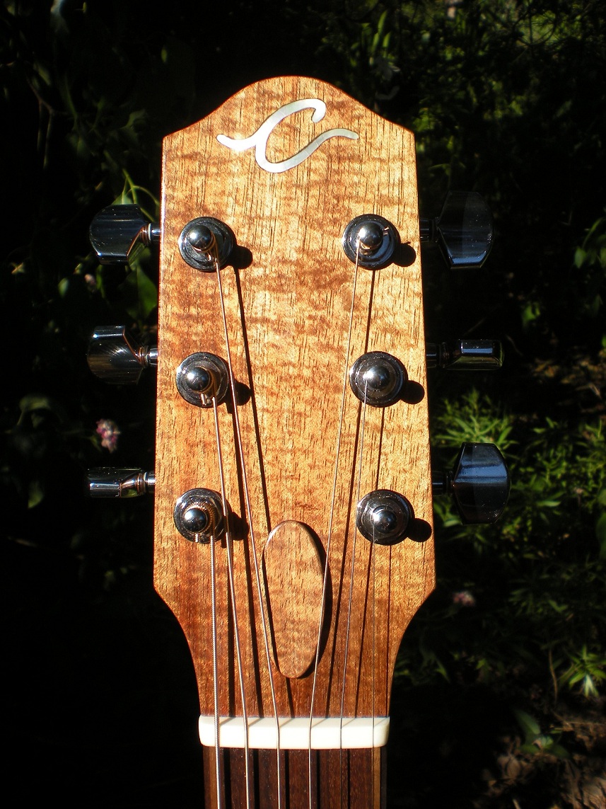

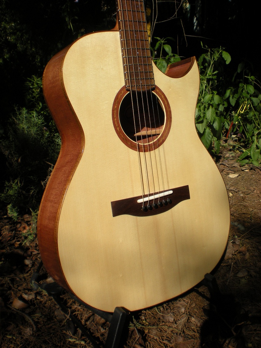

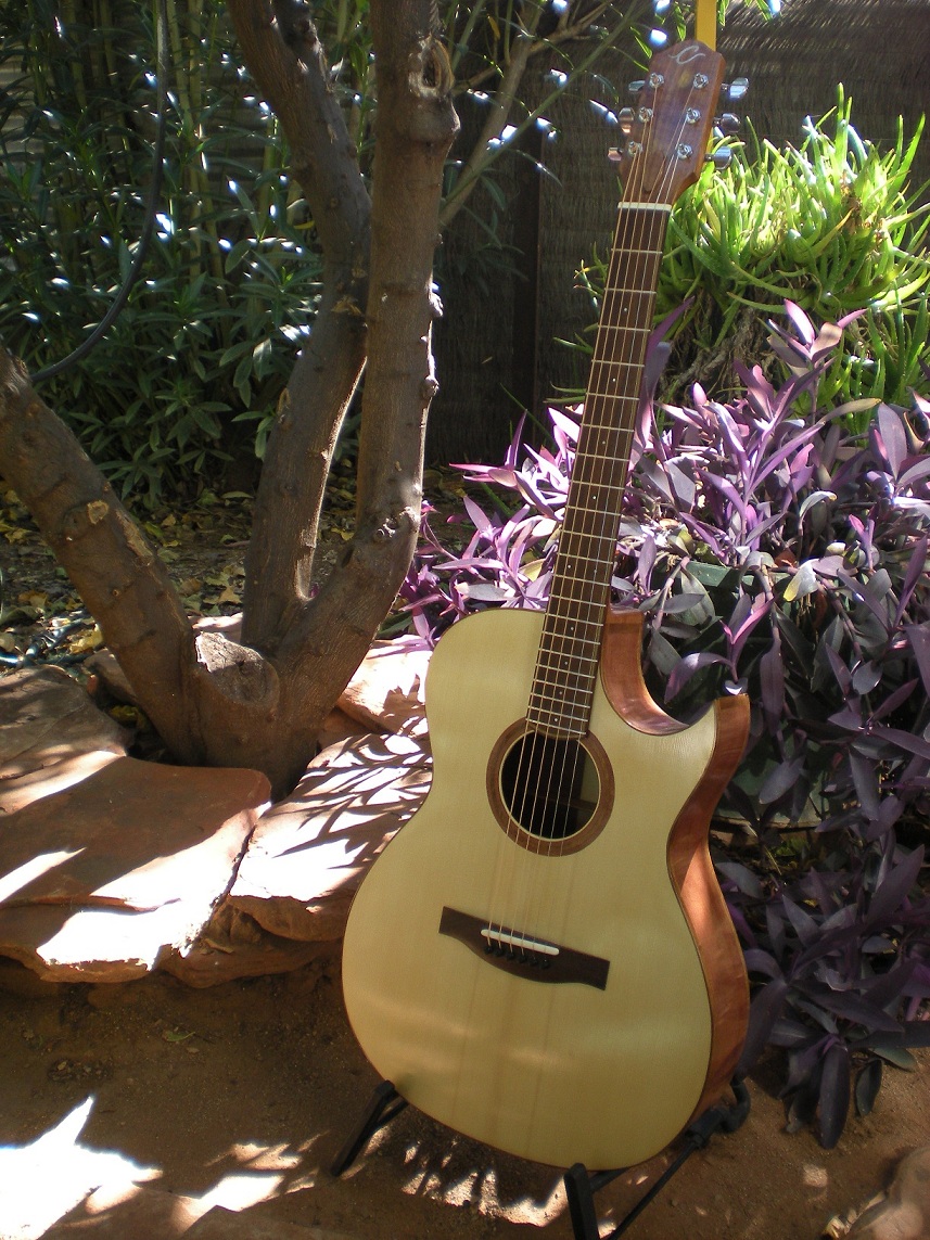

This one started out as a bit of a problem.
The top is a set of Englemann from Graham Hein.
It came as part of a shipment of top grade sets and rung superbly, but had these obvious red 'racing stripes' running through it.
What to do?
Chucked it aside until cleaning up one day and found a piece of Tassie Myrtle sitting on top of it.
Aha!
Added some modest amounts of Tassie Blackwood hoping both the island timbers would create a nice synergy.
(The mytle in the rosette actually really sets off the blackwood in the sandwich!)
Threw on some Gidgee & African Mahogony, don't forget Jim's old ashtray inlay and a bit of elbow grease (Ubueat Hard Shellac)
And so I present the runt of the litter, all grown up and ready to sing.

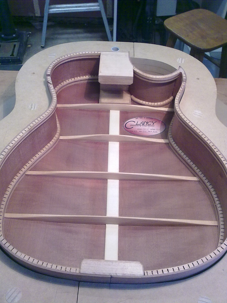

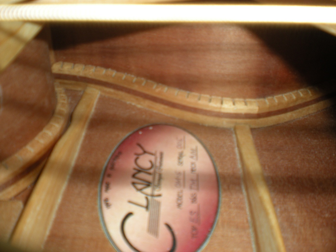

Home made kerfing - haven't vacuumed out the box yet :)

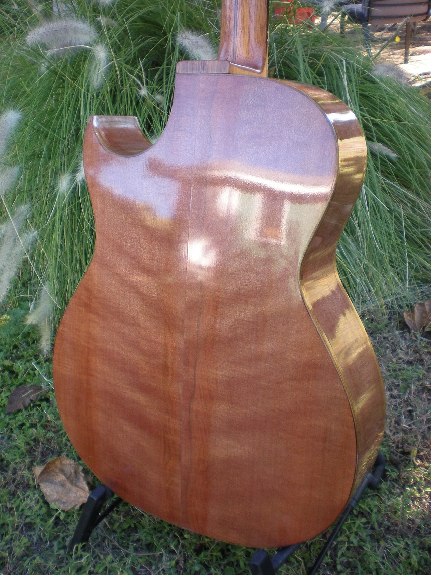

I love racing stripes and wood that looks like wood. The colors go well together.
How did you apply the hard shellac? In image 5 the finish appears to have been sprayed.

Post by charangohabsburg » Thu Apr 14, 2011 6:26 am
Allen wrote:I love racing stripes and wood that looks like wood.
+1 on this statement. :D
There's nothing wrong with racing stripes (but probably with some spoiled guitar players).
And again those understating bindings that pronounce so well the wood of the sides. I really like that detail.

Post by Clancy » Thu Apr 14, 2011 3:02 pm
Allen, the Hard Shellac was put on by french polish method (over epoxy pore fill).
Have a look towards the end of this thread & you'll see some close up pics of the finish I was achieving.
viewtopic.php?f=1&t=3013

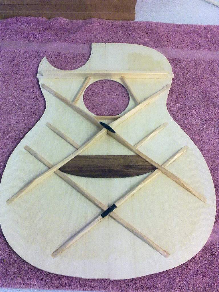

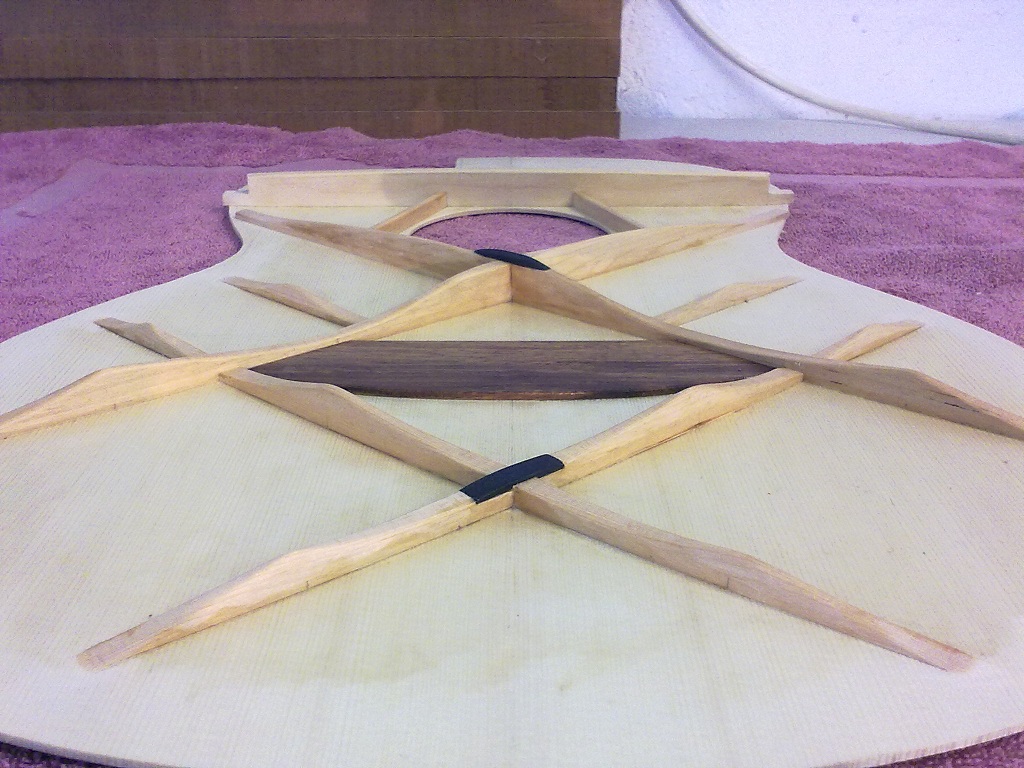

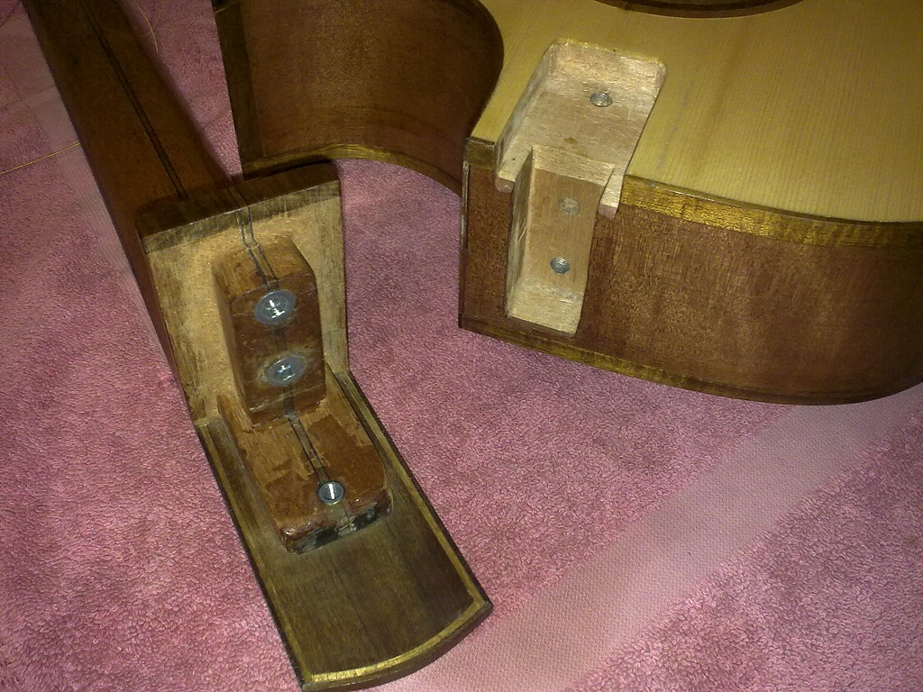

Here's some shots of the internals (btw-same design for the blackwood OM)
