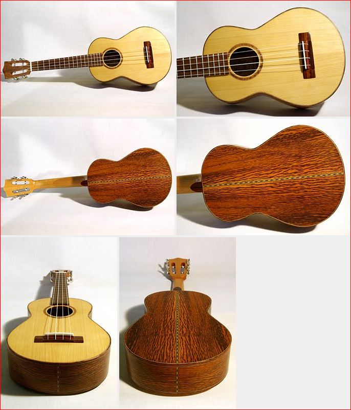

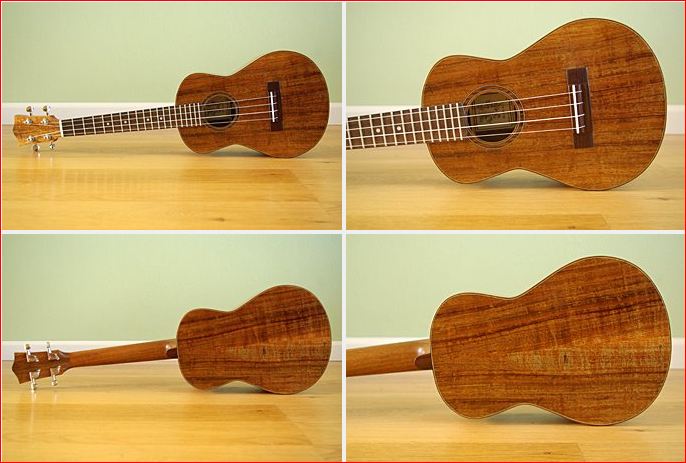

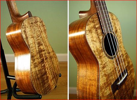

These are some pictures of a couple of Australian tenor ukes I have finished off over the last while. The blackwood one was done quite a while ago, and the tiger one was more recent.
Thanks for your interest,
Matt
Blackwood back, sides, soundboard, neck, binding
Tiger Myrtle rosette
Gidgee fretboard, bridge, heel cap
Tiger Myrtle back, sides, binding, rosette, headstock plate
Bunya soundboard
Qld Maple neck
Mulga fretboard, bridge, heel cap
MAKAIO Ukuleles
http://www.makaioukuleles.blogspot.com

they look absolutely great Matt.
is the design your own? it is very aesthetically appealing.
i like the look of that mulga too, might have to chase some of that myself.
have you got any build pics? what sort of bracing and neck attachment do you use?
Liam.

Very nice as is all your work Matt. I love slot heads, and would like to try one on a uke. What sort of tuners are you using for them?
You've gon away from the Kasha bracing on these I presume? How did you brace these, and what was your impression of the Kasha bracing?

Great work Matt, they a both great looking ukes but I love the way you have used fairly straight laced wood on the sides to highlight the fantastic figure in the top and back of the blackwood jobie, well done! Cool

Liam: The design is based loosely on the plans that Hana Lima Ia sell. The plans are for a fairly basic uke though, and are intended at first time builders. I have started to bring some more complexities into the design (radiused fretboard, domed soundboard, binding, carbon neck rod, slotted headstock etc.) All the build pics are on my website blog (see post footer). I build the ukes with spanish/integral heel style.
Allen: The slot head was a bit of a challenge. I have now modified the design very slightly for a uke that I'll finish over the next month or so. The tuners are Gotoh SEP700, which require a thick headstock (very), however, the slots knock a fair bit of weight out of it. The overall weight balance is not much different to my standard solid headstock. These ukes were both braced (fan bracing) at the same time the last Kasha was, and were done more to look at a few different design options.
In terms of tone clarity, the Kasha is still the best I've done. However, I also think it was built with the best soundboard thickness and bracing stiffness combination. In hindsight I think the other fan braced ukes have been fractionally overbuilt. They still sound great, but as always, there's still improvements to be made.
My wood pile is now full of great Aus tonewood sets waiting to be turned into Kasha ukes (and one with a trial of my own bracing plan).
