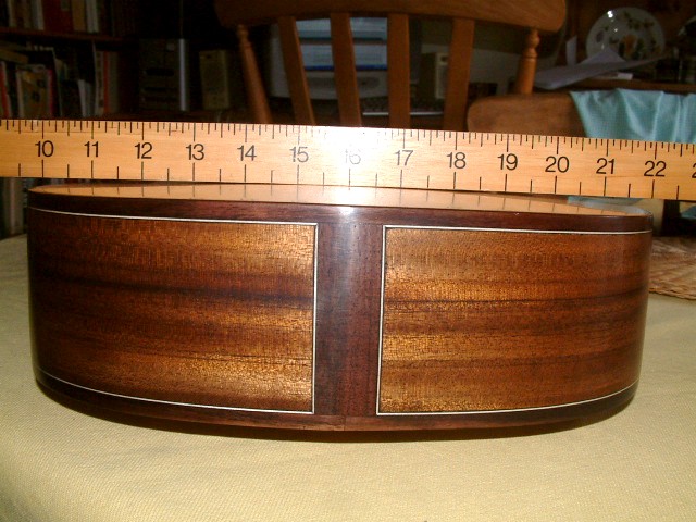

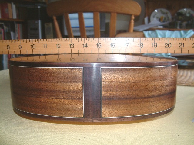

Looking at the top that you have braced, it doesn't appear that there is much of a radius in it. I think that you said that you build with an 8' radius. Is it just the camera angle that makes it look much flatter than it actually is?

Allen - I'm glad you liked "Botany Bay". You can pick my brains any time. The bottom of the braces on the top and back were profiled to a 10' radius. I don't use any radius dishes so don't know what the radius settled out at but you can see the curvature from these photos:
Top:
Back:

Gosh thats nice Dave, I love the sound and your comments about the radius make good sense.
