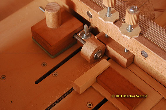

Watching Luca Waldner's method for cutting regular kerfs in the linings was really a revealing moment for me. Just too simple to be true. Though, his apparatus was better designed than mine. Waldner uses a dremel-sized small circular saw which gets swung over the lining, so the remaining web, regardless of the thickness of the lining will be of a constant thickness. O course, this can also be achieved with a smart setup of a backsaw with a depth stop, where the latter does not stop against the lining itself but a miniature mitre box. The advancing system could remain the same. To have the pictures of the advancing gizmo also here in the forum (and not only 5 seconds each in the YouTube video) I'm posting them here once again.
The whole gizmo:
The spring loaded down holding mechanism:
Image Image
In-feeding guide and feeding stop:
Image Image
Manually operated out-feeding guide:
Image Image
Manually operated feeder with asparagus rubber band and feed ratio adjuster:
Image Image
Before feeding:
After feeding:
The last two photos are not well taken because one can see that in this case nothing got fed; I shot them after the whole lining was already kerfed. :roll:

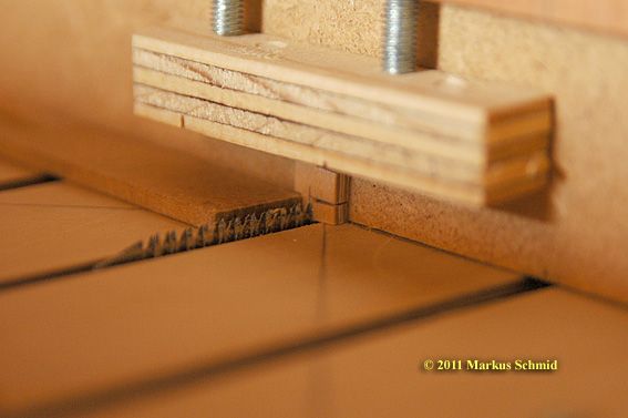

The fence of the Jointapprentice Hobby a1 is another a bit complex bit of wooden machinery. :lol:
Let's start with the sacrificial fence which is a piece of 3 mm MDF or also plywood which gets a new cut each time the fence's position was changed. If one would readjust this zero-clearance slot once the position of the fence was changed, the cut would not be dead vertical anymore . So I designed the sacrificial fence in order to be able to advance it easily 10 or 15 millimetres each time I need a new kerf in it. I hope the pictures will speak for themselves so I can get a cold one while you are watching the pics. :gui
Image Image
Image Image

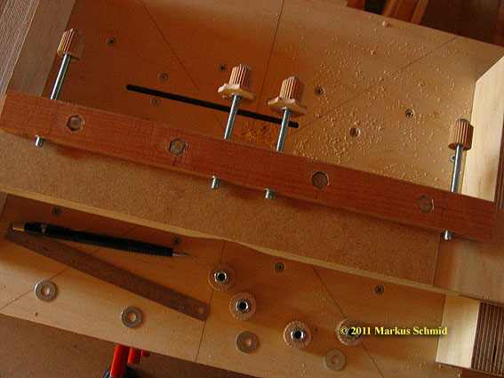

The fence gets clamped to the saw's table with the ASCS (Advanced Spool Clamp System). Ordinary spool clamps will only clamp fine when tightening them nearly to death (I have tried it):
Image Image
Image Image
The finished fence, front side:
The finished fence, back side:
