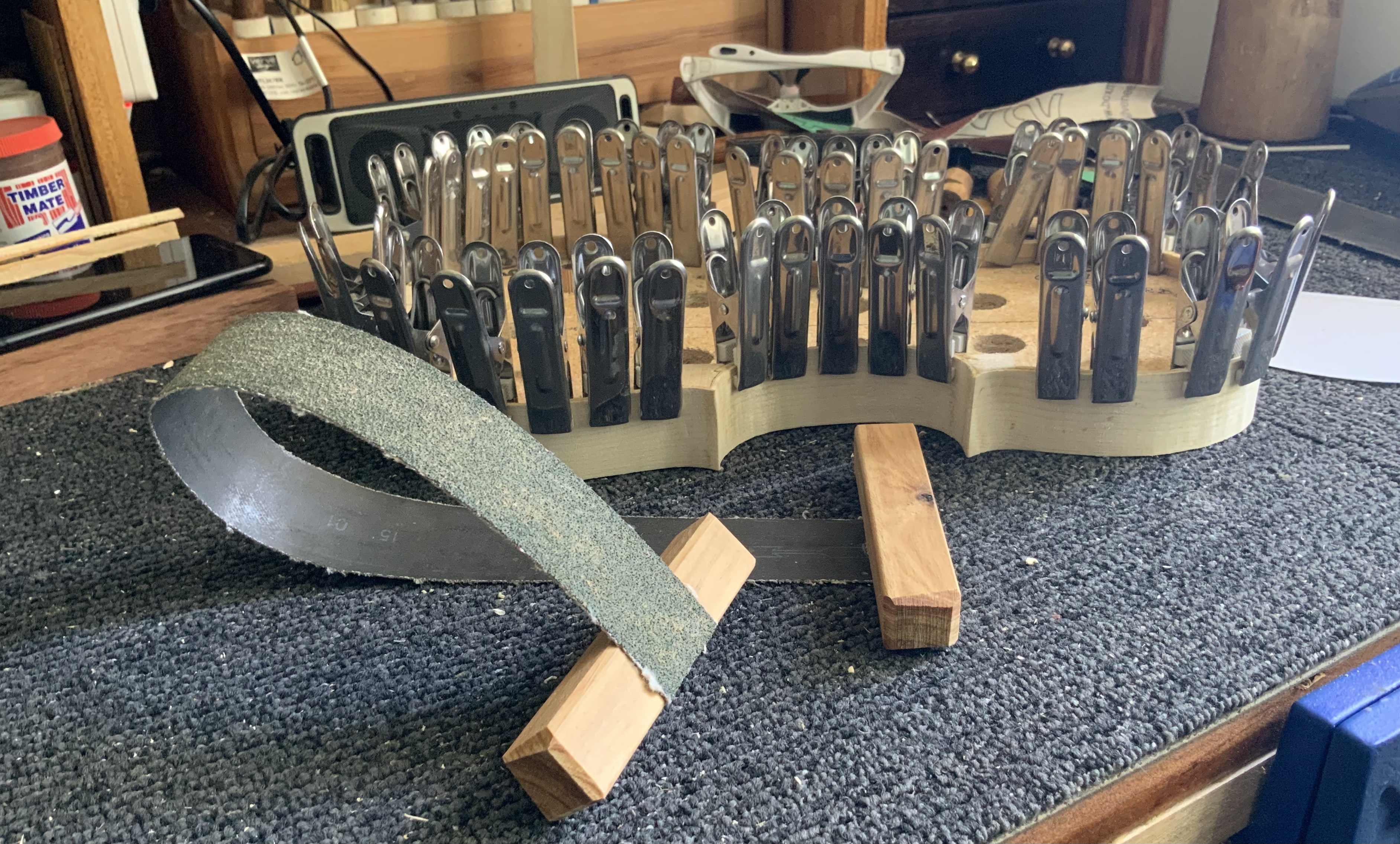

Post by sebastiaan56 » Sat Oct 23, 2021 10:48 am
This is a “doh..” moment. Bending strap made from an old belt grinder belt. I’m more into fiddles nowadays and some of the corners can be tight, particularly with highly figured wood. Not an original idea I found it on Maestronet but still…. doh…

Post by Dave M » Sun Oct 24, 2021 3:14 am
Now that I like. Dave

Post by Mark McLean » Wed Jun 22, 2022 9:56 pm
Doh indeed!. Looks like a good idea. I will definitely give that a try

Re: Bending Strap
Post by asgilbert » Thu Jun 23, 2022 2:58 pm
Now that is a good use of waste :cl
