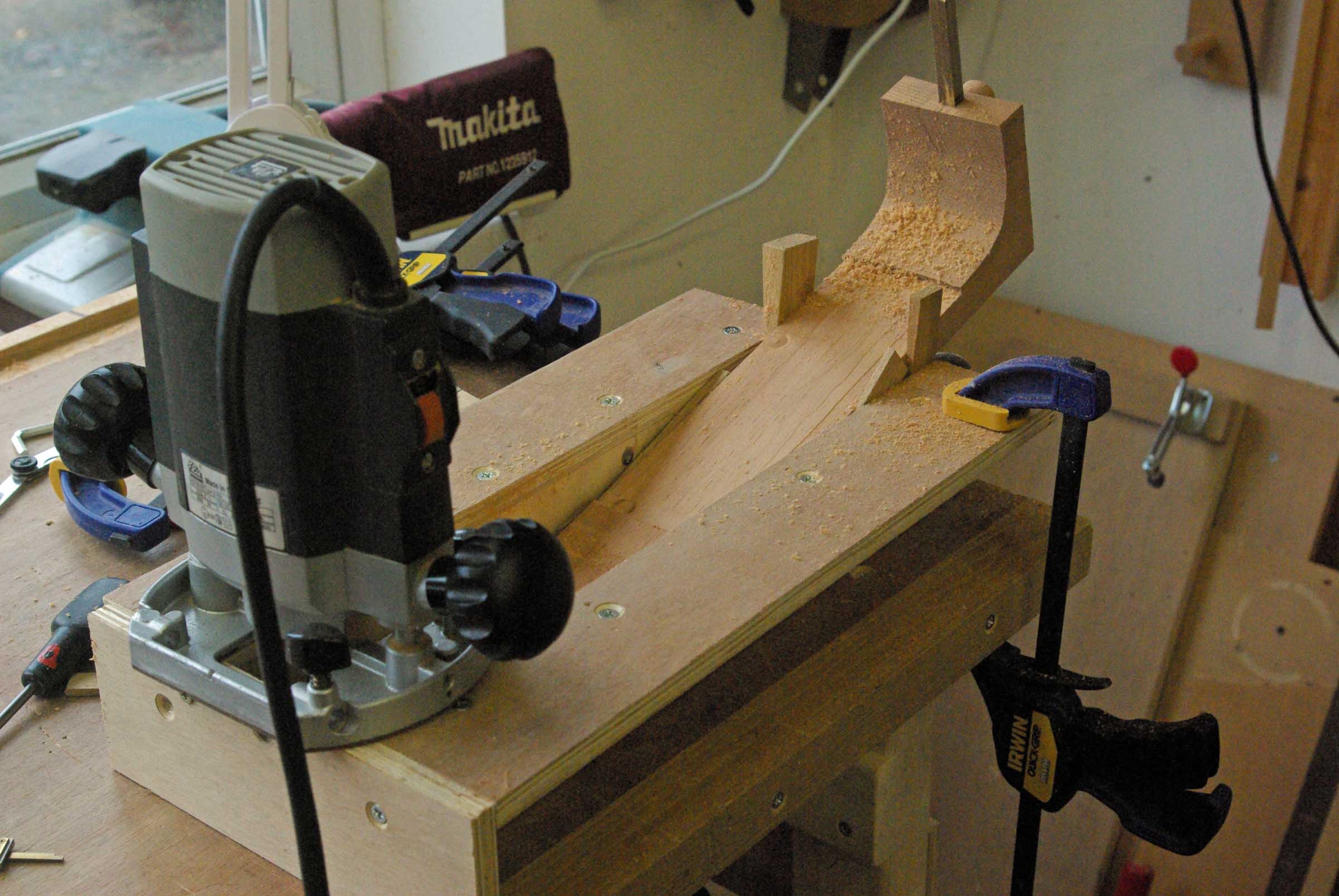

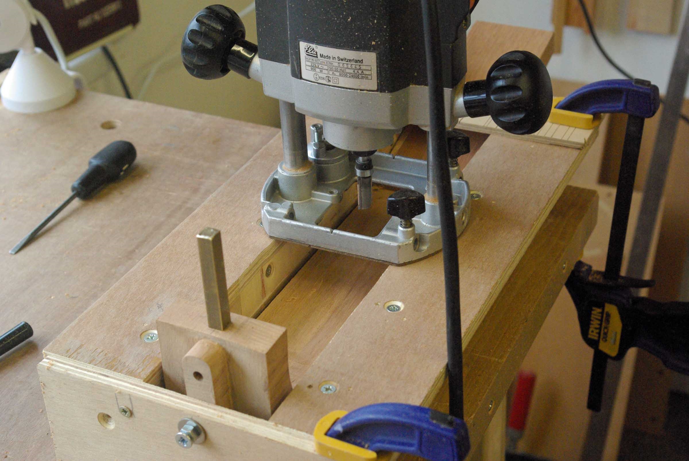

For those without access to a safety planer this will allow a router to be used.
The neck is raised the amount you want to taper at the head end, secured with a bolt at the tenon plus wedges at the head end as it is deliberately wider than the width of the neck which will vary.
You can't get to the 10 th fret (or12) because the heel is in the way but it is still useful.
You can do the headstock as well. This is not tapered and is supported under the neck by a big wedge then wedged very firmly into the jig. Not ideal since things could slip but it has worked OK for 3 or 4 necks so far.

Nice, but give me a handplane and spokeshave anyday.
Quicker, quieter, less messy, more fun :p .

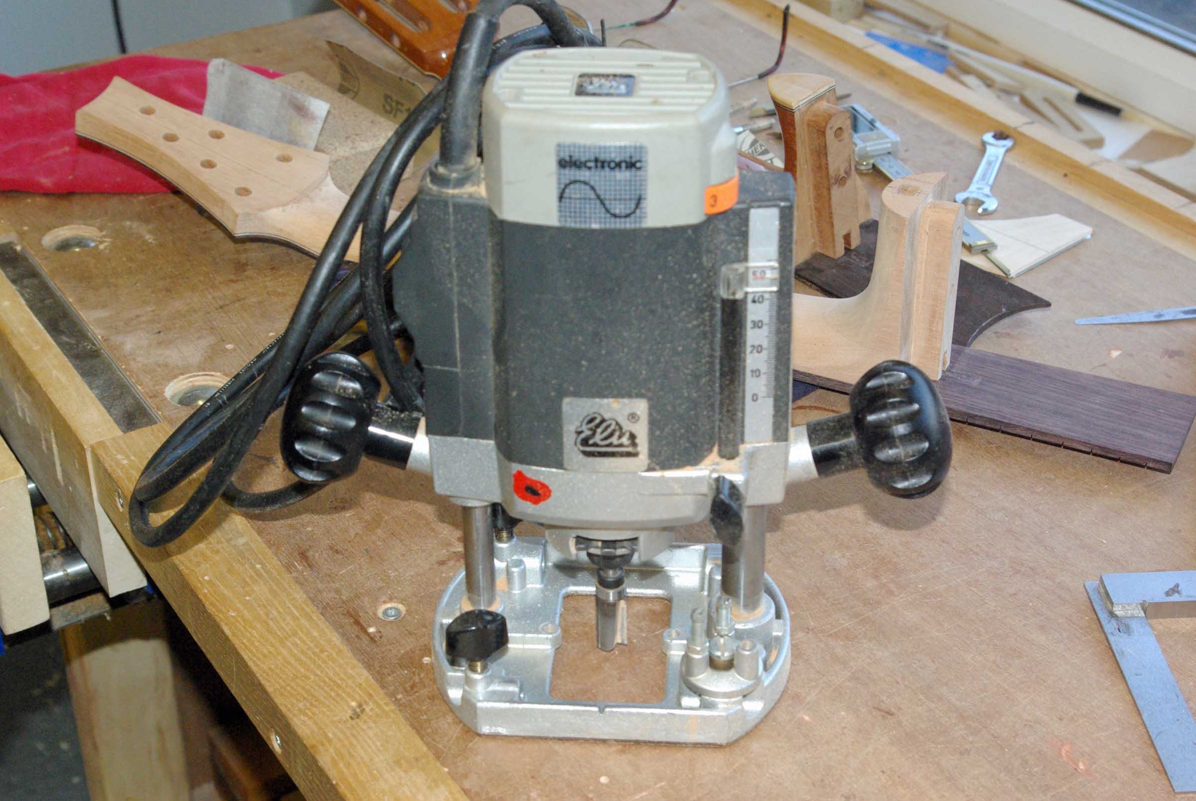

LOL.....youve got a Trend T5 router..same as my main workhorse machine.

Actually Martin it is a really old Elu which I think was one of the earliest design of routers. It is still going because for years it sat in a cupboard while I was too busy commuting and working to get into the workshop!

Dave M wrote:Actually Martin it is a really old Elu which I think was one of the earliest design of routers. It is still going because for years it sat in a cupboard while I was too busy commuting and working to get into the workshop!
And yes I have almost finished shaping that neck. I have been running pretty much in parallel with your build on a Gore Falcate SS. Just a bit more shaping and the end cap and I'll be spraying.
Interesting router....the base plate and general design are very similar to the Trend T5.

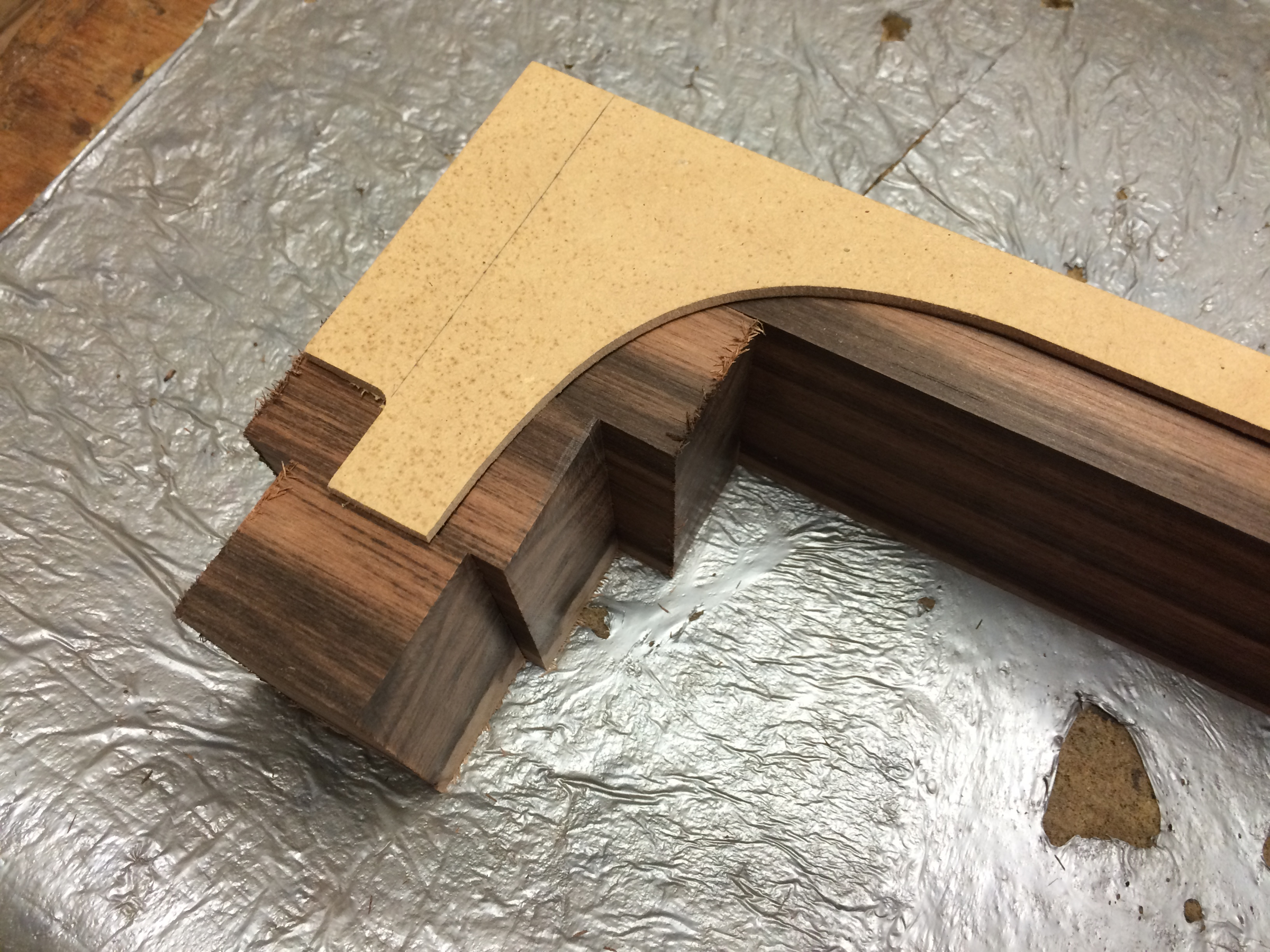

I just run it through the bandsaw. Quick and easy.
Home made template to get a line, cut outside the line and then rasp back to it before shaping the profile.
