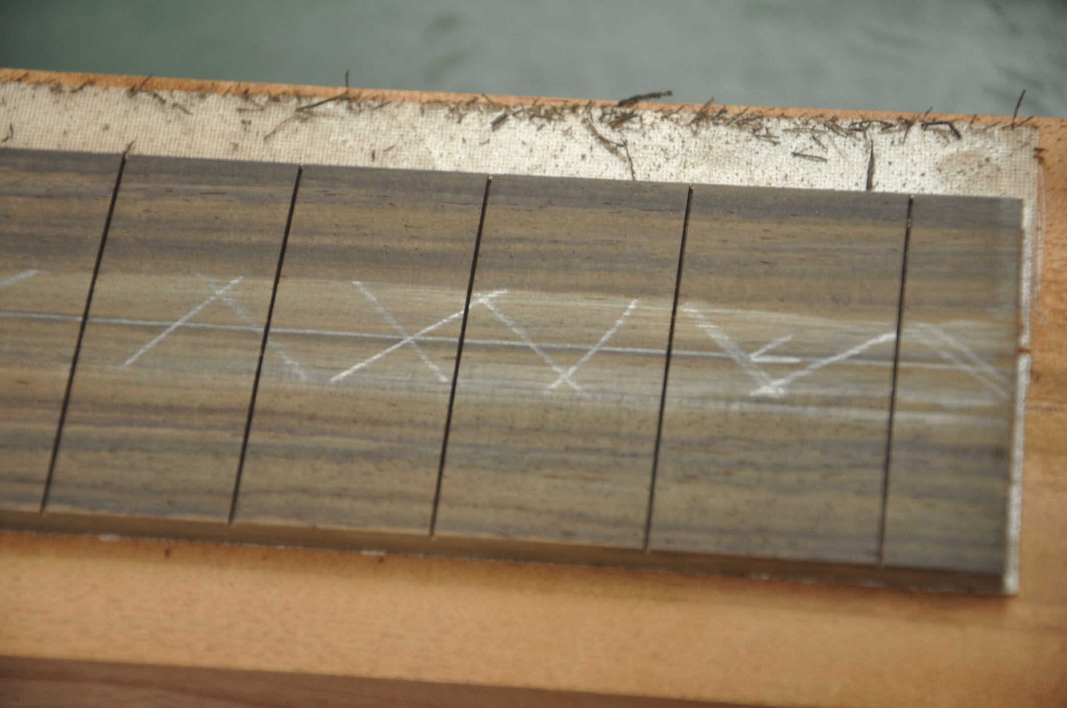

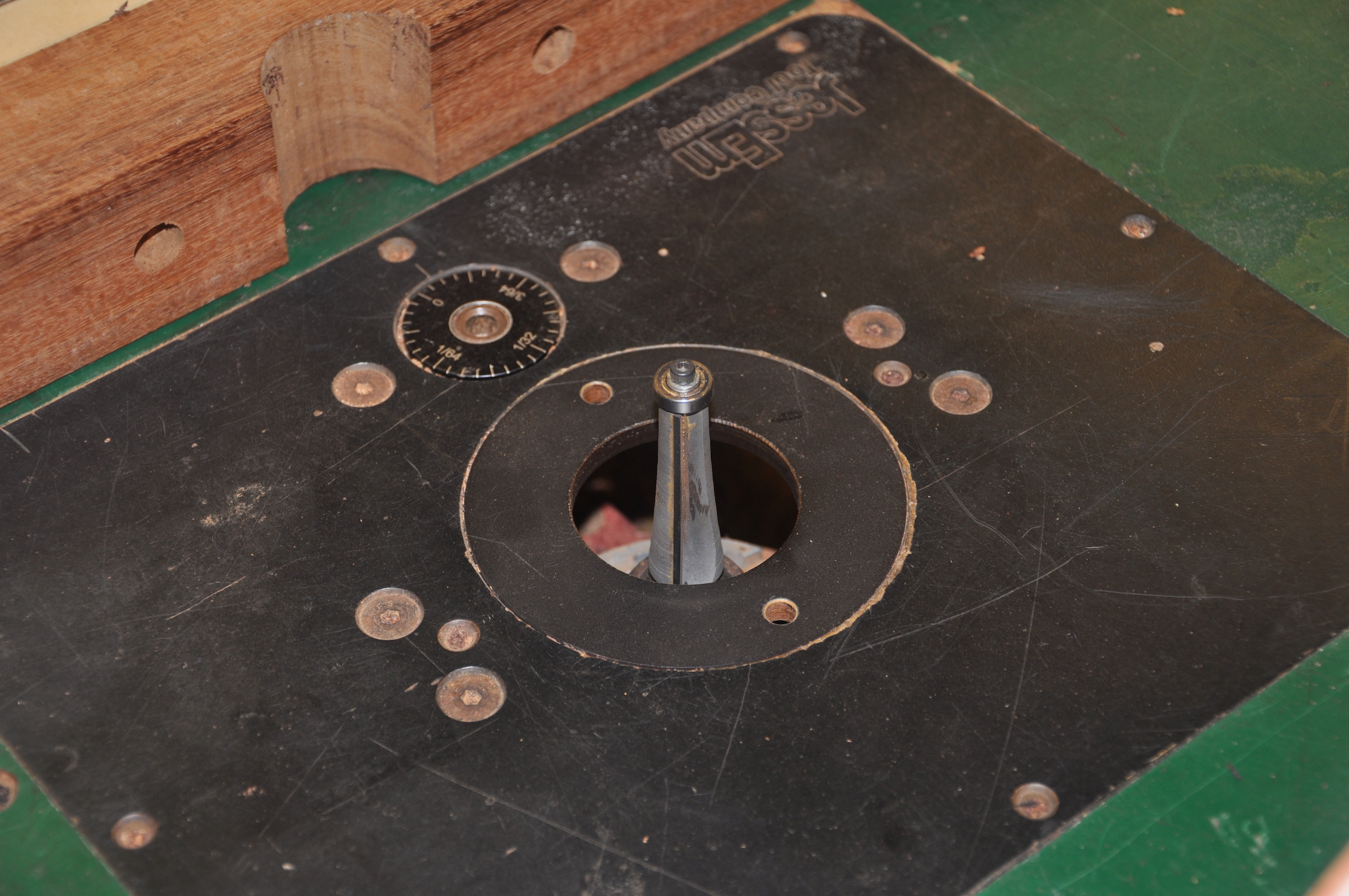

I ordered 1 of the 16" radius bits from Steve Evans (No relation to Steve Evans from Beltona Instruments whom Anne and I stayed with when he lived in NZ). I have no problem with what I thought to be a reasonable announcement of the tool on this forum, as well as a generous offer of bits to try. As a working craftsman, I appreciate people who develop new useful tools. I don't want to have to accidentally find out about new things by searching the internet. A luthier forum is a perfect place to hear about new lutherie tools.
I ordered and paid for a 16" bit. I've had it awhile and finally came fretboard making time. I'm in a bit of a different position than most because I sell fretboards from ebony, rosewood, etc. in slotted and unslotted form. For that reason I have lots of various defective boards to play with. I strongly advise that you DO NOT try this bit out on your favorite new fretboard. There is a big learning curve, as far as I can see. After about 3 hours and 7 fretboards, I think I'm close to finding a way for me to use the bit. I strongly believe in the concept of this bit, so I won't give up easily. One thing I know, results are very dependent on your machines, especially squareness of fences, routers, etc.
The test samples I did were all slotted fretboards. In discussions with other builders, the consensus was that the fret slots might chip out. That did not happen for me. I did ebony, keawe (local very chippy wood), and Indian rosewood. Tried the bit just upright in a router table using the bearing, and with the bearing less setup shown in Steve's video. I was unhappy with the results from the router table alone and expected better results from the fence set up. Wrong again! I could not get the fence system to work at all. After playing around with the router and bearing set up, results improved to the point where there was just a small flat left at the center of the fretboard, which cleaned up in seconds on the edge sander.
So, my conclusions are that I like and will use the bit. Still more to learn though. I would like to see the end of the bit be milled closer to the size of the bearing. I think the bit would work slightly better. Could be wrong about that too! I think it may be almost as fast to do the radius by hand, if you take into account set-up time,, but I also think the final results with the bit are better, and most certainly physically easier. Enjoy your building Bob Gleason http://www.pegasusguitars.com

Bob..thanks for the review of the product.
