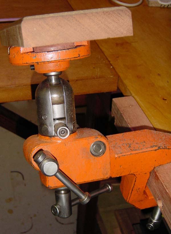

A number of years back I managed to pick up what I think may be a Sthil made chainsaw service vice from ebay for a song. As you can see from the following images that were taken back in 2006, I fitted a quick and dirty narrow cork faced clamping block to it which I use to clamp the FB surface of the neck to for carving, or sometimes repair work. I'm sure I could come up with something better as a clamping platen however the manoeuvrability of the vice makes the job easy enough how things are so its difficult to find the motivation to change.
If you see one of these things for sale my advise is to 'ad-vice' to your kit. They are a superbly built tool and the only way I can imagine you could damage one would be to melt the bloody thing. 8)
