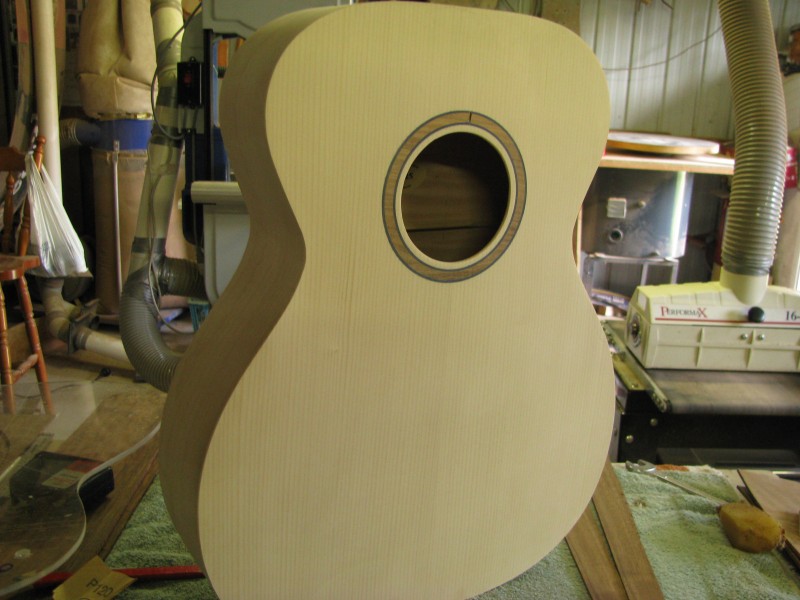

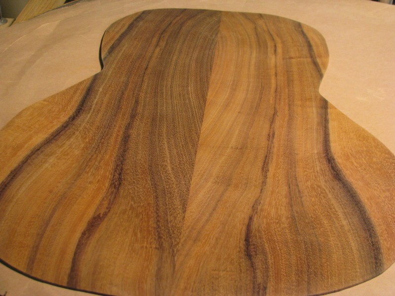

What are blokes and ladies up to at the moment?

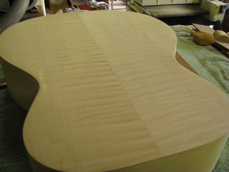

I got the top glued on this OM. (and I'm not saying how 'cause you blokes'll just start argueing)It's Red Spruce on Maple and will end up having Snakewood just about everywhere else.
Not so sure how the Snakewood is going to look. I'm building this for the bass player in our band, Rick, and he's dead set on the snake look.

Have you used maple before Bob?

Dominic wrote:Have you used maple before Bob?
I've done a couple out of Maple Dom.

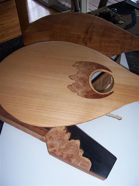

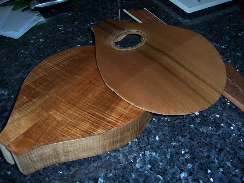

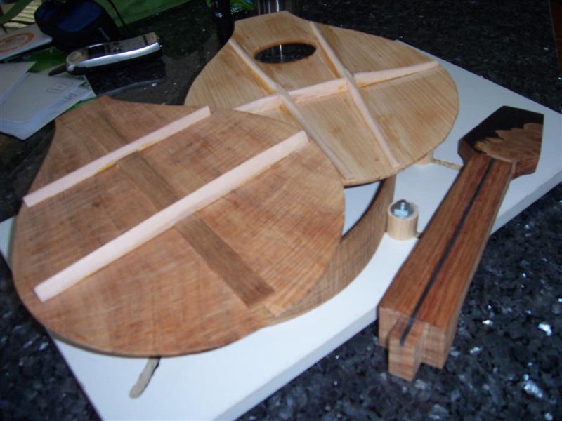

Ive been making Mandolins based on Graham's mandolin Project book. Flat top, Celery Pine top, Tassie Blackwood side and back, NGR neck, Cooktown ironwood fretboard,

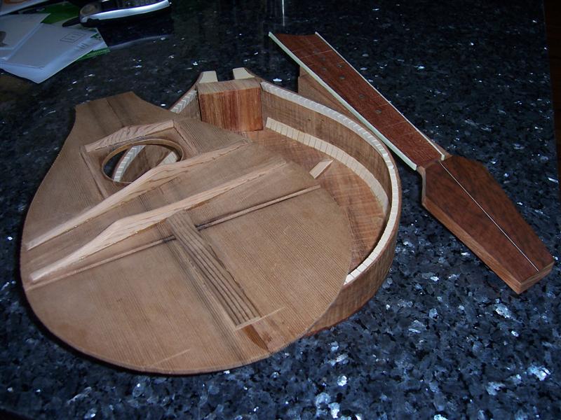

and a bent top, WRC top and the other timbers as above,

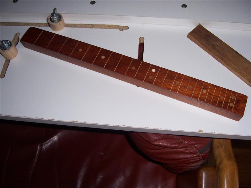

Im binding the fretboards so here is a fretboard binding hold it still thingy and a stand for frets when they have been cut and shaped,

Bloody lovely headstock there Sebastian. Is that a piece of the same burl that you are using as a rosette? It's going to look super under finish.

Bob, my terse question was designed (poorly obviously) to draw you out on your experiences using maple. Any insights? Promise I won't mention glue.
Post by Bob Connor » Mon Oct 13, 2008 6:47 pm
The master of the short retort Dom.
The previous two were with Hard Rock Maple Dominic. One was an OM with an Engelmann top to tone down the Maple a bit. (which seemd to work because it's not an especially bright instrument)
The second was an O-18 with a Sitka top that is complete, but I haven't fitted the neck to it yet so I'm not sure how it'll sound.
This one's Big Leaf Maple so it'll be interesting to compare when finished.
I got some Hard Rock Maple from Steve Roberson for a Mando back and sides. He was telling me this is what Lloyd Loar used in those mandos he built in the 1920's. I'm looking forward to trying that as well.

Its a Brown Mallee burl Allen, both pieces from the same slice. I bought it with several uses in mind and this was one of them and when i saw yours.... My inlay work needs sharpening up but the overall effect is there. With a black bridge and binding i think it will be naff.
i think there is a whole style to be had there, not asymmetrical, interesting bits of timber, slices of twigs for fretboard dots, etc.
I agree about the Snakewood Bob, I would have thought a simple w/b would have been sexy

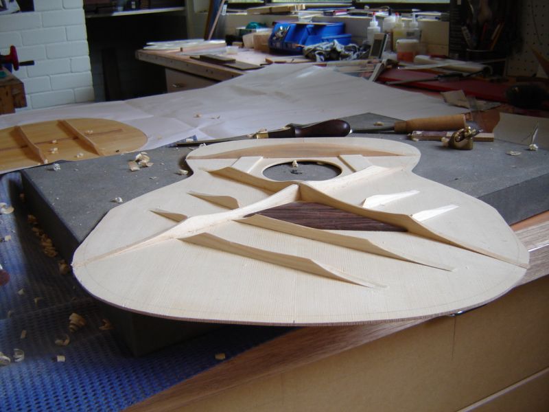

Just starting to glue up the body for my mates OM style guitar this weekend.
Here are a couple of pics.
Heres the top bracing. I have only used tapered braces on previous guitars but after talking with Graham Mc I decided to scollop these ones to see the difference. Happy for comments.
The Huon pine top is in the background.

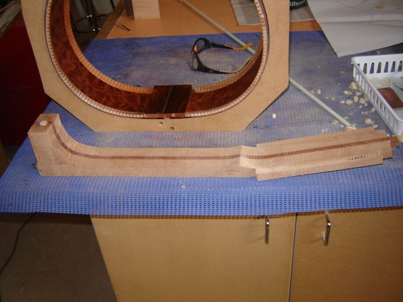

Here is the trippy neck wood (curly marri and jarrah) on the roughed out neck. Behind is the body with Sapele veneer inside the native pear body. I put a coat of shellac on it to pop the amazing figure.

Looking good there Dom.
I notice youre using that blue coloured non slip matting. I was just reading a post over on the OLF where someone had problems with silicon based mold release agent left on some of these matts causing problems with finishing. Lillian I think put up the post.

Hey Martin, I am generally the biggest cause of problems with finishing. Anything silicon release agent can do to wreak a finish, I can do way way better. :? :lol:
Thanks for the tip though. I have had this blue stuff for a while and did not notice any problems when it was new. It is usually under jigs to stop things sliding around my bench. I use a thick bit of stiff foam to do work on the braces.
I also give it a wash with a bit of detergent every now and again to get all the dust out and get hard glue off. Maybe it was there before. I will have to be careful.

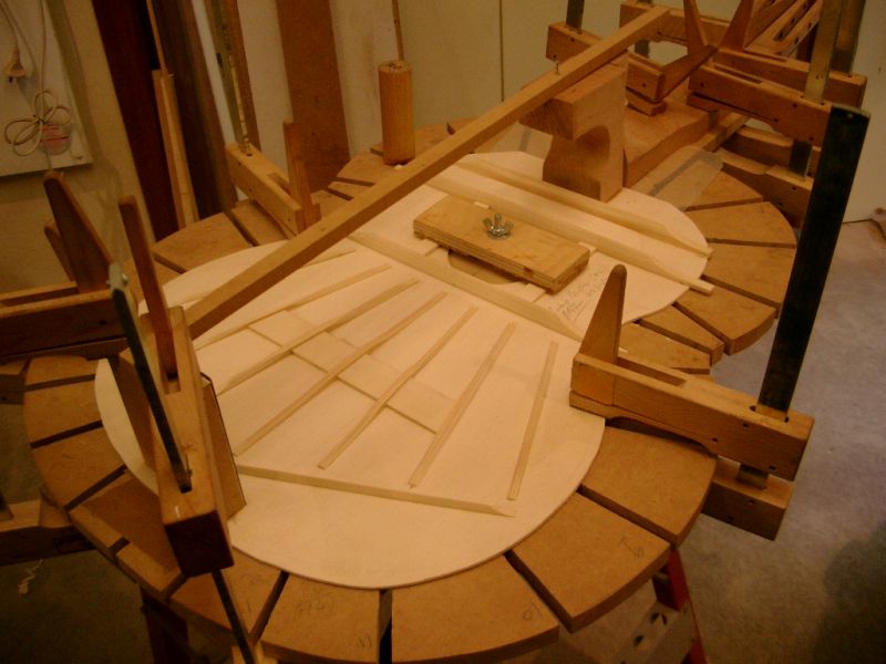

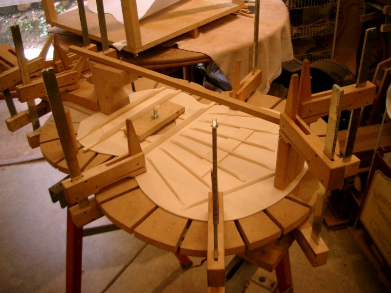

Post by kiwigeo » Mon Oct 27, 2008 5:24 pm

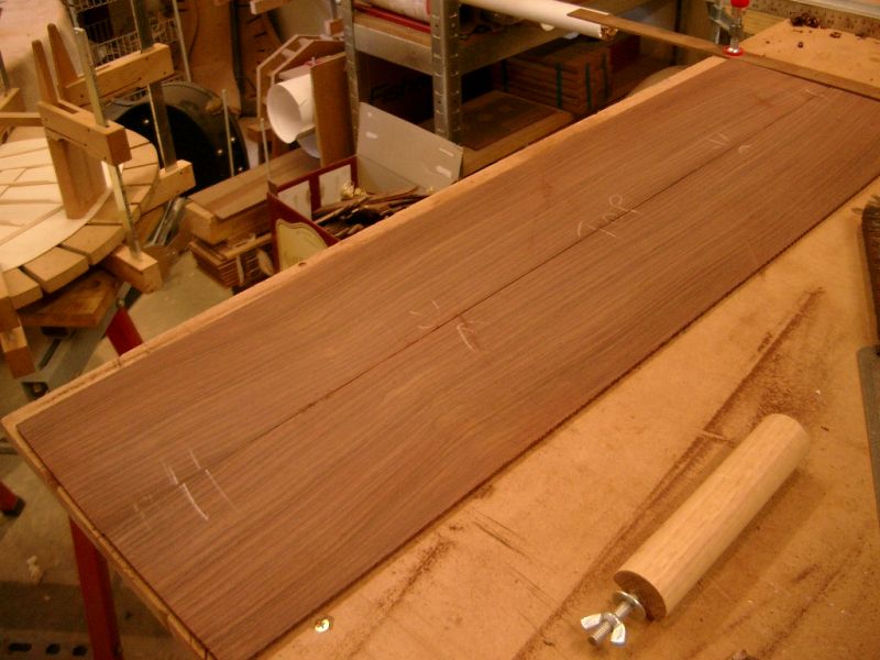

Progress pics of the latest build...a vanilla flavoured Torres based classical. Going to a friend over in Sydney. Top is Englmann Spruce from Graham Hein...its as stiff as. Sides and back are opp grade IRW from allied and neck is Spanish Cypress which came from Gilet Guitars. Bracing is Englemann from Graham.
Top and neck glued up and butt block in place. The butt block is an offcut from a stuffed up headstock so its got a nice veneer on the inside...that nobody but a termite will ever get to see.
Opp grade IRW sides from Allied. A nice set with some nice figure that will go in the lower bout area.

Really great work everyone and Dom that top looks superbly crafted - very nice work! :cl :cl :cl :cl :cl

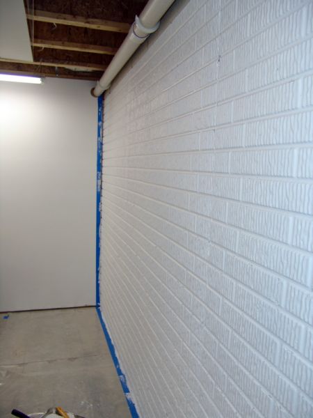

I have been &*^%$%^& painting....... :roll: and hate it...... But I am nearly done with the whole place primed and painted now except for one remaining door that needs the finish coat of paint.......
I painted my brick wall yesterday and it came out a bit whiter than I wanted....

Didnt they have any purple paint at the hardware store?
