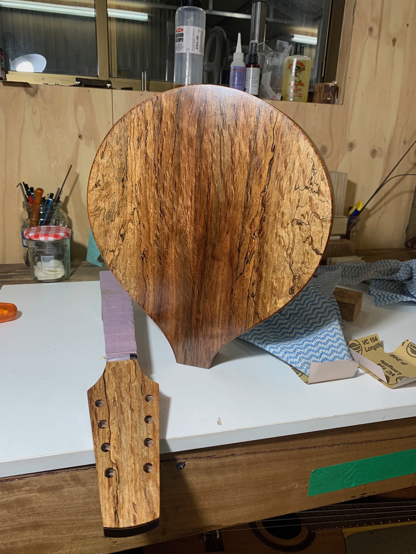

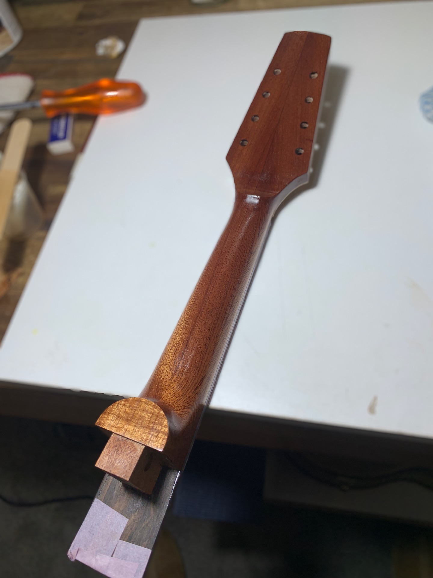

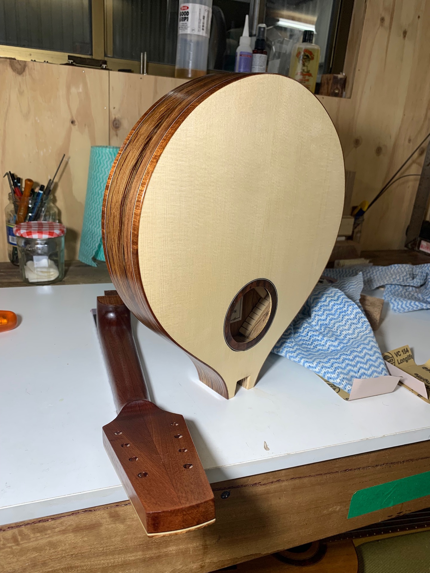

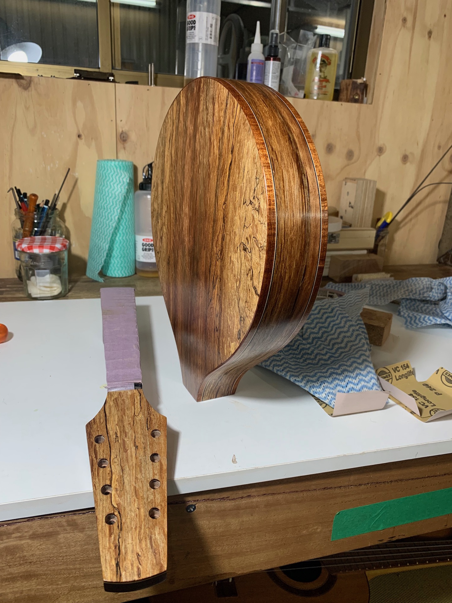

I have applied 3011 Polyx Oil Gloss to my current mandolin build. I have kept it very simple, inline with the official advice on general application:
1. Prepare surface, filling gaps etc. as usual. Sand through to 400 grit.
2. Thorough clean, dampen to raise the grain, sand at 400 grit.
3. No pore filling or sealing. Shellac had been used to seal binding channels etc during the build but this was largely removed during sanding.
4. Apply with a lint free cloth, rubbing firmly to achieve an even coverage and then thoroughly wipe off excess. Leave to dry (18- 24 hours).
5. Lightly sand with 400 if required. Repeat as desired.
I have applied three coats so far, and I am pretty happy with the finish - a very warm, subtle finish. It feels very nice to handle. I may apply another coat or two to see if it adds anything.

Bob's result looks pretty good!
I have also used Osmo hard wax oils on a couple of instruments. Method was much the same as Bob. Initial sanding through the grits to 400. I was using it on Blackwood and I did not pore-fill. I applied by hand with a pad (I use Swisspers brand makeup removal pads that you can buy in the supermarket) and then wipe off with a cotton cloth. Very simple. I applied three coats with about 24 hours between them. You are not trying to build coats - just looking for a nice lustre and a protective coating. It is different from Tru Oil where people often build up to 20+ coats for a gloss finish. The result with 3-4 coats of hard wax oil is a hard wearing satin finish with a natural timber look. If you want a smooth pane-of-glass lacquer type of finish this is not the right product - but I really like this style of finishing. Another great thing about it is that it is completely repairable. You can sand part of it back to bare wood and then reapply a new oil finish and it will blend right in. You can also apply it over shellac or over stains such as a hand-rubbed burst.
