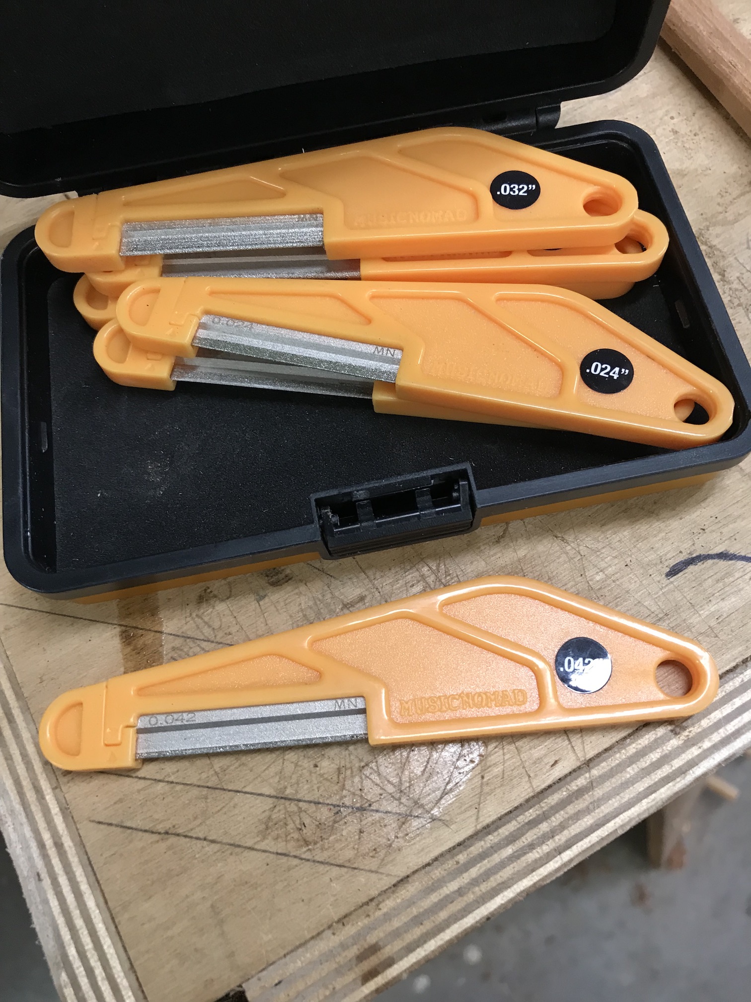

Anyone bought the pricey Music Nomad diamond nut slot files with the plastic handles? I have a dozen or so totally worn out nut files and it is time to bite the bullet and get new ones. I have tried every type of file that the lutherie suppliers sell. They all work, but I really don't think any of them are exceptional. Except for one type of flat gauged file that Stew-Mac sells, which I have, all files are about the same. Just wondering if the diamond ones are actually good. All files are pricey, so it only matters if they work. Thanks, Bob

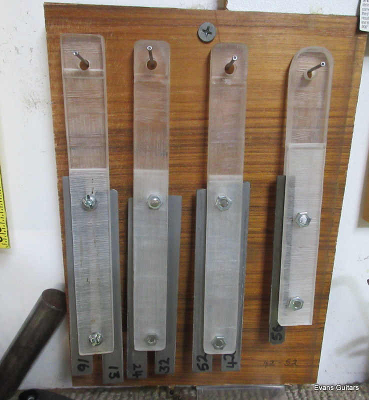

I have many sets also, the last ones being those shown by Martin I have mounted them as in the photo. I find they bind too easily too. I often lay the file on its side and run it down one wall of the slot to give that slight clearance. Taff

That's a cool way to put a handle on those SM files. I'll steal that idea. They will now be called Taff Files, instead of SM files.My inniial search for the diamond files on Amazon only turned up a large set that went from electric guitar to bass and was $270 or so. Since then I've found that they can be bought in smaller, cheaper sets for electric, acoustic, and bass. Replaceements can also be bought individually, which was a concern of mine. That makes things easier. I've ordered an acoustic set. So, I get files and my wife gets flowers!

On the Nomad nut files, I understand that specialty tools are not for the casual users. I did get my set of Nomad files for acoustic guitar today. It will also work for ukes. Nylon strings are pretty forgiving. I used them today on a bone guitar nut and a micarta nut for a 6 string uke. I don't know what their working life will be like, but the new files are really nice. No binding in the slots. I saw some mention that they cut too fast. Well, they do cut fast and that is a plus for me. You just have to stay awake when you are filing and don't get too crazy bearing down. These files can also be bought individually, which is a plus because certain sizes always get more use and wear faster.

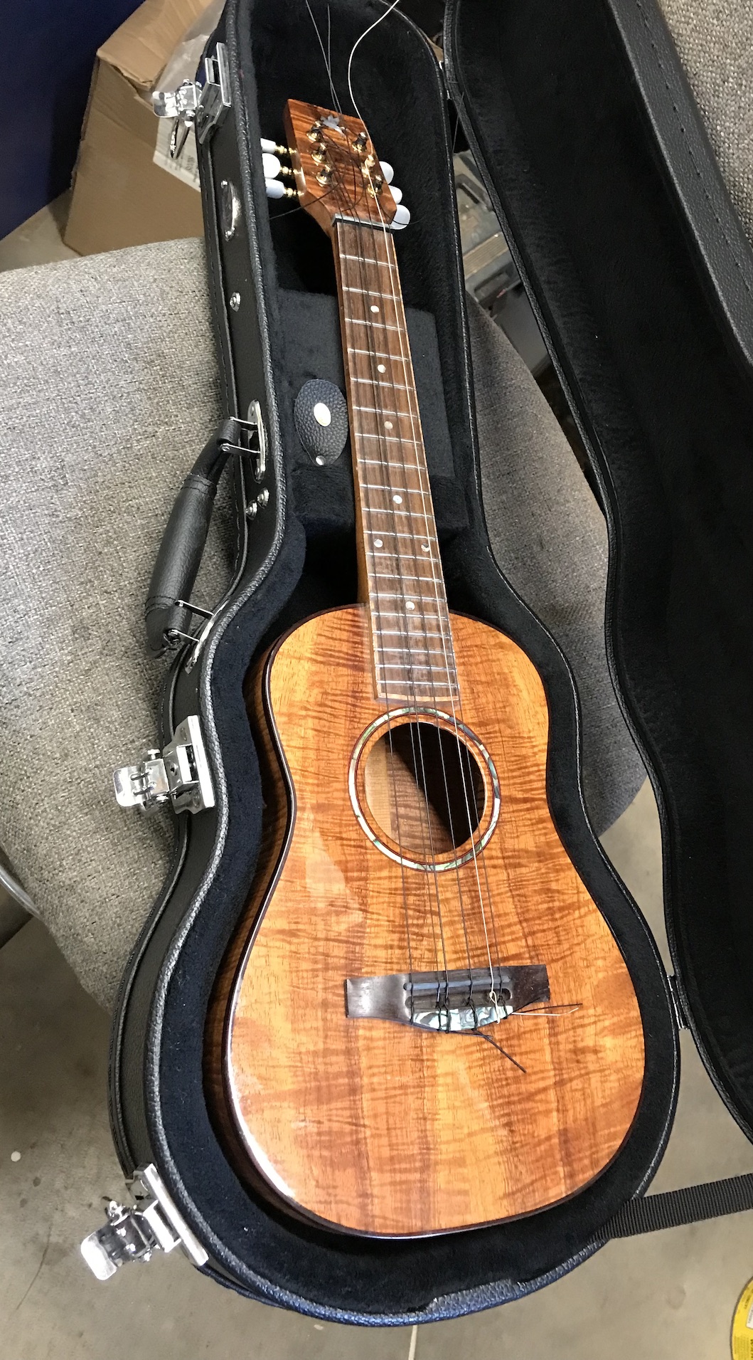

Today's uke was a tenor 6 string. Here in Hawaii I make 4,5.6 and 8 string ukes. They are all played same as 4 string ukes and any extra strings are in courses tuned in octaves..

OK, if they cut fast, clean and accurately I will take that as a recommendation. Do they cut a V-shape or U-shape slot?
