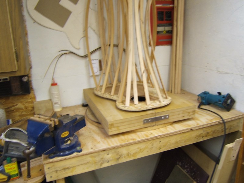

Thanks Rod and Matthew. My RH control room gets to a really balmy 40+ C, so I'm going to have lots more working time than most people will get. I'm going to give it a go. As the Weisenborn has a fair bit more glueing area, Matthews method sounds like it will be easier to do, and I don't have a go-bar deck that is large enough to handle it.
Matthew - is that just a thin coat of HHG at first ?I prime both surfaces with hide glue. then position the top on the sides and clamp lightly all around. I loosen three clamps at a time and work in a bit of hot hide glue on a thin palette knife blade, then clamp tight and loosen the next few clamps, working my way around.
I'll have to try this method on my next basketcase mando - resto ( I just picked up a set of ancient violin spool clamps so I am keen to get the pongy ol' HHG bubbling again and get medieval on it. )
I know the go-bars would be quicker in the heat of the moment than the fiddly lil' clamps though ...
