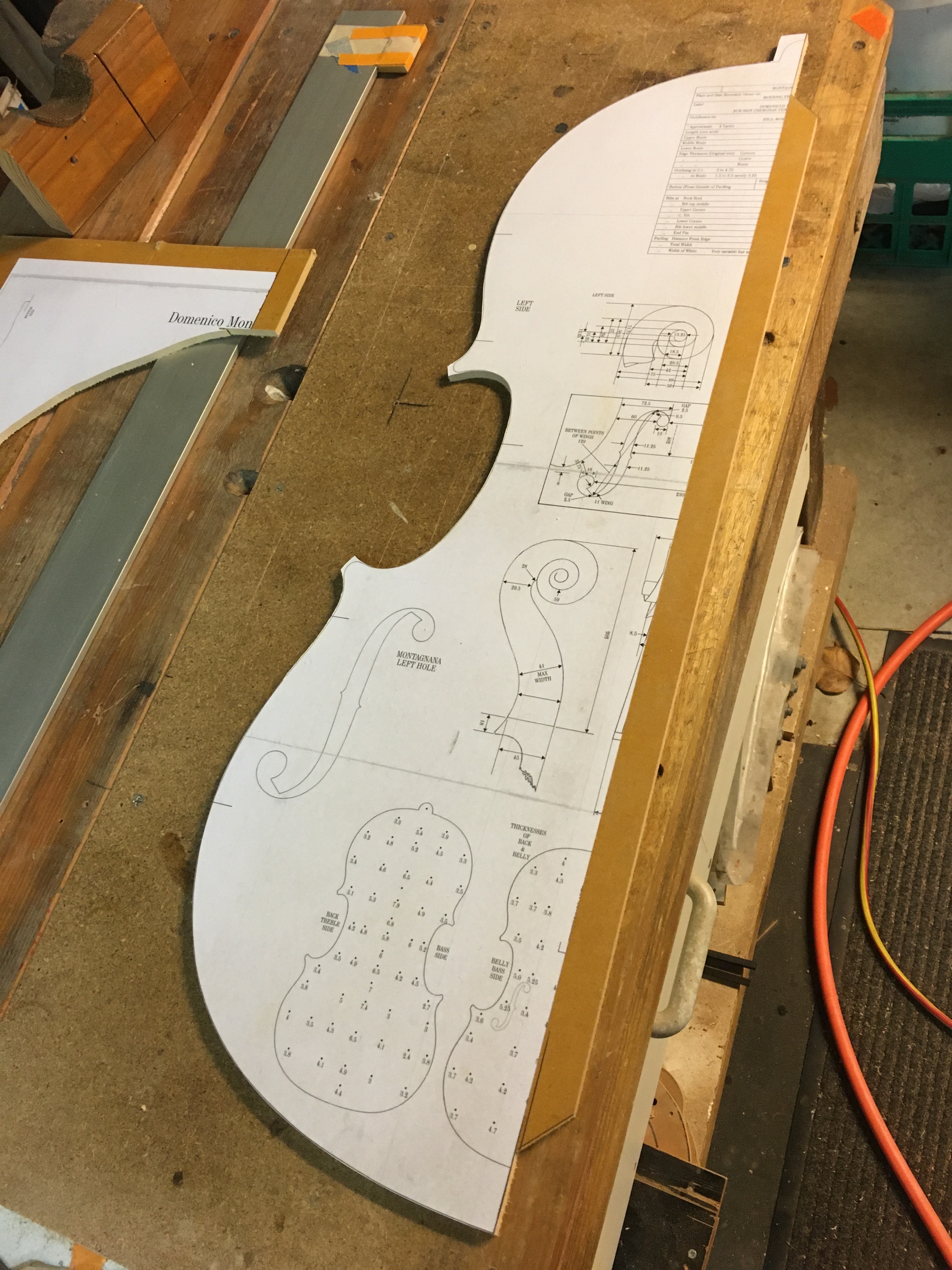

The cello i'm building is a copy of a 1739 instrument titled, "Sleeping Beauty" by Italian master luthier, Domenico Montagnana who was based in Venice. I've been loaned some plans and have started making some patterns. I will be using Australian Otways Blackwood for the back and sides, supplied by Kidman tonewoods, the belly will be European Spruce, yet to be sourced, but not in a rush for that!.
This project is an indulgence really so it'll be sidelined if a guitar commission pops up so this might take a while!!

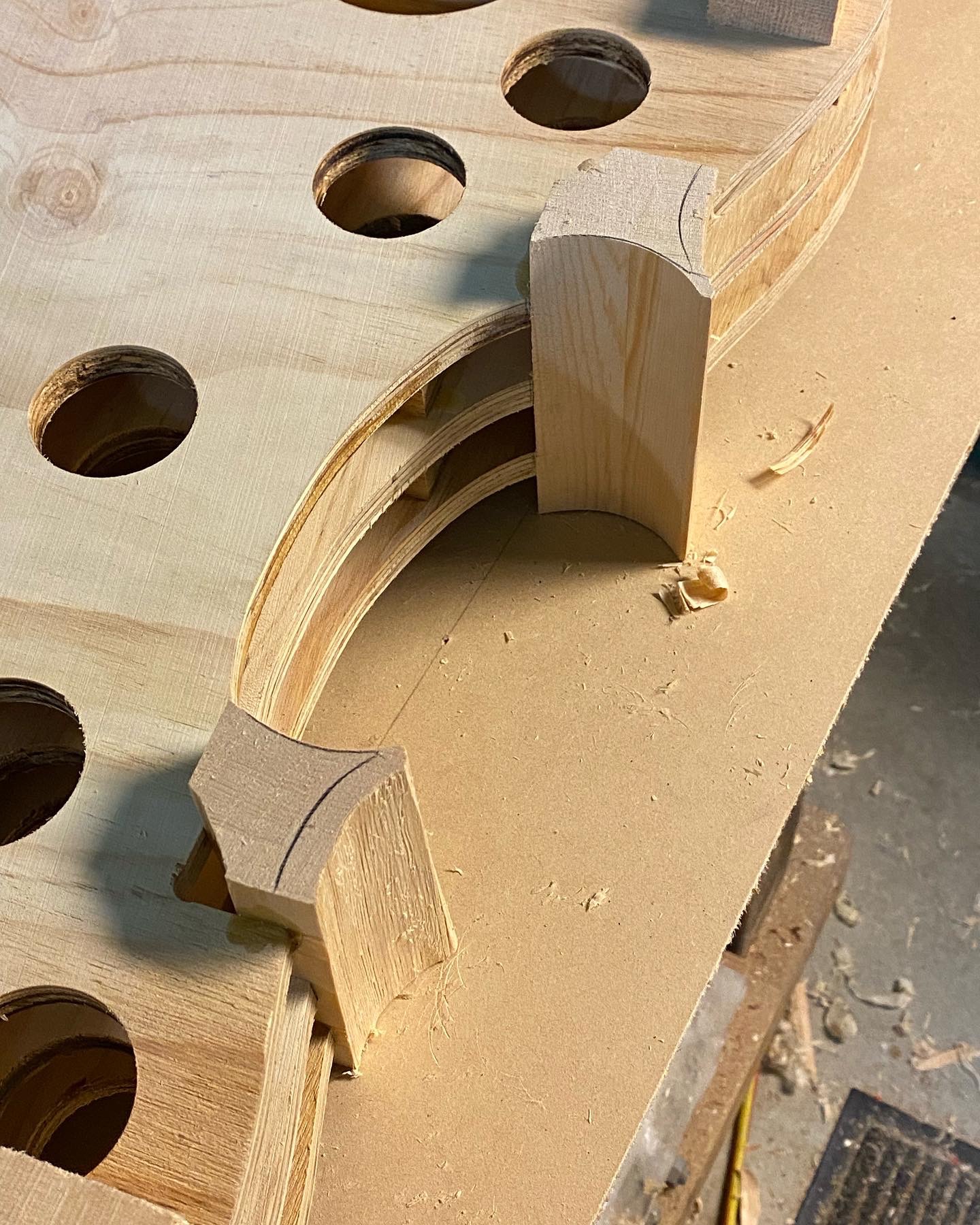

Here's a couple of pics showing the corner blocks being shaped in the C bout.
Rod,
Rod,
