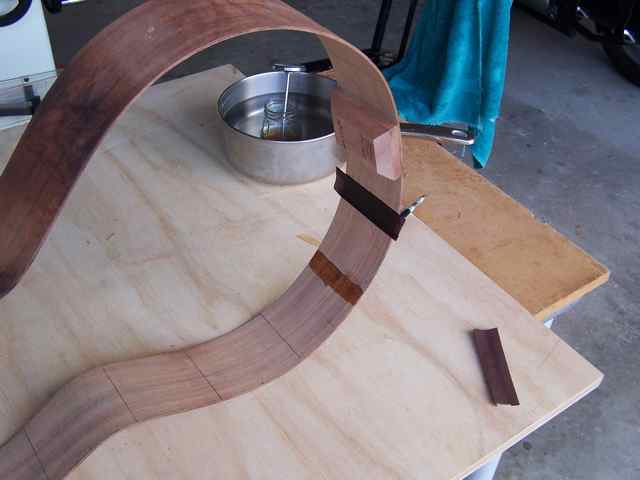

Post by Allen » Sat Oct 04, 2008 5:29 pm

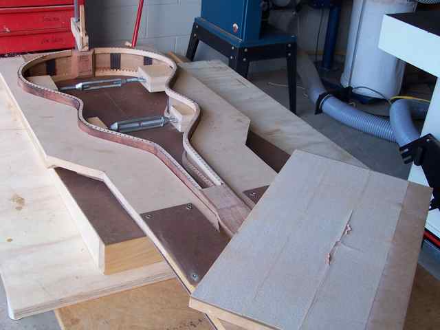

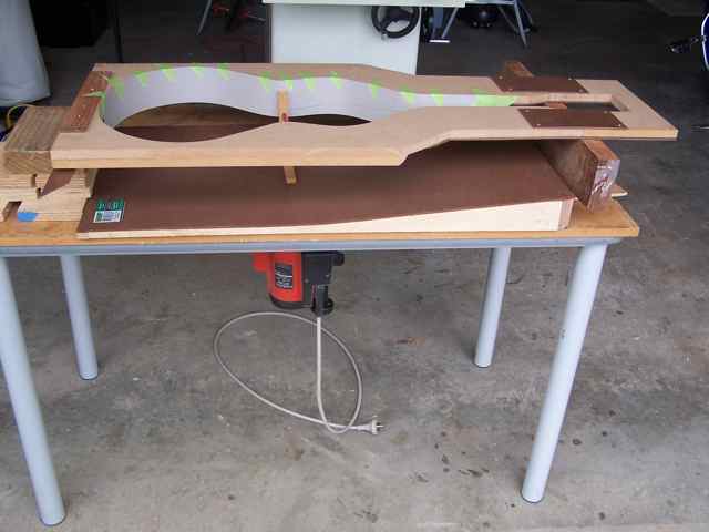

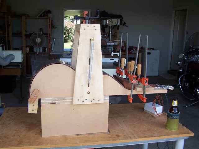

Most of the last few weeks has been spent building a side bender, body molds and jigs. I've finally got to the point where I can start to cut up some tone wood instead of MDF. :D
Not being rigged up for a Weissenborn, and there's not much info available, it's been a little bit of a learning curve. So I'll try and document some of this build for others to follow. I'm no expert, so don't take any of this as Gospel. I reserve the right to change my mind about any of this as I go along.:wink:

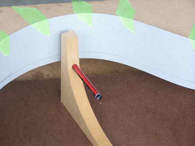

Being too large for my radius dishes, I built a building board similar to one I saw on Christophe Grellier's web site. Along with a body mold and bending form.
I have it propped up above the work board so that it's level in both directions, in order to make a template for profiling the sides.
I attached a 3" wide piece of poster board to the mold. Note that the top edge is level with the top of the mold. Then I made a little jig to hold a pencil to trace the profile onto the poster board.

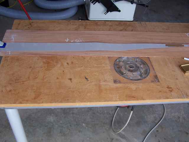

I just cut out the shape with a scalpel and then used the template to lay out the side profile.

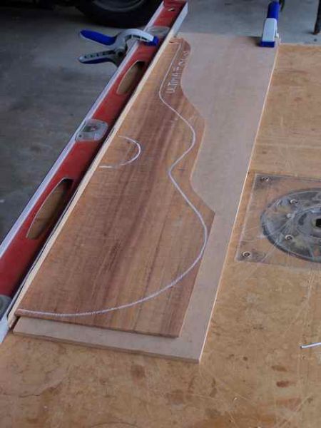

The sides are run through the table saw to give a nice straight edge for the top, and side depth is registered from this edge. On this instrument its 3" deep at the butt, and 1" at the headstock joint. You need to take the top and back thickness into account when you do your layout. I also bend my sides registered off of the butt joint, so I've squared a line off a few mm in from the edge to give me a little wiggle room in case the side slips a little in the bender.
Mark off the depth at the butt, and at the head stock. Lay on the template and pencil in the line.
Cut the sides to the correct profile.
Load the first side into the side bender and proceed as usual.
This was the first time to use my new side bender, and it works a treat. To bend Weissenborn sides I'm going to need to come up with a little easier way to bend the upper bout / neck area. Perhaps something along the lines of the press for a Venetian cutaway. This method worked, but it takes more hands than I have. :lol:

Then you don't want to know that to bend a side all I did was load up the slats. Turn the timer and blanket on full for 3 minutes, turn the heat off for about a minute while I got the butt attached and started to crank the waist down. Karen and I started with the upper bout clamping, and I turned the heat back on. Gently started to snug every thing up, and let cook for another 3 minutes. :shock:
Turned off heat. Cooled down to just warm. Then hit it again with full power for 5 minutes and cooled off. Came out of the bender perfect with just a touch of spring back. :D The other side is going to be in over night. Will post more pictures tomorrow.

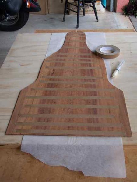

Post by Allen » Sun Oct 05, 2008 7:12 pm

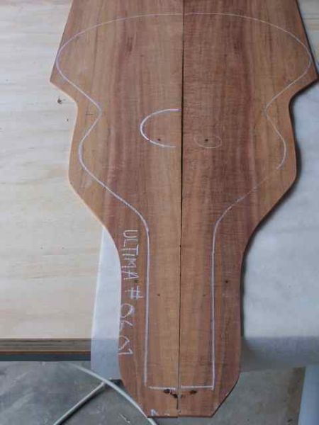

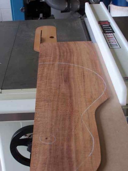

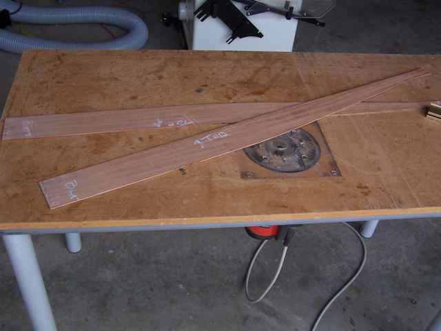

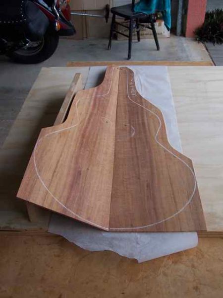

I don't own a really long jointing plane, and these plates needed some trimming to get them close. The back set actually had a much larger gap than this one, but I didn't have the camera at the time.
If you have access to a table saw it's really easy to trim boards like this to get a joint that is virtually ready for glue. First off you need a board that is wider than the one you want to trim. Here I used some 6 mm MDF. Then I used a few pieces of double sided carpet tape to glue the top to the MDF. Take note that the lower bout has very little extra to still be inside the body shape. The neck has heaps of room.
I set the fence to just kiss the edge in the lower bout, but took about a blade with by the time it was up at the head stock. I used a piece of MDF to hold the top set down flat to the board underneath so that I'd get a nice clean cut. Couldn't take that picture while I was cutting though.

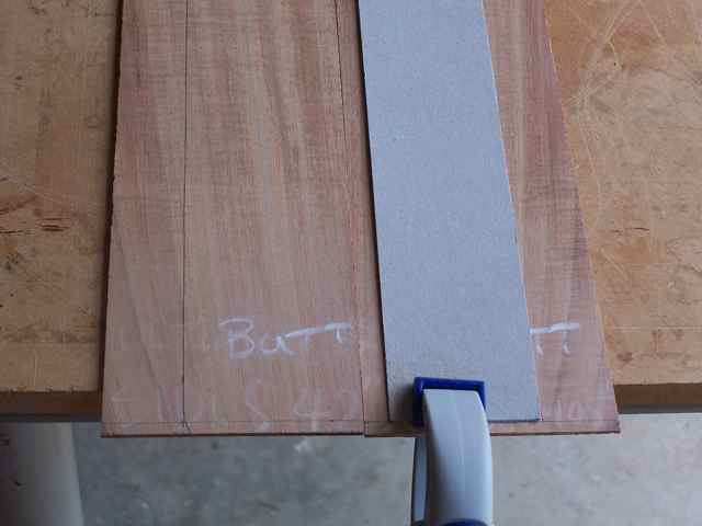

The joint was almost perfect. Just needed a light rub against a straight edge with some sandpaper glued on.

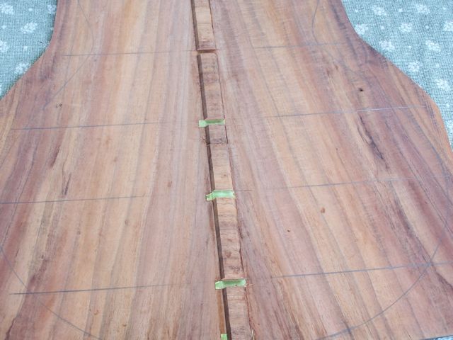

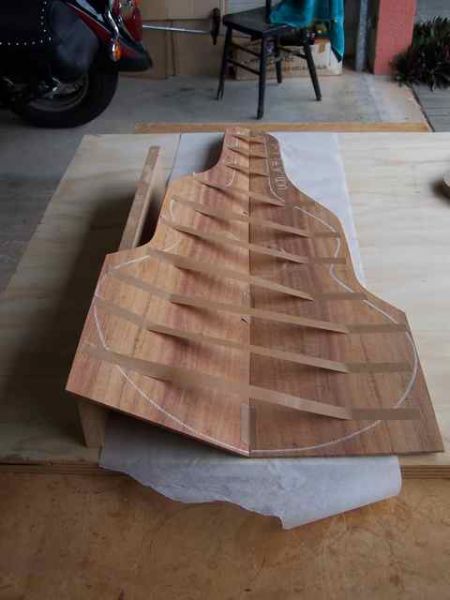

Propped up ready for the "Tape" joining method.
There are a few small pieces to keep the pieces registered to each other, then long strips tacked down really good on the ends.
Apply glue to both edges and press down onto a flat work surface. Be sure to have some non stick paper underneath. Notice that I use a syringe to apply the Titebond. I find that it's much easier to put just the right amount on the very narrow edge of the plates.
Clean up glue squeeze out and then flip the plates over carefully. Clean up squeeze out on this side and stretch tape across this side as well. Make sure that the edges are nice and even. Then weight down and let dry. I use a very large slap of granite countertop material.

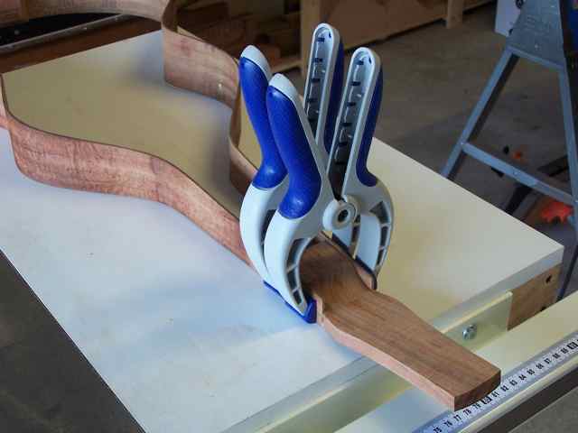

Making the end block requires it to have a slight radius to match the curve in the lower bout. I held up my radius gauges and found that it was very close to 16'. Just what my fret board sanding beam is.
Glue in the end block and the head stock.

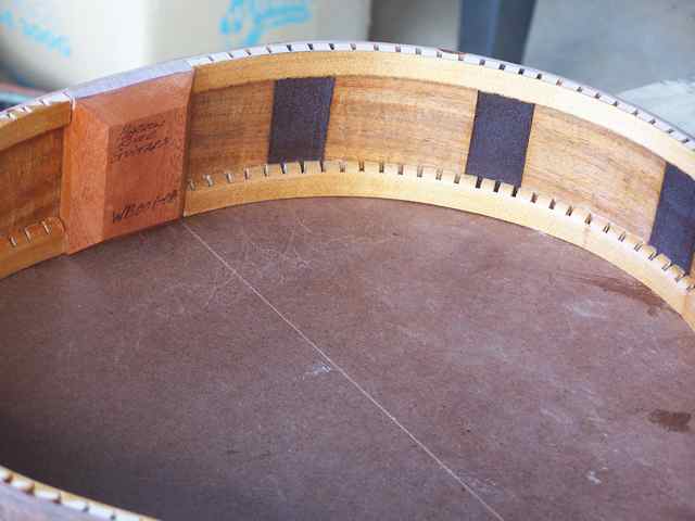

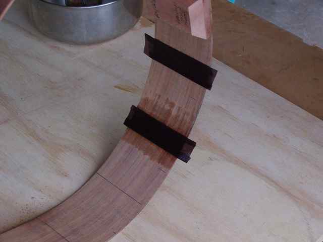

Next up is installing the side reinforcement tapes and the linings.

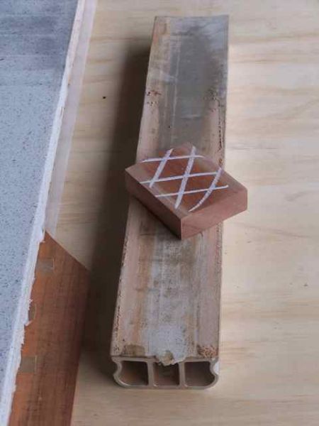

First up the fabric tape reinforcements.
I used a small square to mark off the spacing around the rims. The reinforcement tape is just your standard bias tape that is used in making garments. Comes in all kinds of colors, so you can pick something that compliments the color of your wood if you like.
I heat up the hide glue and use a small brush to lay down a thin layer where the fabric tape will be installed. Then lay the tape in place and then brush some more glue over the top. Clean the edges with warm water and move on to the next.
Let dry over night, then trim the daggy ends flush with the rims.
I make my own linings. These are Kauri Pine, and are the first time that I've made reverse linings. I usually make solid linings, but this was taking too much time, and with a new table saw, I was keen on trying my hand at making these. I spent about 1 hour and made enough for 6 instruments.
This was pretty standard stuff. Make up more hide glue, I make it fairly thick for this application and give it a quick burst in the microwave to heat up around 180 degrees. This was a tip that I saw on Frank Ford's site. The glue isn't affected by this high of a heat for such a quick burst. It gives you a little more working time, and you only heat up as much as your going to need.
Brush on the glue and clamp up. Crack open a beer. Call the wife and show her what a great job you've done.

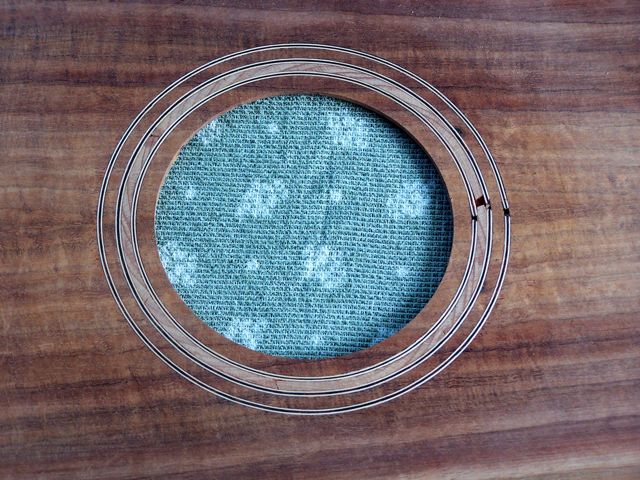

I decided on a rosette and binding theme. Managed to finds some nice Queensland Maple for the bindings, and went with a rosette that keeps to the classic look of the vintage instruments at first glance, but has just a bit of a difference, that if you're looking, you'll spot it.
It's maple / koa / maple purflings and the wood in the inlay is end grain Monterey Cypress. When the Cypress is wet up, it turns a rich golden brown, that makes it blend in quite close to the color of the Blackwood. So it ends up looking a bit like the 3 concentric rings that were on some of these instruments.

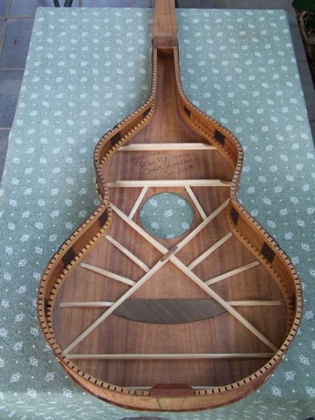

Post by Allen » Wed Oct 15, 2008 9:18 pm

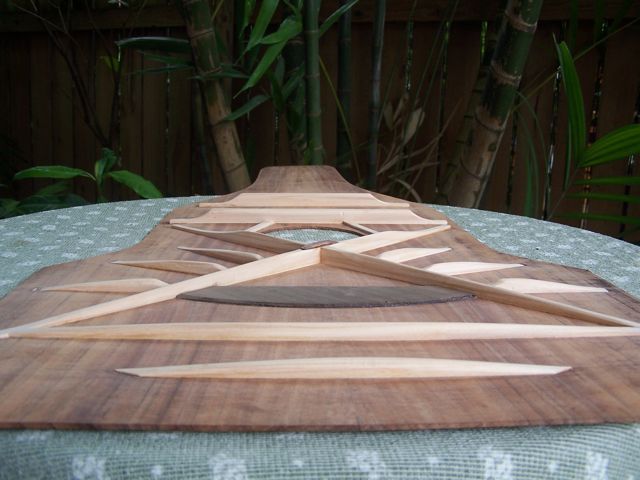

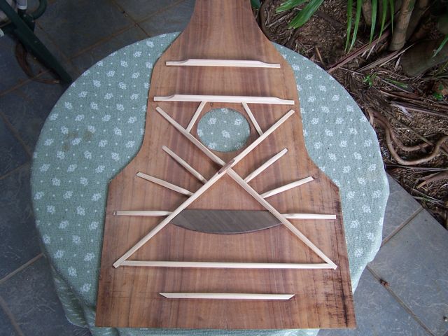

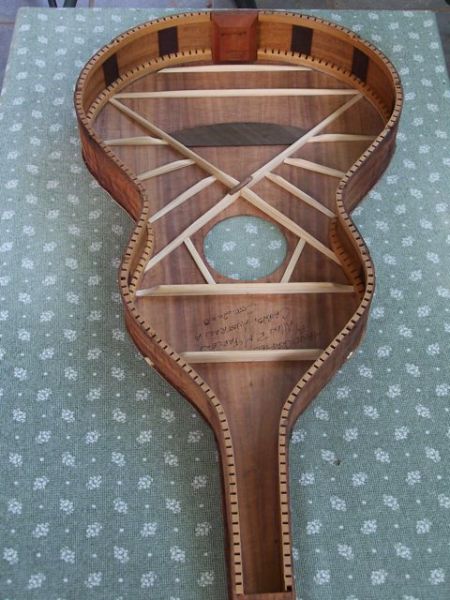

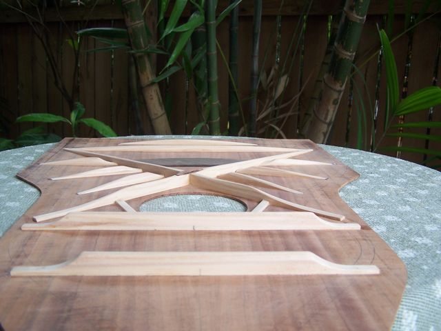

The top has been braced and braces shaped.
Looking at both sets of plans that I have, and taking Richard's comments about how he lightens up the braces on his instruments, I changed the bracing to sizes similar to what I do on my standard build acoustics.
X-brace is 7 X 12 mm instead of the 10 X 10 mm that is called for in the plans. Lower ladder braces started out at 7 X 10 mm and shaped partially before glueing down. Upper transverse braces are a full 7 X 12 mm and finger braces are 7 X 10 mm but shaped a fair bit. Bridge plate is Qld. Walnut.
I'm also building this with my standard 25' radius on the top instead of a true flat top as the plans call for. Everything in front of the sound hole is flat though. Don't want to complicate fitting the fret board.

Interesting approach to the bracing Allen, particularly the tone bar braces. I agree, that rosette is cool.

The bracing is the standard pattern from Stew Mac's plans except for down sizing the width, and increasing the hight. And making it a 25' radius dome behind the sound hole.
The bridge patch is a little larger than called for in my plans, but there is a note in the plans about the bridge patch changing is size over the years to a larger one when the bridge became smaller.

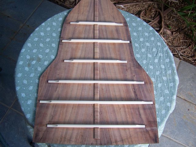

Post by Allen » Thu Oct 16, 2008 6:47 pm

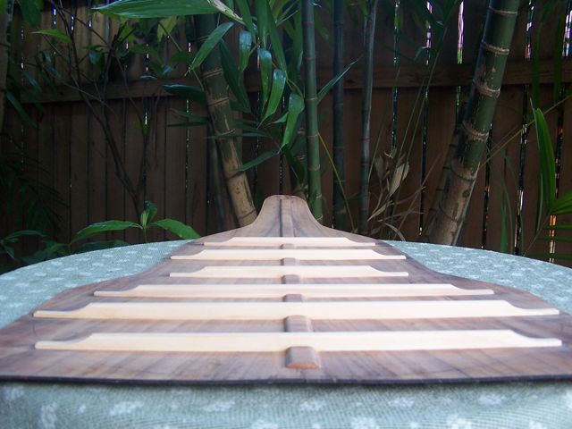

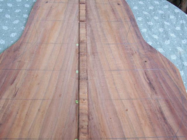

On the back, I've used off cuts of the Blackwood for the centre strip. I also follow a tip that I got from Hesh about using a bit of masking tape where the braces will land so that when I cut the notch for the brace, the center strip just pops out.
The back is built with a 25' radius as is the top. The plans call for a flat back, but with the wild humidity fluctuations here, I wanted some dome built in for a bit of a safety margin
The back braces are 7 mm X 12 mm instead of the 10 X 10 mm called for in the plans.
