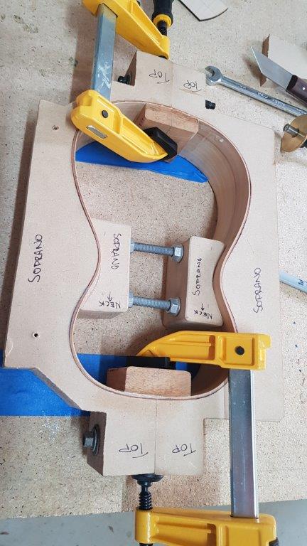

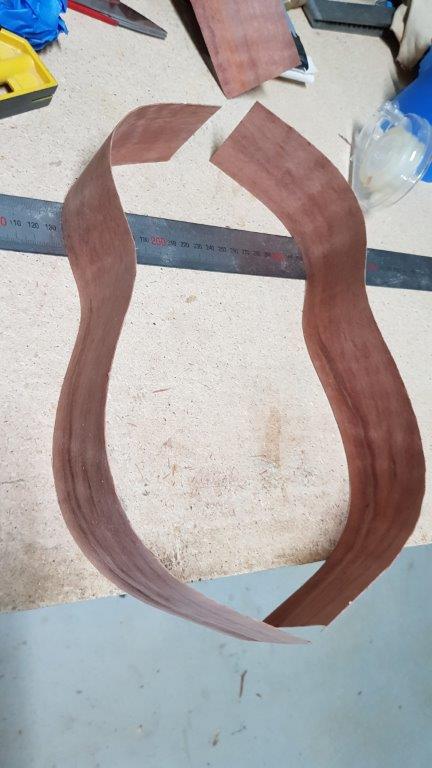

Trying to post pictures on my desktop. Seems to work once I've rescaled them - maybe they were too big straight off my phone.

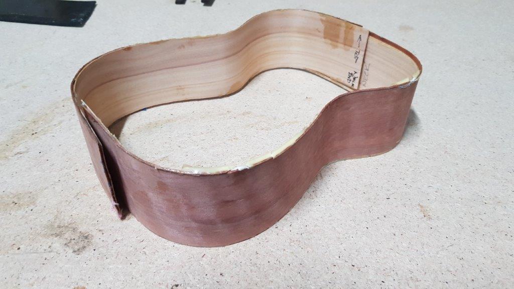

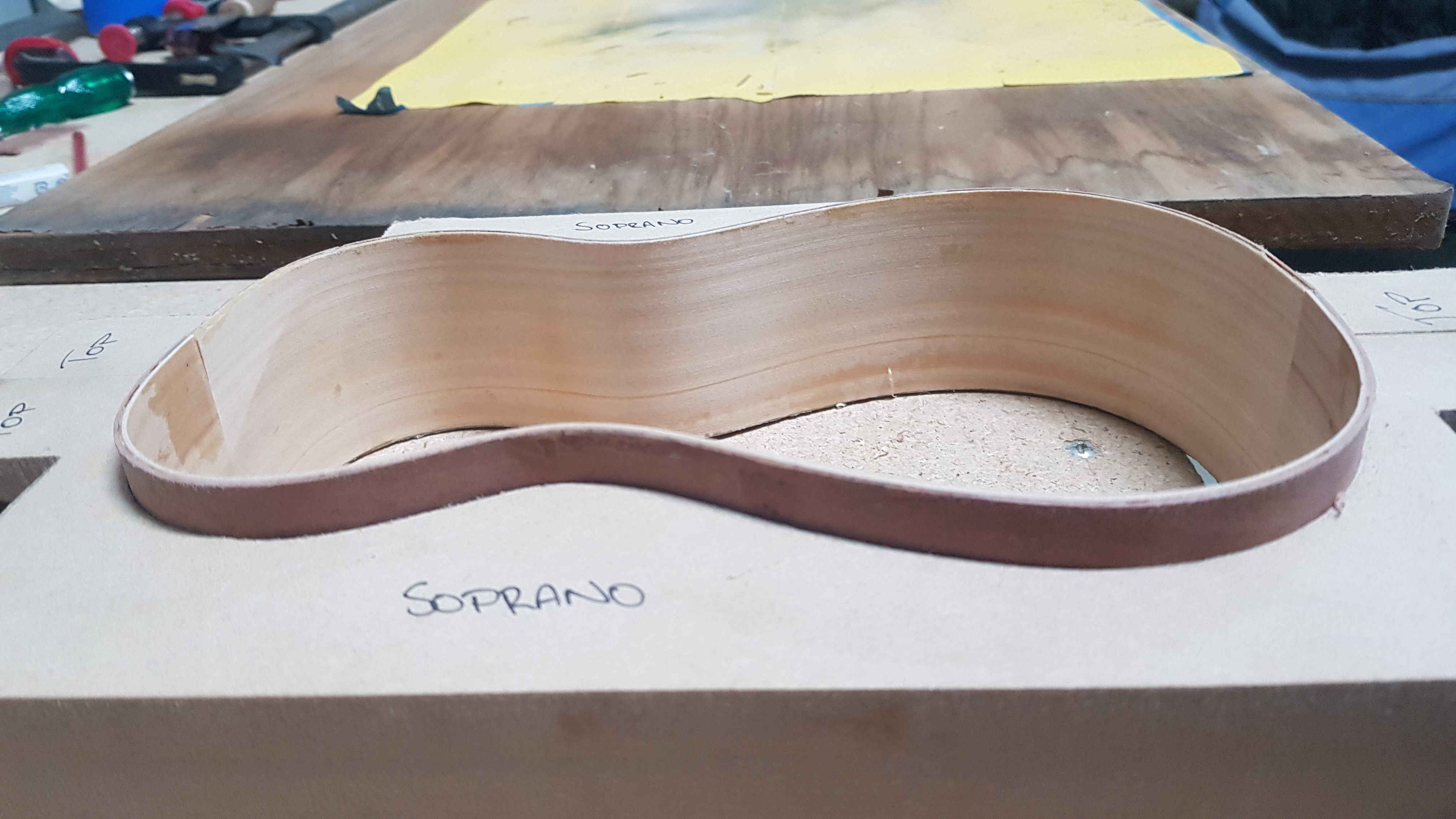

Anyway, here are the pictures:
First two are the soprano sides straight out of the forms. They've got two bunya pine inner plies. Side bending form. I used a bit of 3mm insertion rubber in there to help. I discovered after breaking my first myrtle side piece that I needed to pre bend them to get them in the forms. I soaked them under warm water for a few minutes and they went in okay. The tiger myrtle veneer that I'll be using on the back. I've got 2 slices, so can do a book match, but I threw the form on the one piece just for a laugh and the asymmetrical look is actually really growing on me. Bunya pine sound board for the soprano. The colour isn't actually very deep in the wood, maybe not even a mm. It's quite pale on the other side, so I'll need to be careful in doing final sand to not go through the interesting bit. I can sneak a second soprano sound board out of the same piece of bunya pine (not that I need it at the moment, but good to know for in the future) but it's getting mighty close to that knot. Would I be setting myself up to fail if I used this piece? One side of the book matched back for the tenor

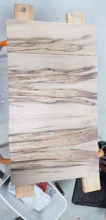

Re: Two ukuleles
Should be ok but if there's any part of the knot within the back perimeter I'd first flood it with CA glue to fill any voids.

Awesome, thanks Martin re: the sound board. I think for this go I'll just use the other, safe end of the same piece anyway.

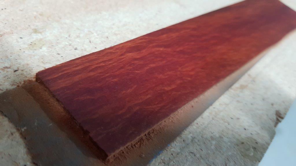

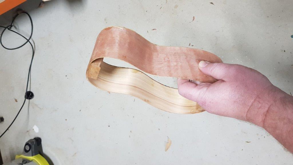

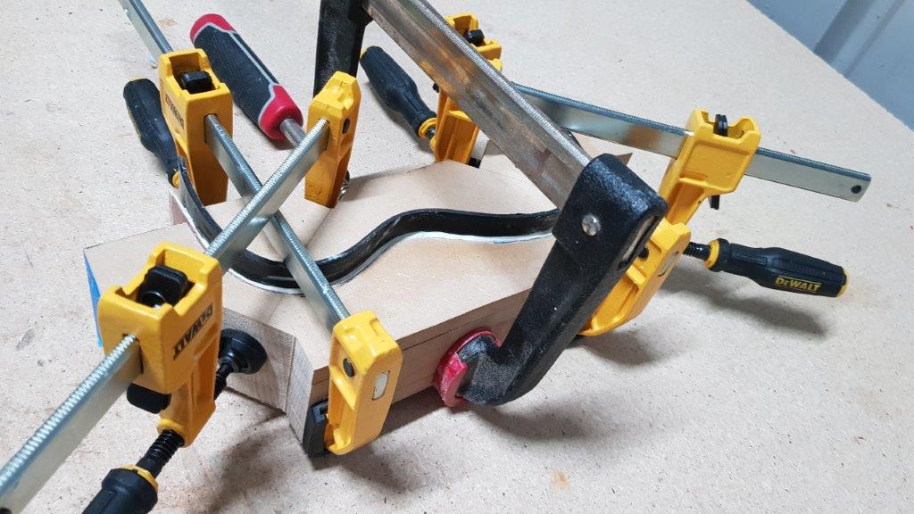

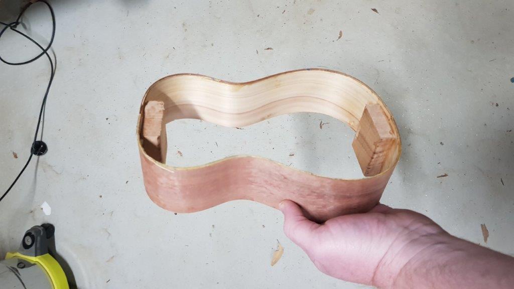

A bit of an update on these.
- The soprano rims are now joined and self supporting. Neck and heel blocks are left over Qld Maple from the neck of the electric guitar I've done.
- The soprano back plate is now made; laminated two inner bunya pine layers and an outer Tiger Myrtle face. The middle layer is cross grain. Decided to throw caution to the wind and go with the asymmetrical layout. I like it, it's a bit different.

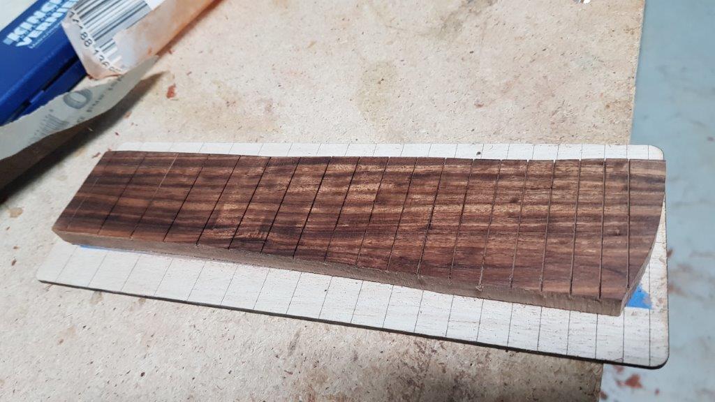

- The mulga fretboard for the soprano now has it's fret slots cut, I just need to bring the whole blank down to thickness.
- The sheoak fretboard for the tenor has been thicknessed and is ready for fret slots.
- I've done the initial sand up to 400 grit on both fret boards and they're looking stunning. Very hard to photograph though.

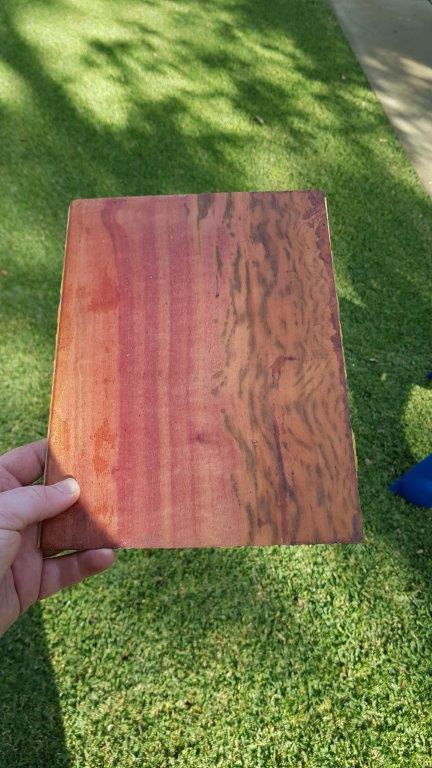

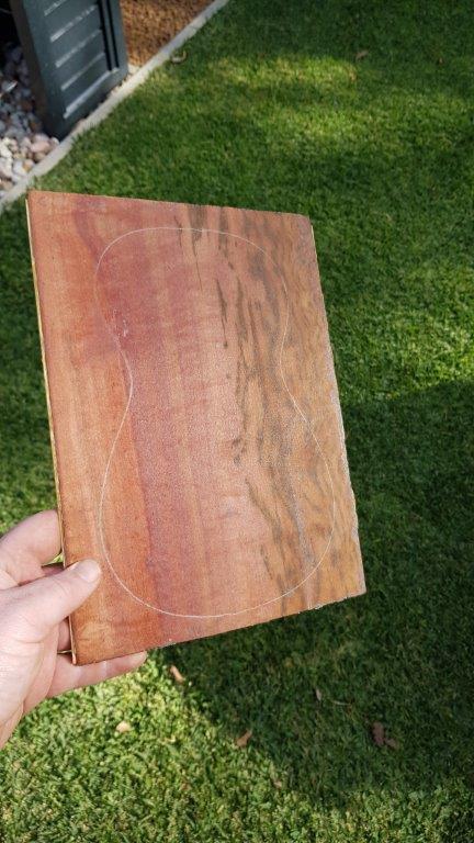

- 20220219_160417.jpg (41.3 KiB) Viewed 21391 times

Save that for backs.
I would pick spruce of some sort first for the instruments you are building.
If you are really wanting Aussie timbers then Huon Pine is great on soprano's or concerts. King Billy Pine is a good all rounder though it's fairly soft so if the player is not careful you can ding / scratch it easily.
Re: Two ukuleles
Yeah, fair enough, thanks Allen. My suspicion was that it probably wasn't going to be a great option, but figured it was worth checking anyway.
