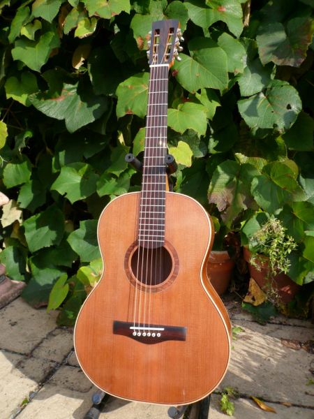

My favourite steel string guitar has always been the slot-headed OOO 12 fret, I’ve built quite a few over the years, but this is the first one that I’ve put a redwood top on. In fact the first redwood guitar I’ve made. Here’s the details.

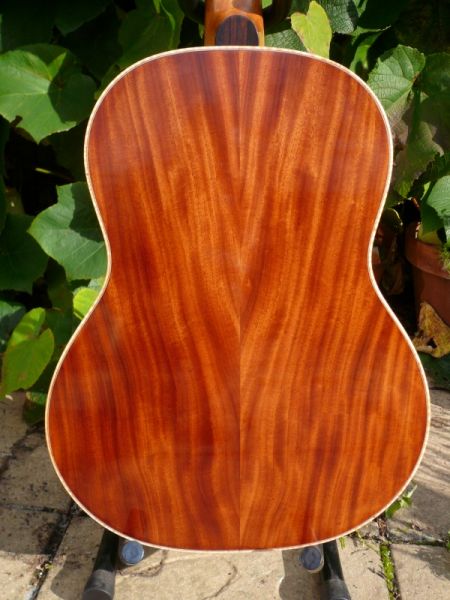

B&S: Cuban mahogany
Top: Redwood

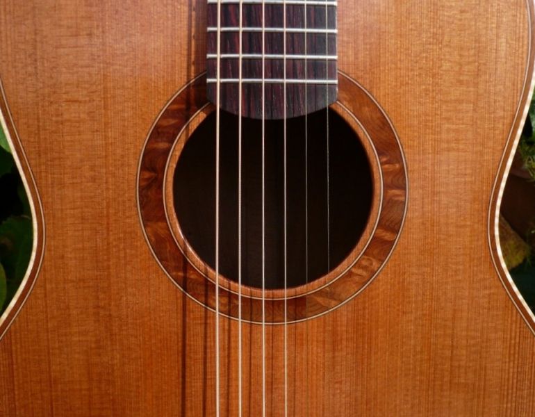

Rosette: Redwood burl (courtesy of Steve Kinnaird)
Neck: Honduran mahogany
Binding: Curly maple
Purfling: Cuban mahogany, B/pear/B

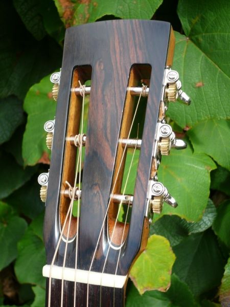

Bridge/FB/headplates: BRW, (this wood went into the college stores in 1840!)
Finish: Frank Cooper’s chunky cut Oxford marmalade.
This of course has my usual ‘parabolic’ bracing but on this one I added an ‘A’ brace inlet into the X brace and headblock and passing through an open UTB. It also has my usual bolt on neck with the FB glued to a neck extension inlet into a mortice in the headblock rather than glued to the top. Never seen the point of bolting on the neck, only to glue the FB to the top.
I’m really pleased with this guitar, which was built more as a test of the top and bracing, but I think will probably become my main standard tuning guitar.

Mmmmmmmmm . . . Cuban!!
That's a fabulous guitar. Gorgeous wood combinations very elegantly put together. The slot head detail is great and the rosette, binding and purfling just work so well. Very Lowdenesque. The Frank Cooper marmalade finish really gives the wood a great lustre and it looks like a tactile wooden creation rather than something in shrink wrapped poly. I like the look of that straight grained redwood top rather than the curly wild stuff that seems to be all the rage at the moment.
It sounds fabulous too - I can hear the inbuilt reverb of the Cuban Mahogany and the balance and complexity of sound is really nice. And it's only a few days old. The Talisker certainly oiled the wheels - really nice grove and bounce to the playing.

It's a nice looking guitar Colin. I'm interested to know why a prefer your guitars slot headed

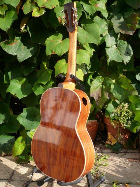

What's the scale length on that one Colin?
In the pic from behind, the neck looks shorter than my 12 fret 000s (from the stewmac plan), or is it a bit wider than 'normal'?

Paul, its a satndard 632mm (24.9") scale witha 46mm nut. I shall ignore the pearl reference!

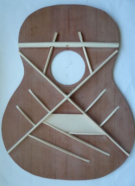

I thought that you might like to see the bracing. The A frame passes through openings in the UTB and is inlet into both the headblock and the X brace. Only the top arms of the X and the UTB are inlet into my solid laminated linings.

Also, your use of the r'dwood burl looks much better than mine!

Cutting the rosette from the burl was the most nerve-racking part of the whole build, it shatters if you just look at it wrong, and I thought if I make a cock-up of it, I'd never hear the end of it! I did however find a layout that had the grain running in quite a nice circle around the rosette. Thanks again for the kindness in sending me the wood.

Good to see a departure from the bracing norm. Obviously it works. I was surprised to hear that the trebles sound full and sweet even though you use parabolic bracing. I tried it once and found the trebles too bright even though the bridge was well into the lower bout and the bridge plate did not crowd the X brace joint.
Did you use rock maple for the bridge plate? That extra little brace behind the bridge plate attracted my attention too. (Seriously) how did you arrive at the idea of isolating the UF brace from the "A" braces in that way, and do you think it has any noticeable impact on the tone of the instrument?
