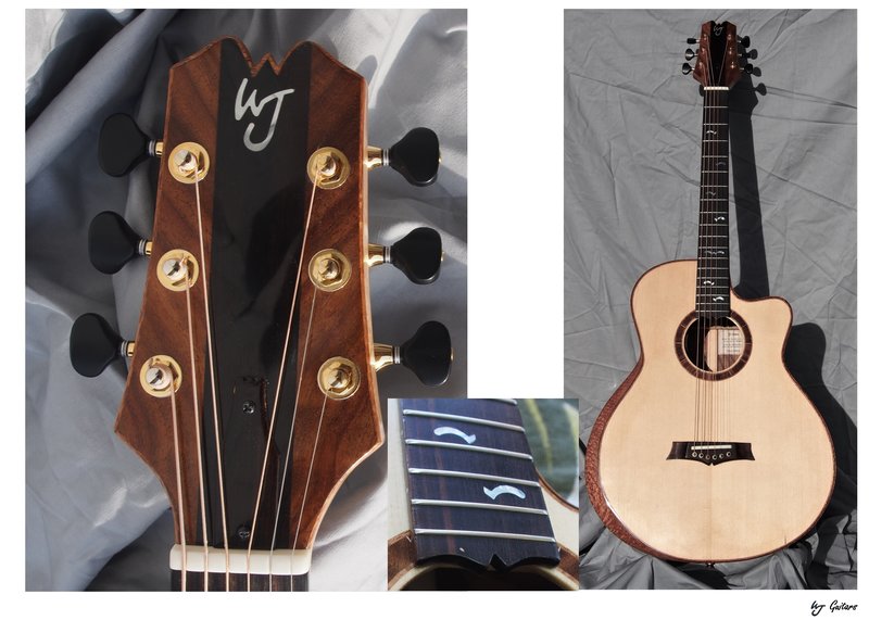

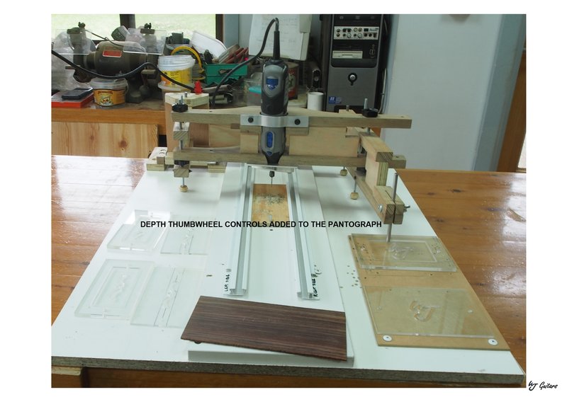

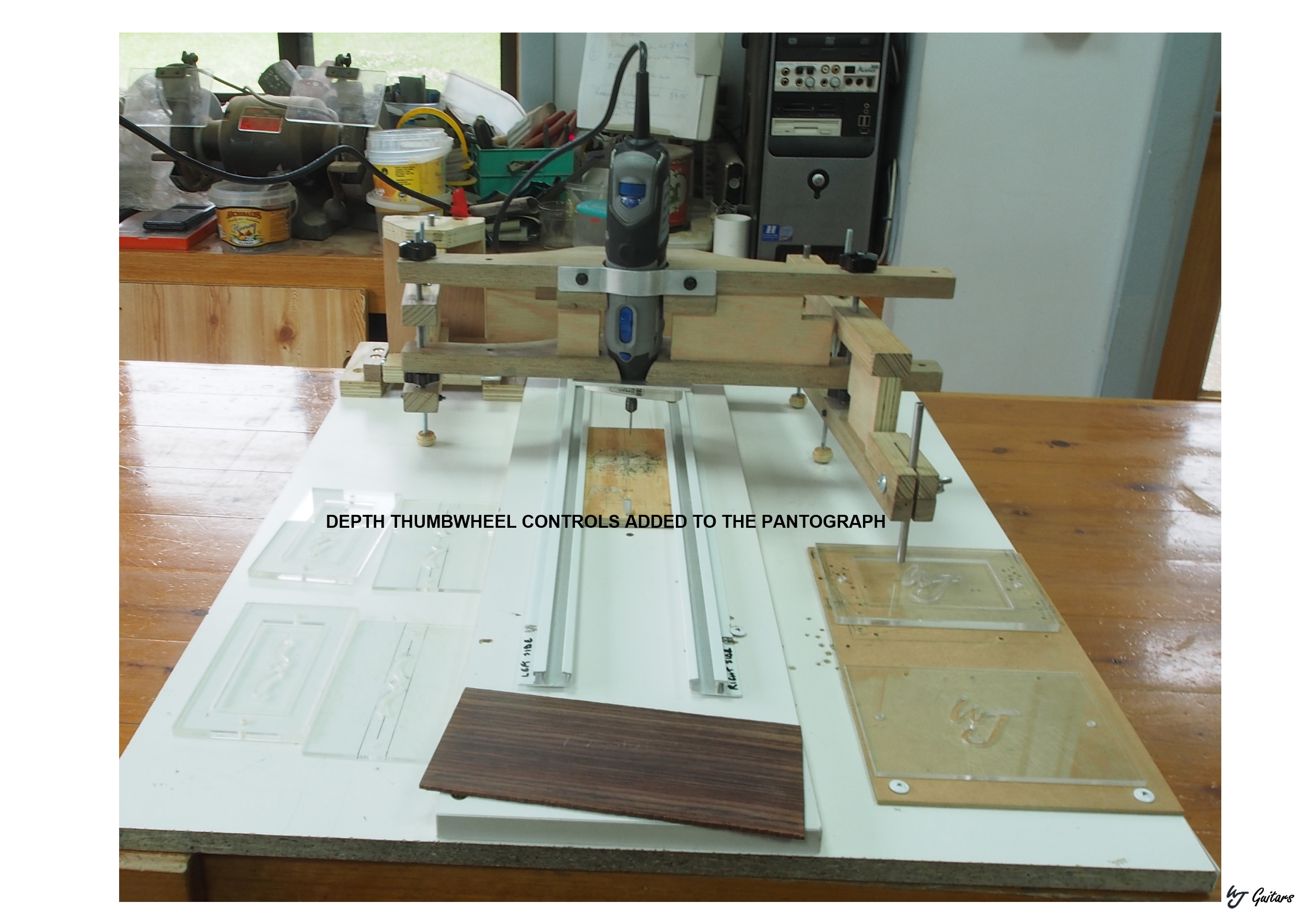

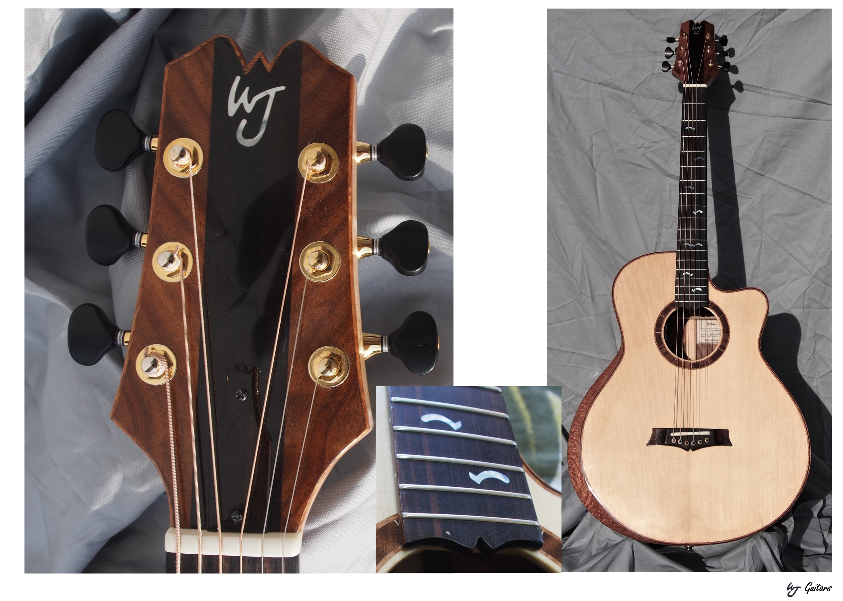

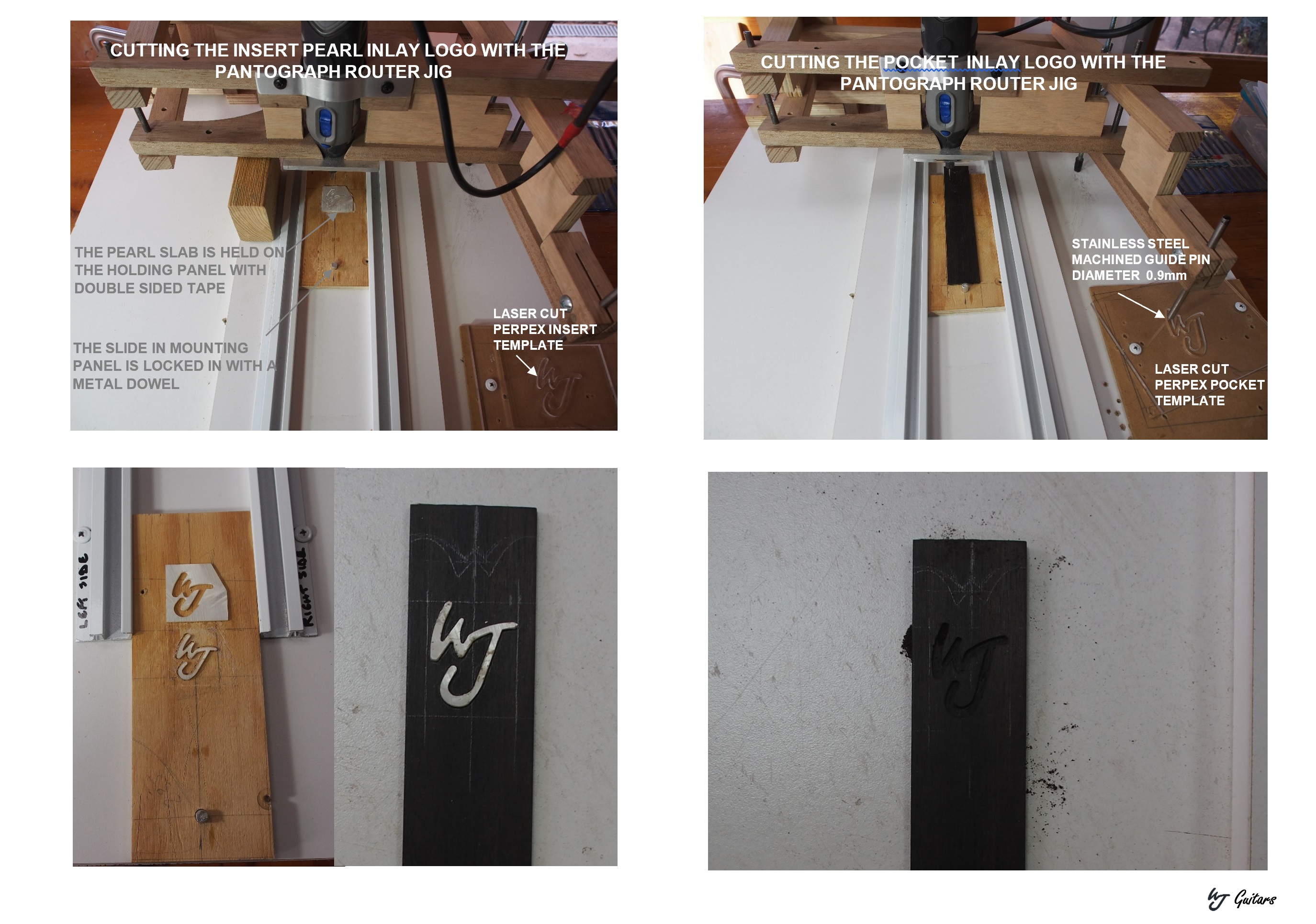

Dave, I make my logo inlays using a pantograph that i built and previously posted my pantograph jig in the forum. I wanted to be able make repeatable logos and decided that instead of making a full name logo I design a logo with my initials. This easier to do and reduces the potential difficulties cutting more complex designs and is used by many luthiers. You just need to create a more interesting format for this style of design or, maybe a symbol style logo.
I have watched the 'Stewmac' inlay video and I am impressed with the hand work and method used to cut a more complex logo. If you have the time / patience, with good eyes and a steady hand making repeat logos for your guitars is possible. I have also watched a number of CNC you tubes cutting complex shell inlays and yes very impressive results. Many factors and stages are involved as I would expect you may be aware of.

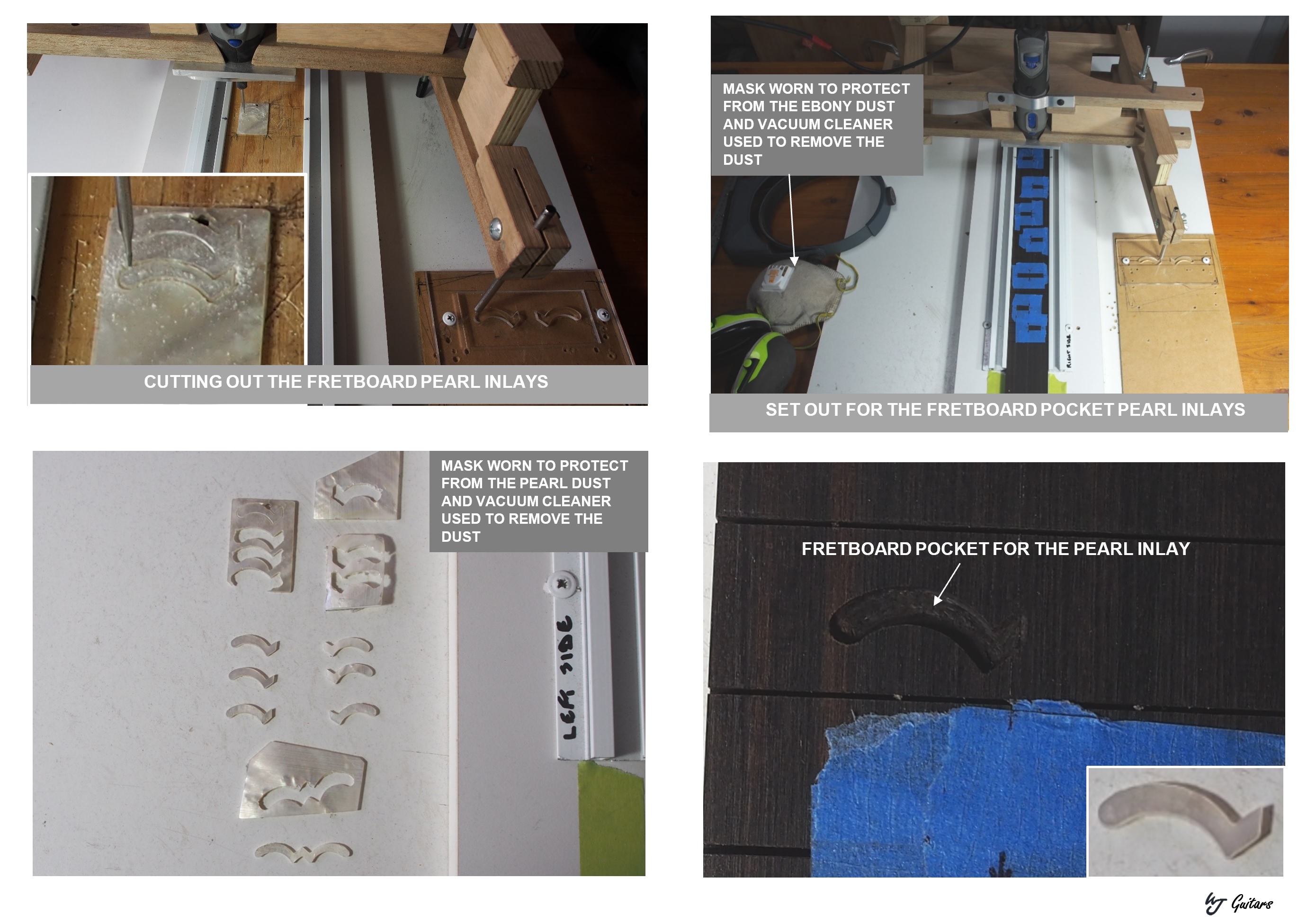

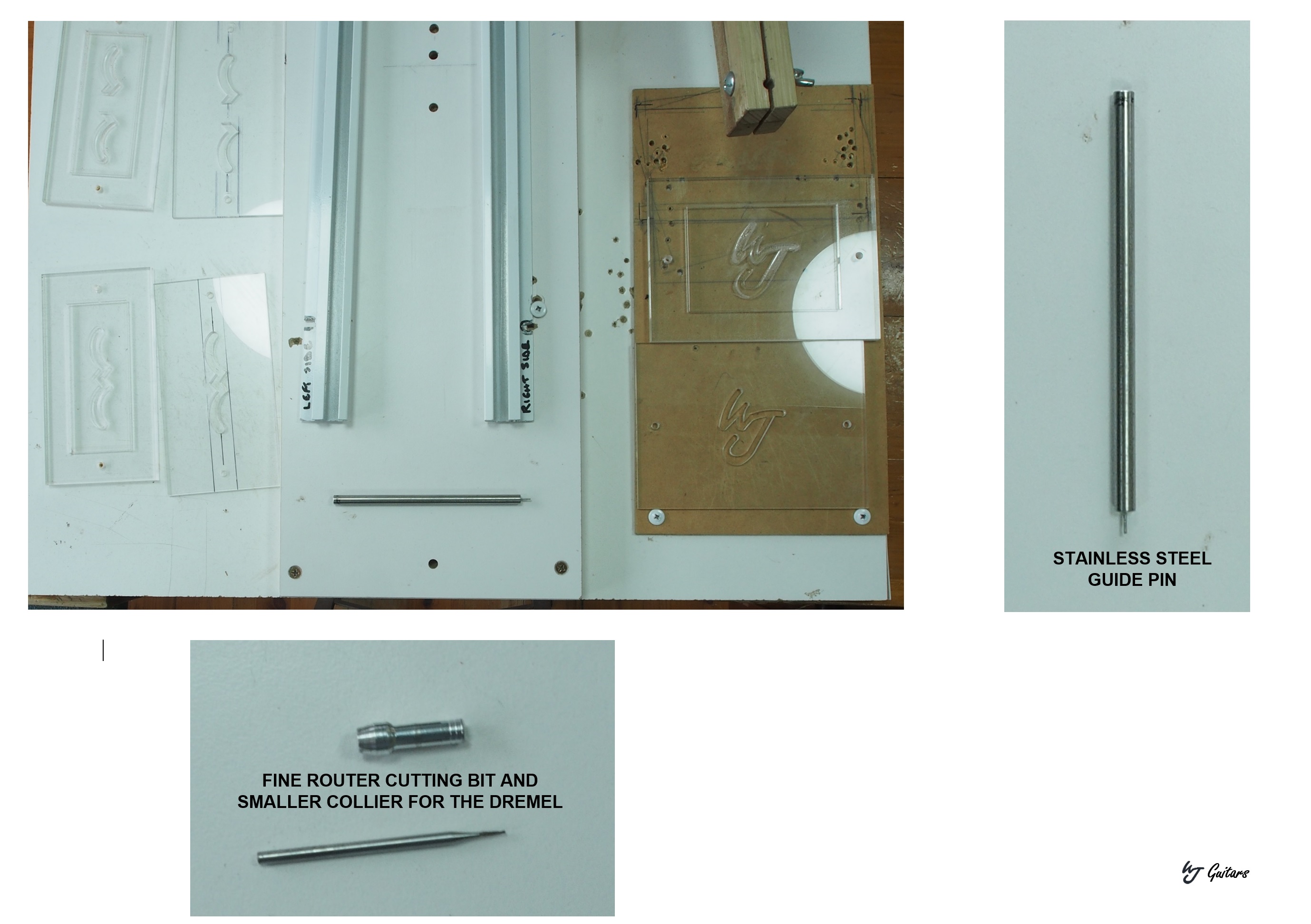

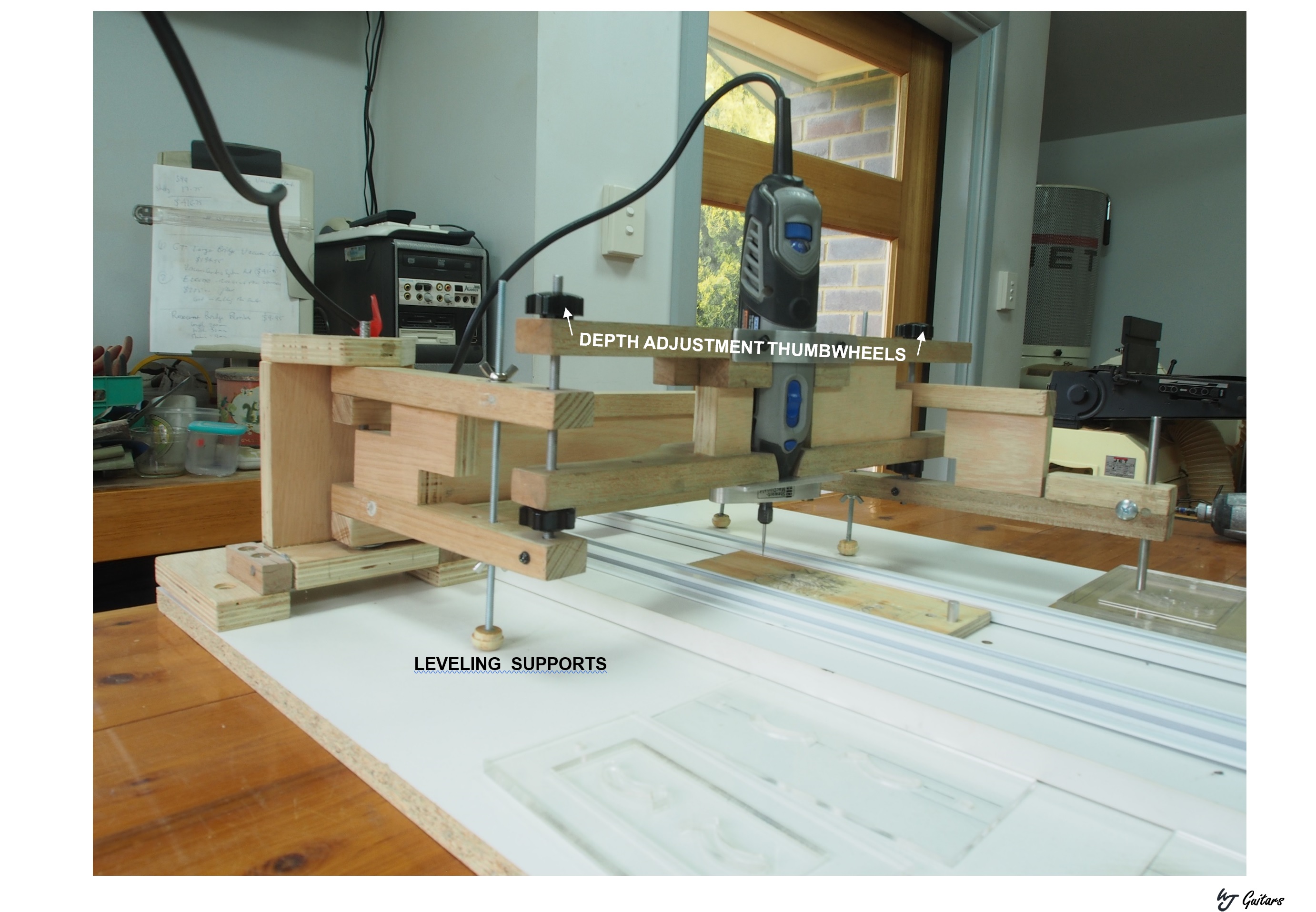

I'm now more comfortable and experienced using the pantograph. Recently, I made a modification to my pantograph and added thumbwheels to make fine controlled depth cut. This control minimises breaking the fine router bits when cutting the pearl slabs. It is important to only make very small depth increases as you cut the pearl.

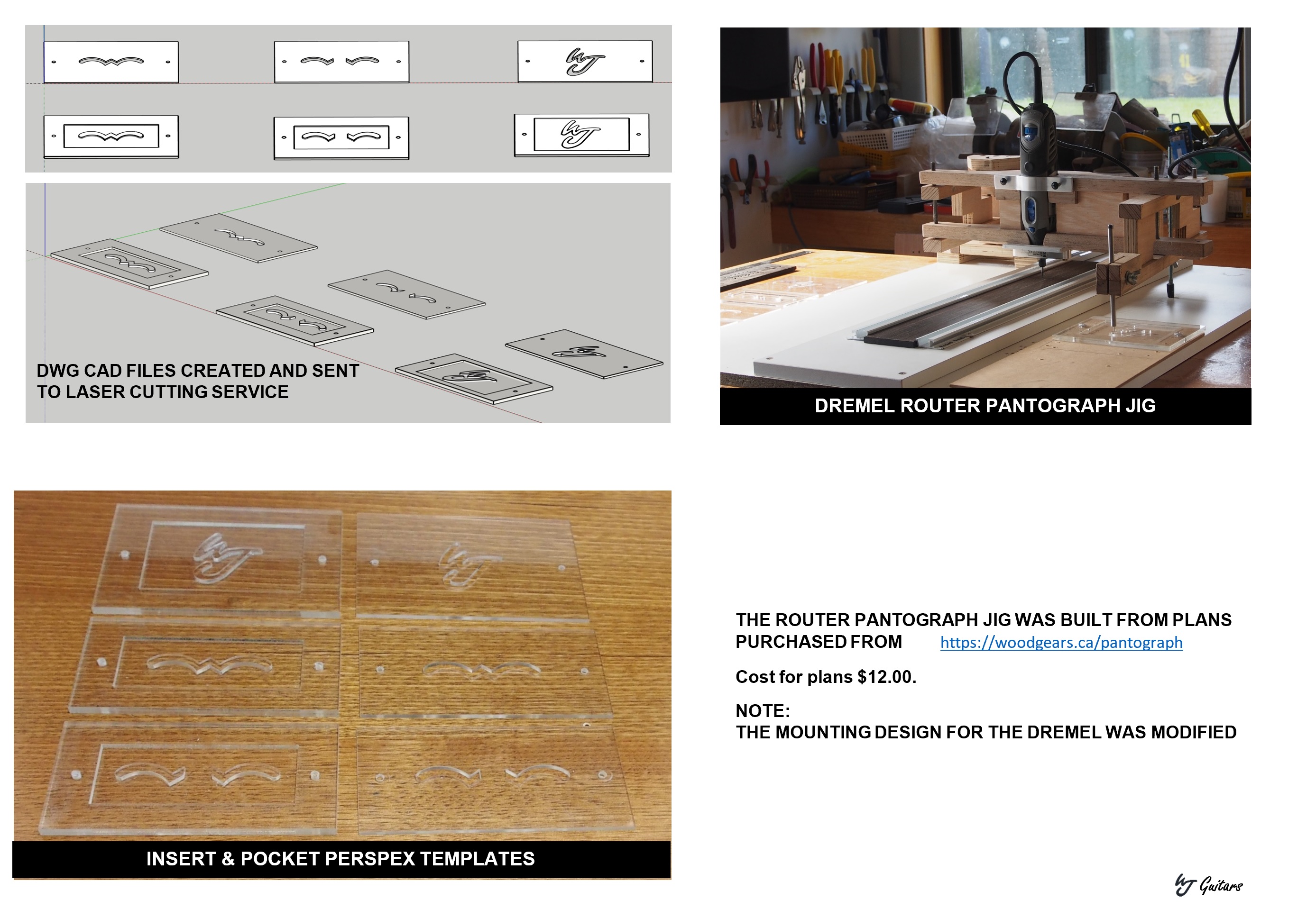

Using the pantograph my guide templates are sized at 2:1 ratio. I designed my logo on a free CAD drawing program and had the insert and pocket templates laser cut from a local laser cutting company. Each template cost me around $12.00. I just had to submit a DWG drawing files to have them made out of perplex. If you want them made in metal the cost would increase. See photo attachments.
If you are interested in this method I can provided more details.
