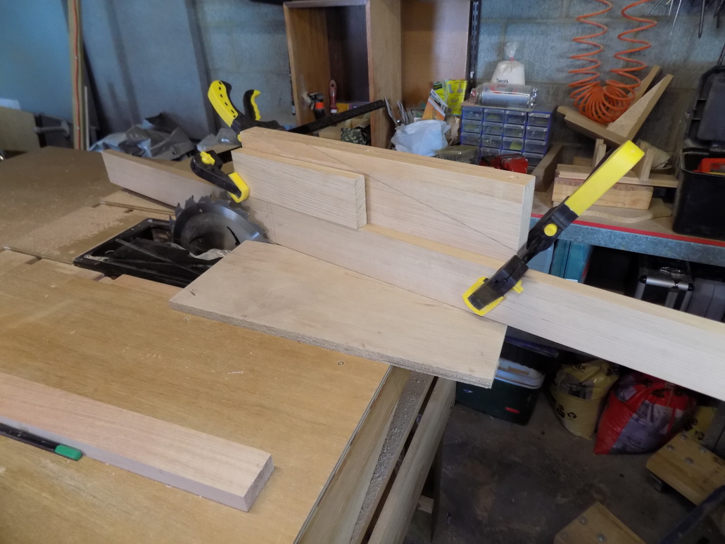

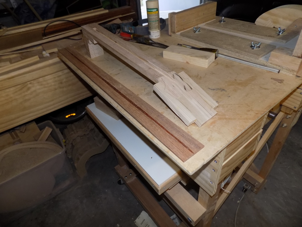

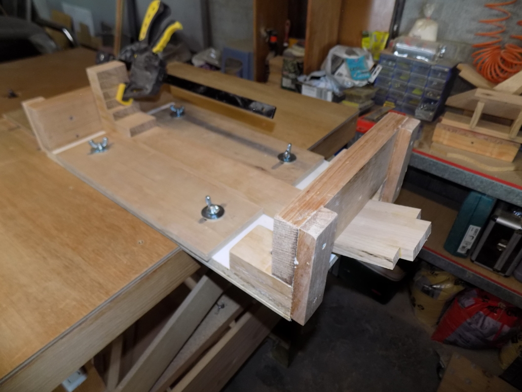

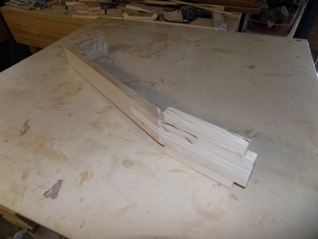

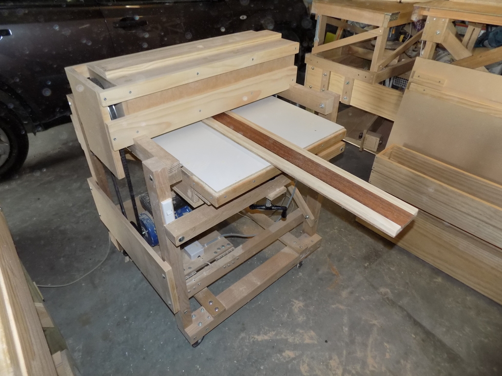

Cutting the neck scarf joint with a jig on my (self-adapted) table saw

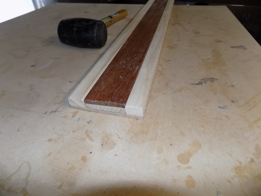

Neck pieces glued up
Cutting the truss rod slot in the neck using another jig
Cradle to hold the fingerboard blank for cutting bevels
Cutting bevels in the fingerboard prior to sanding in the radius

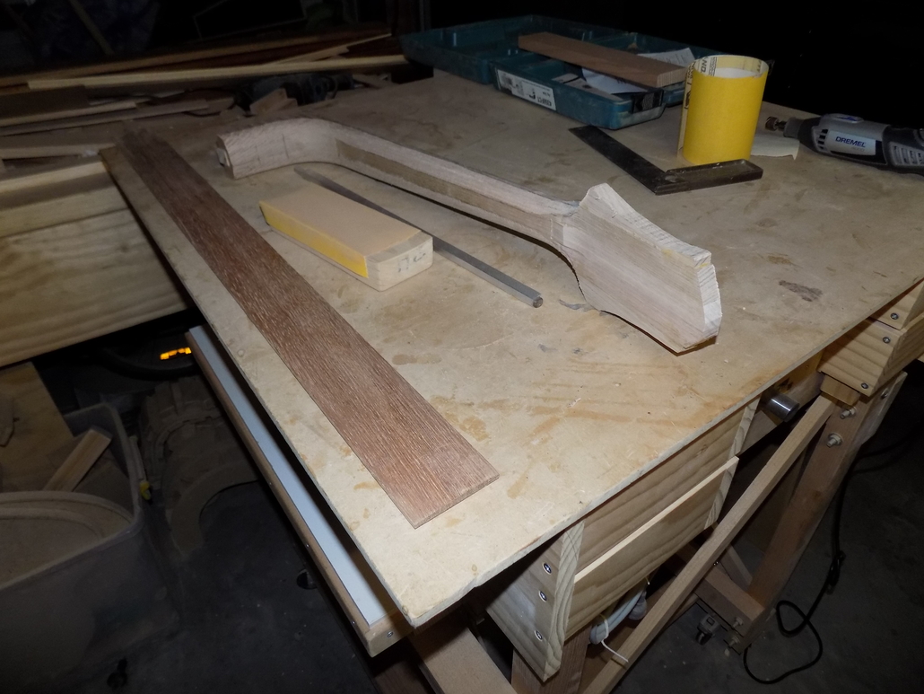

Neck and fingerboard components

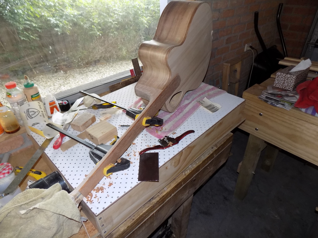

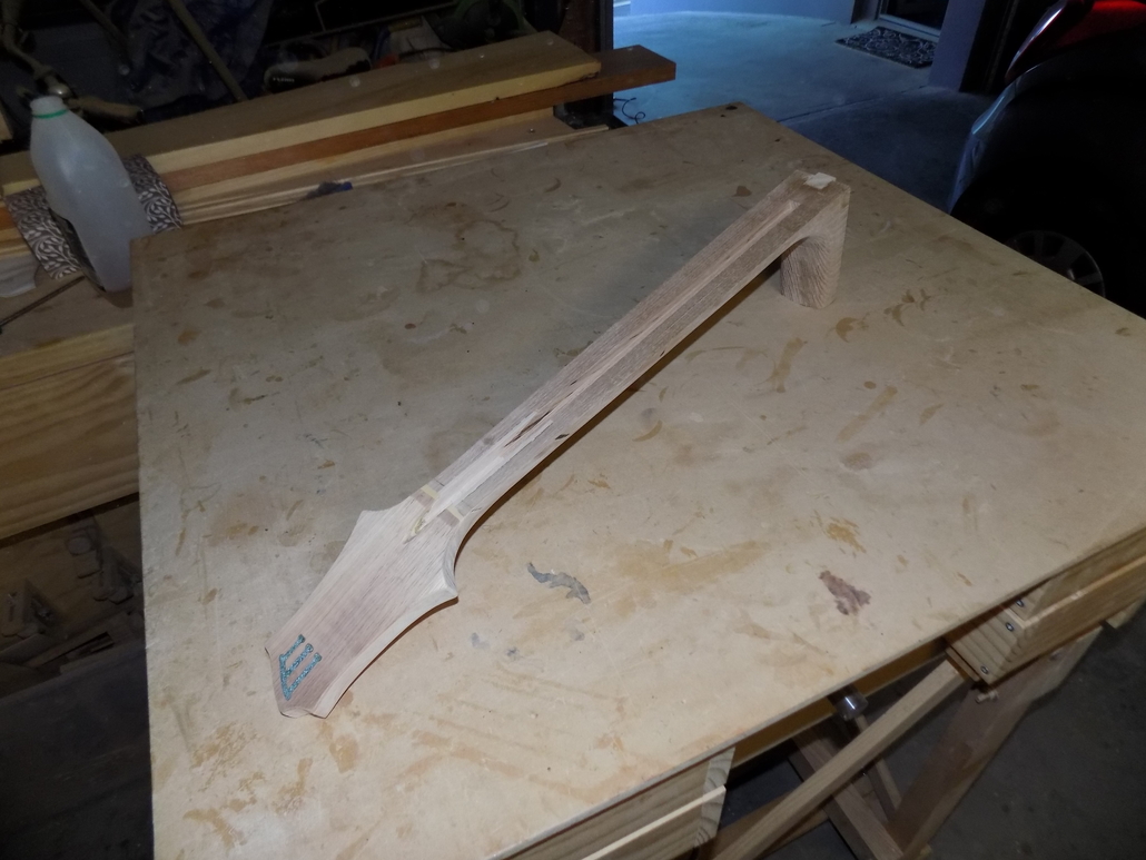

Neck after initial shaping

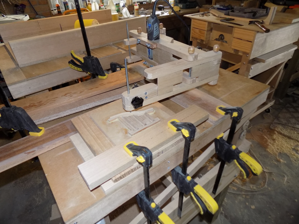

Pantograph jig for Dremel, reduces the template by one third, for headstock inlay channel

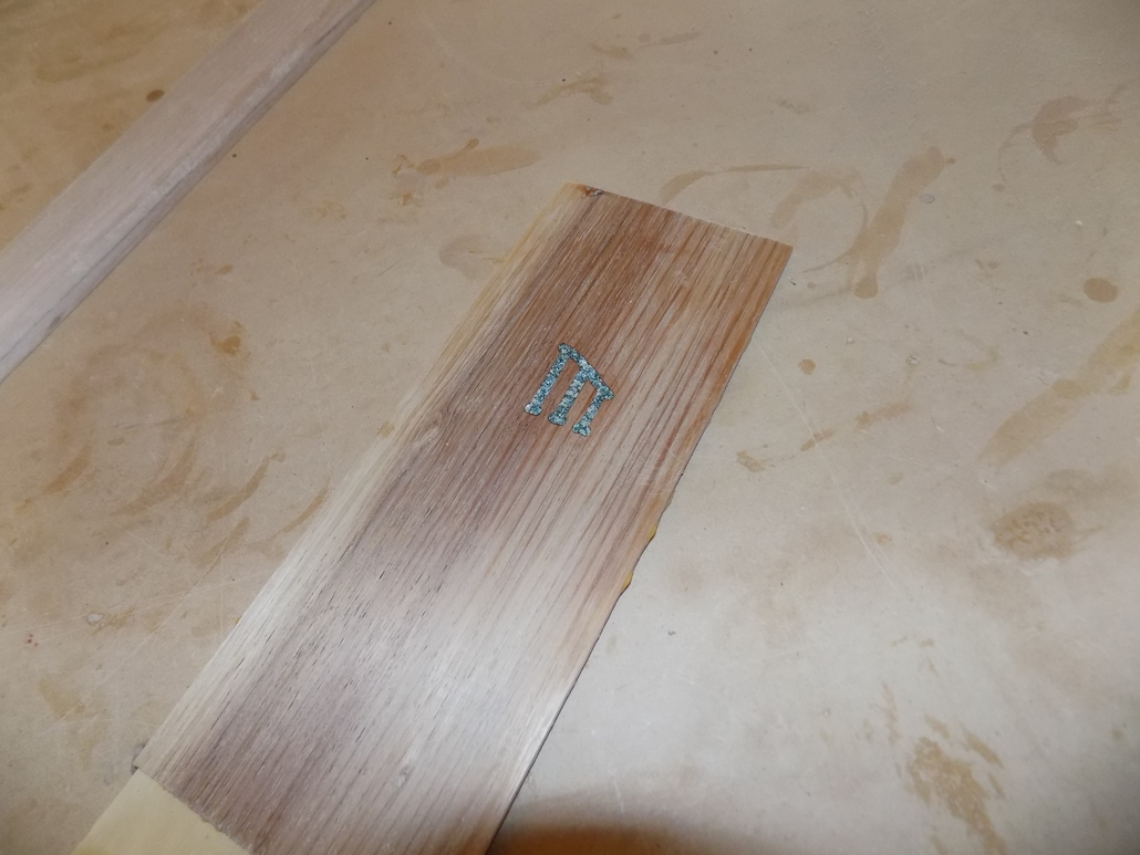

Headstock inlay

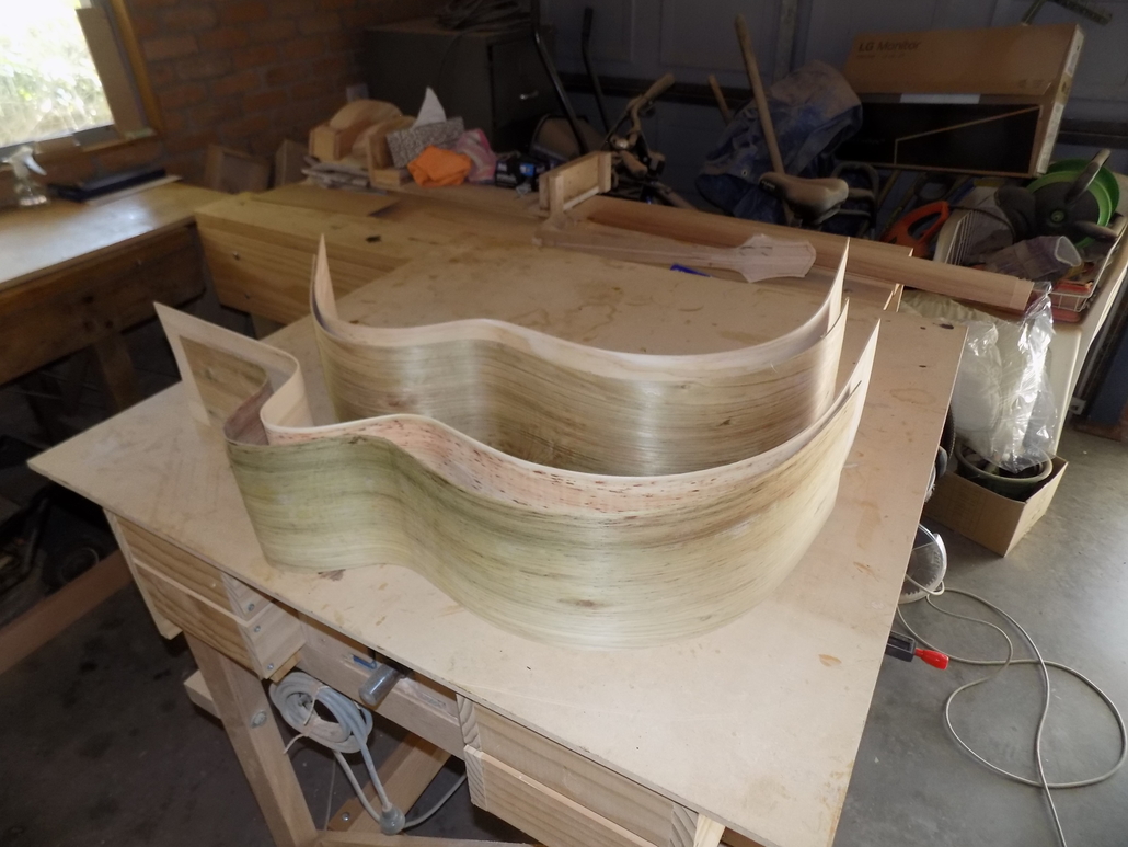

Sides milled

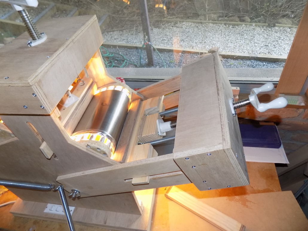

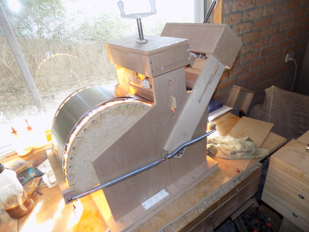

Bending the sides in a Fox bender
Bending the cutaway curve

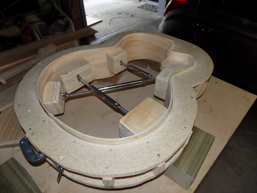

Sides bent, ready to be laminated

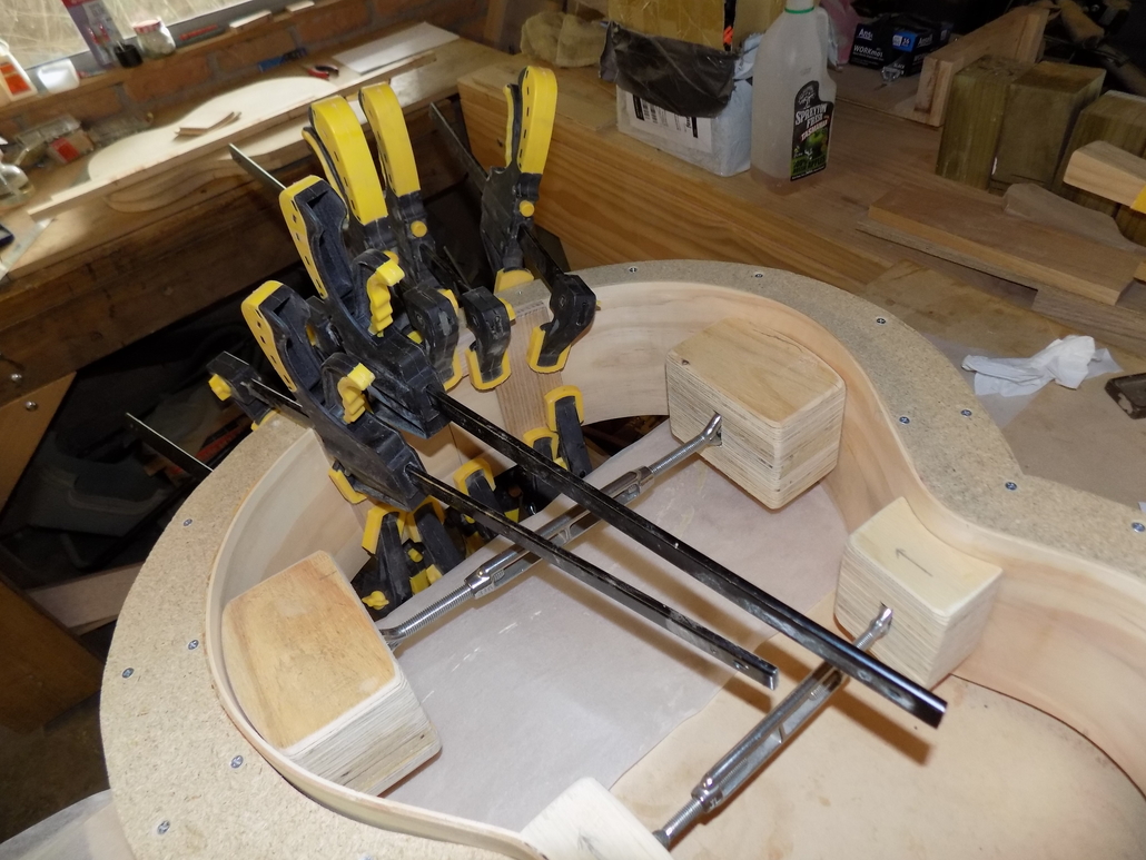

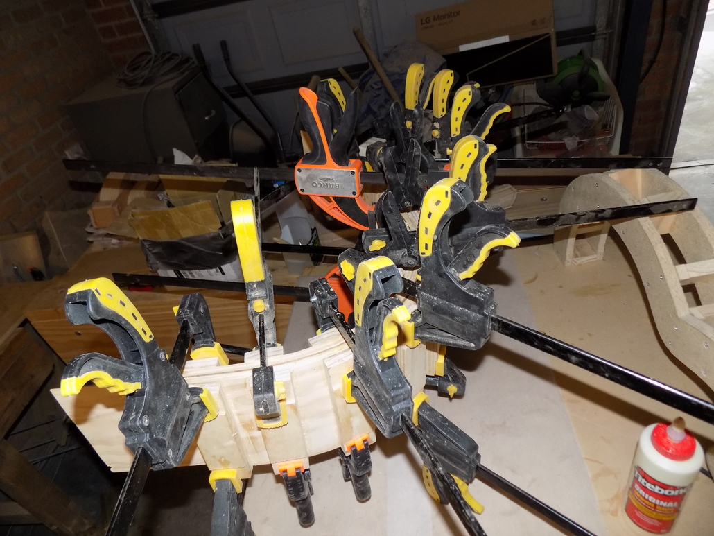

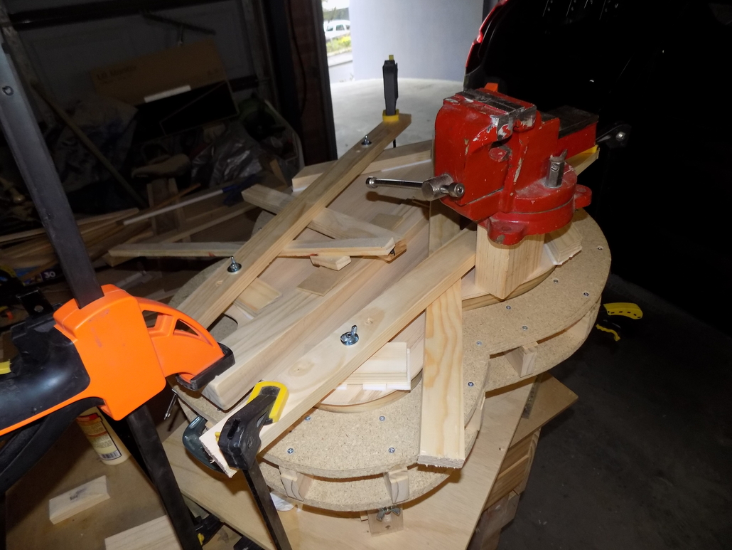

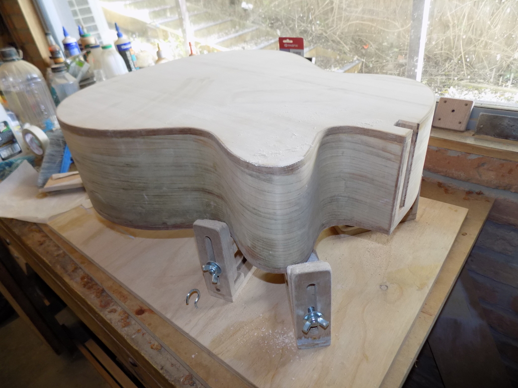

Laminating the sides
In the mold

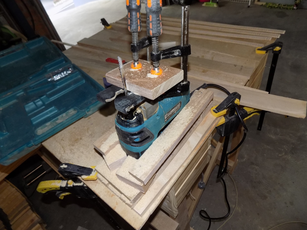

Jig for making kerfed linings. This is hazardous! Think I need a bandsaw!

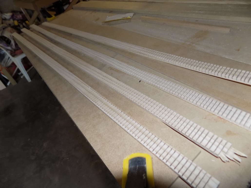

Kerfed linings

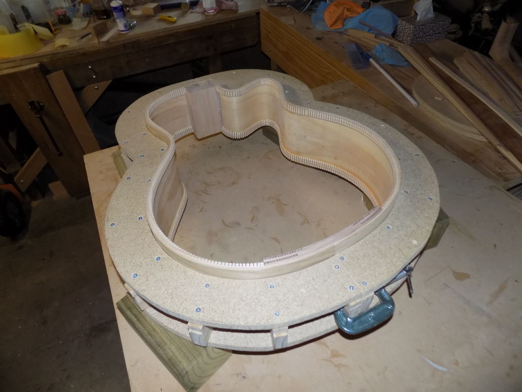

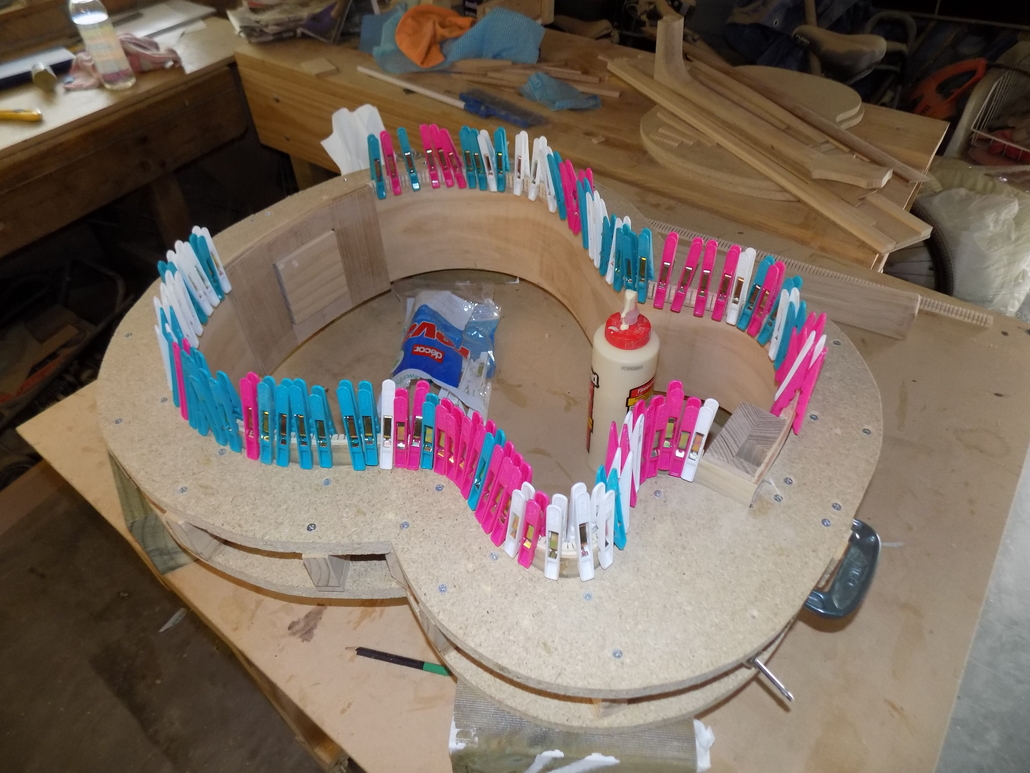

Gluing in the kerfed linings
Kerfed linings done

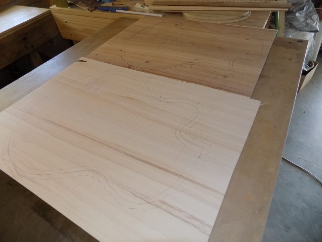

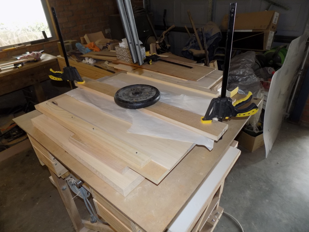

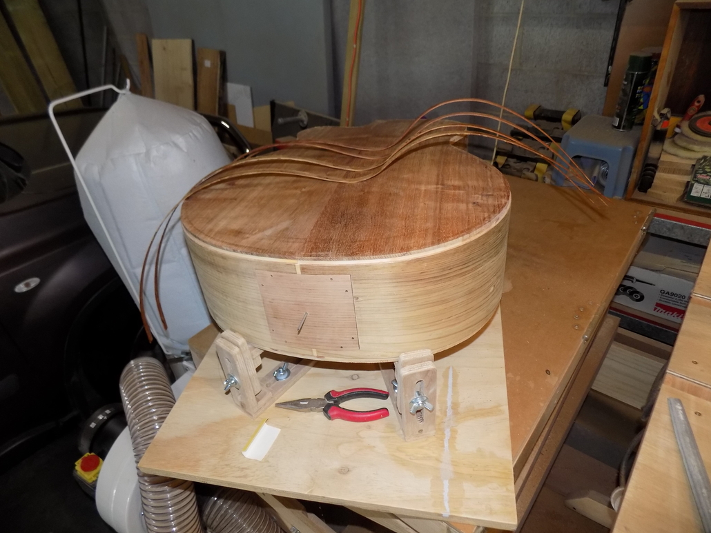

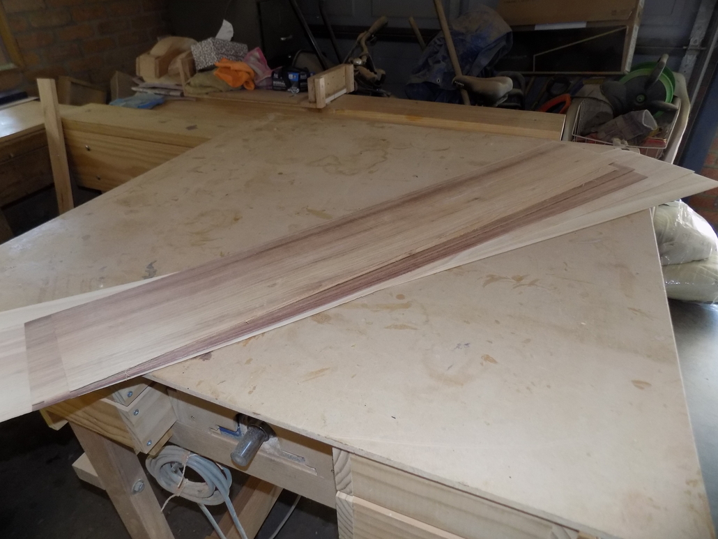

Butt-joining the book-matched pieces of the soundboard
Soundboard and back after butt-goining

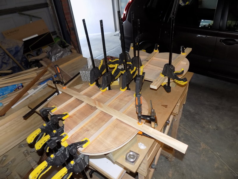

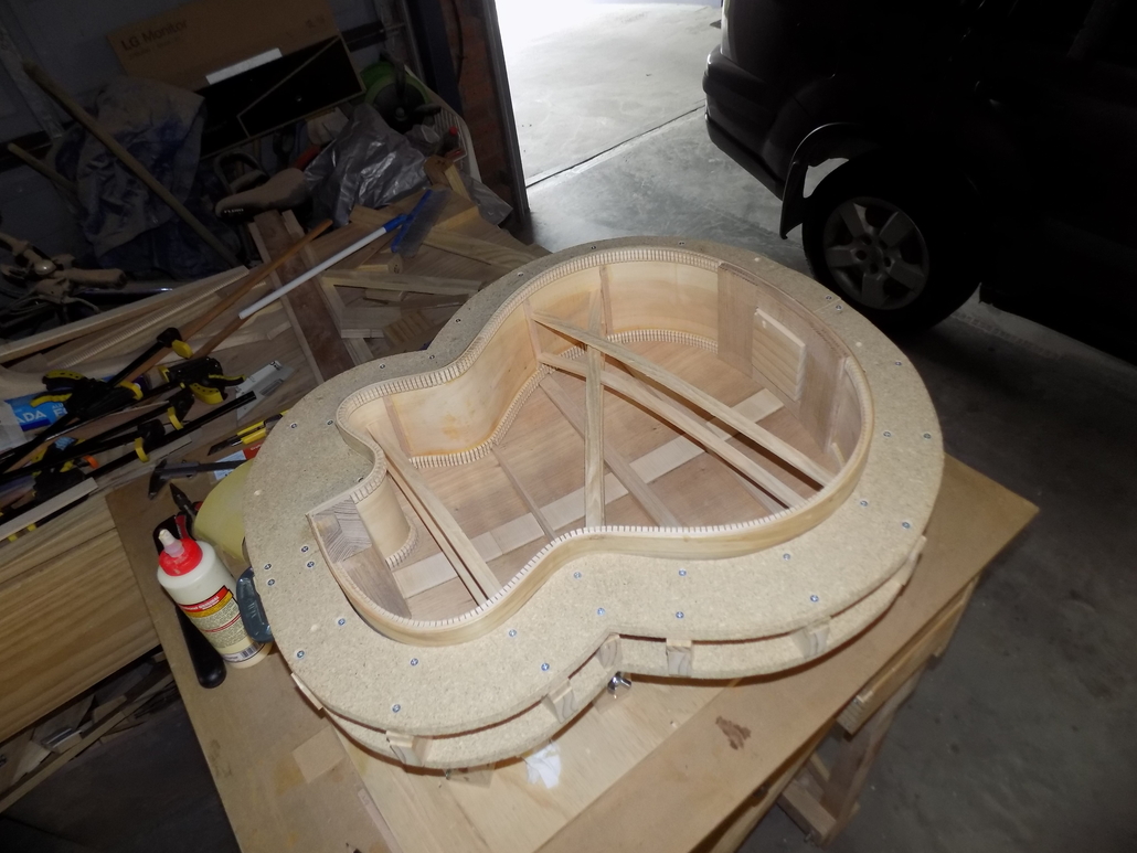

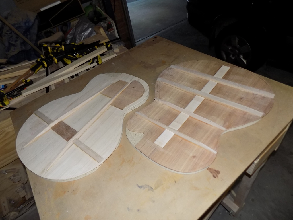

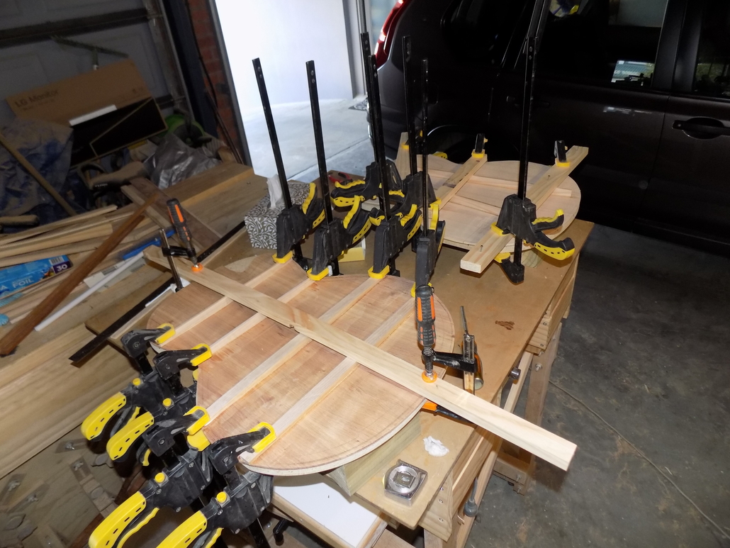

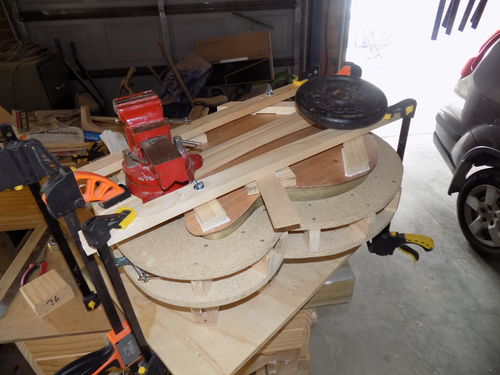

Glueing the bracing to the soundboard and back
Soundboard and back with bracing

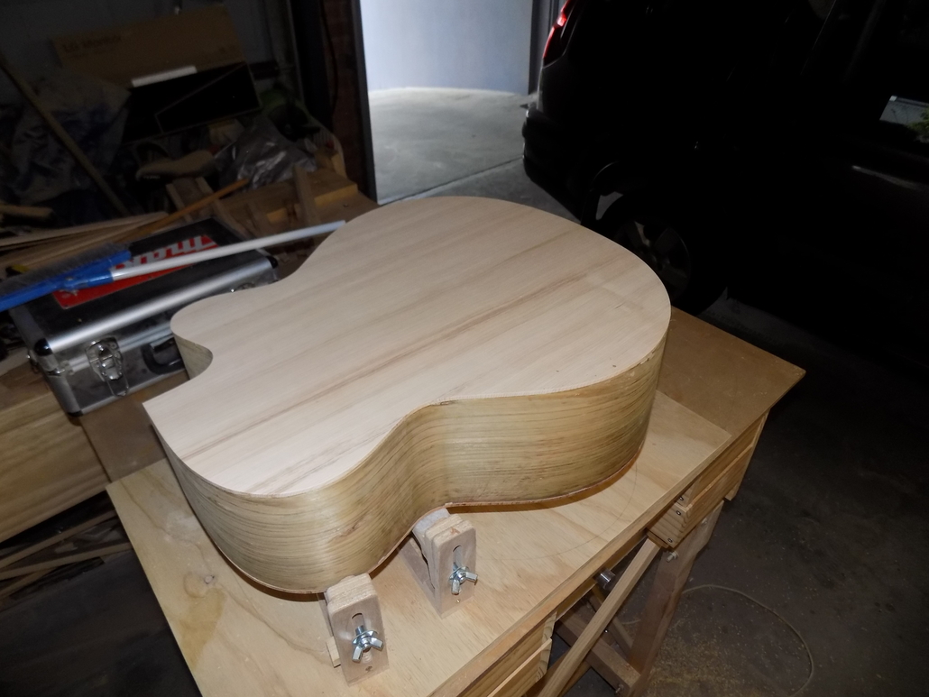

Attaching the back
Side braces

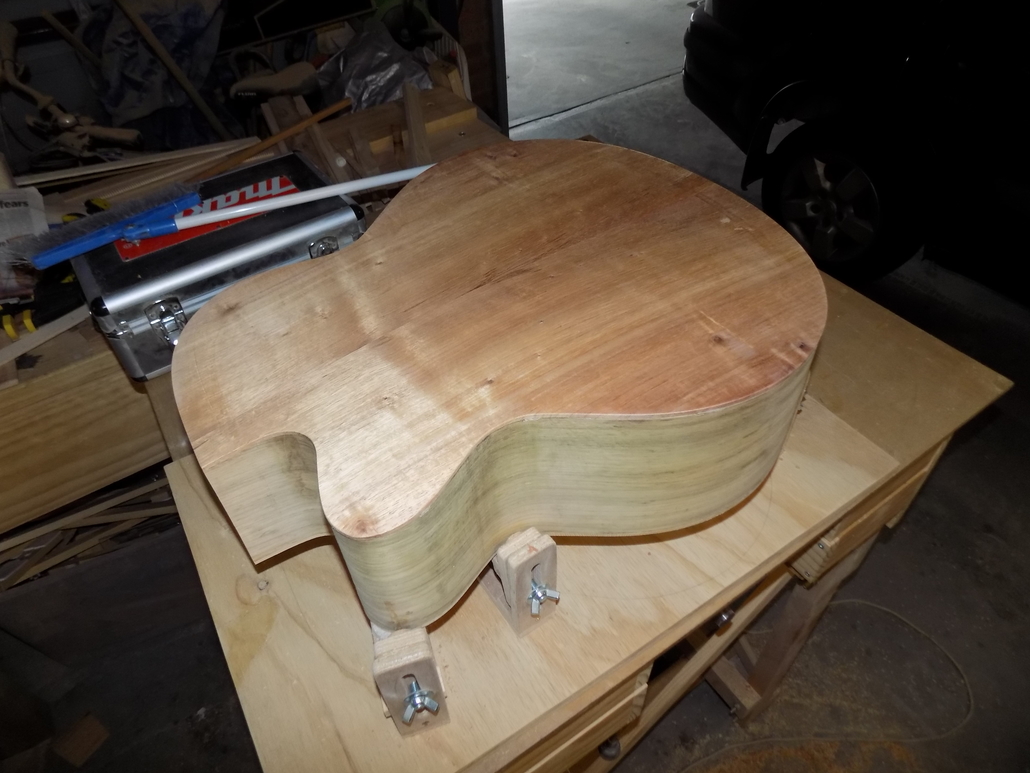

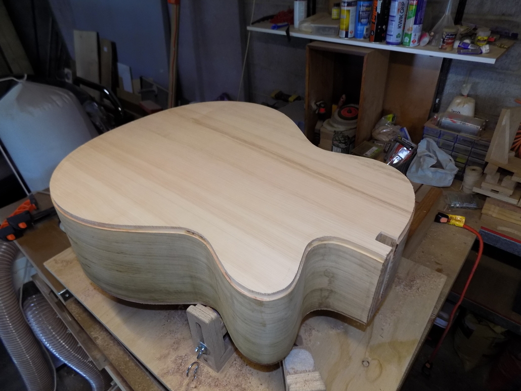

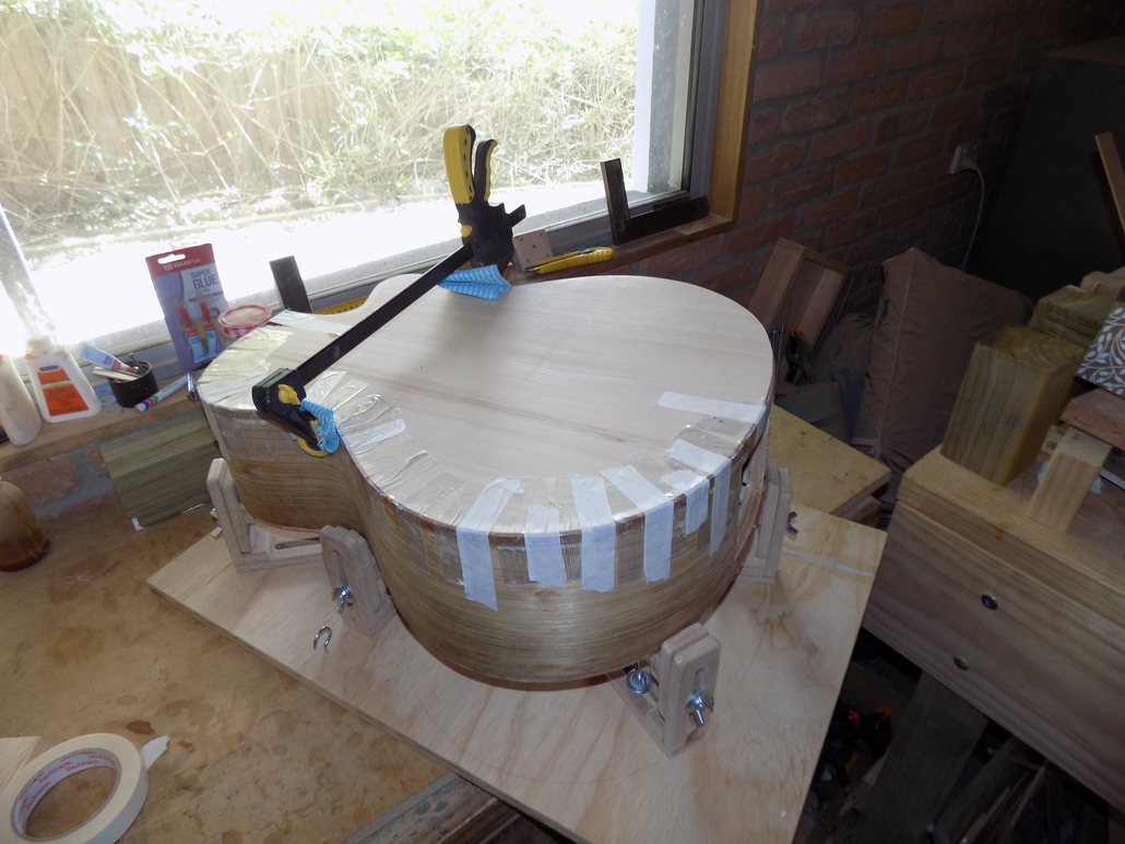

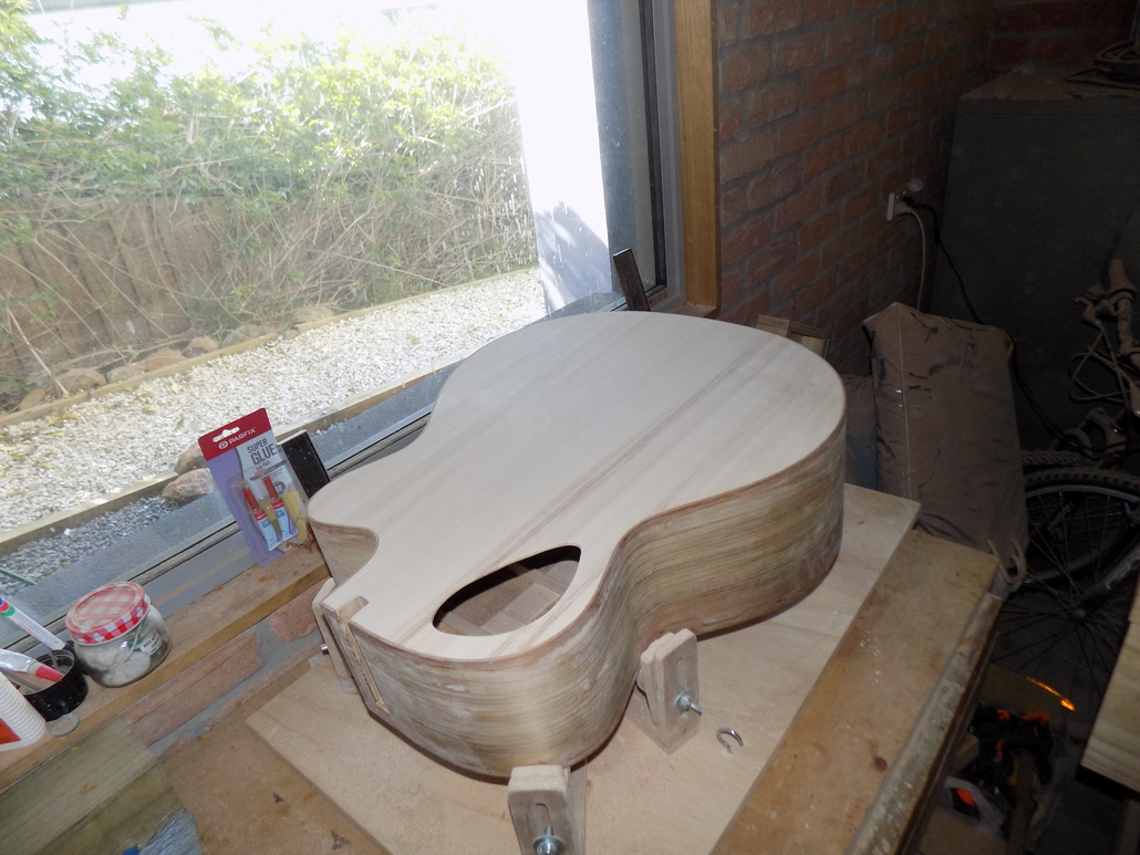

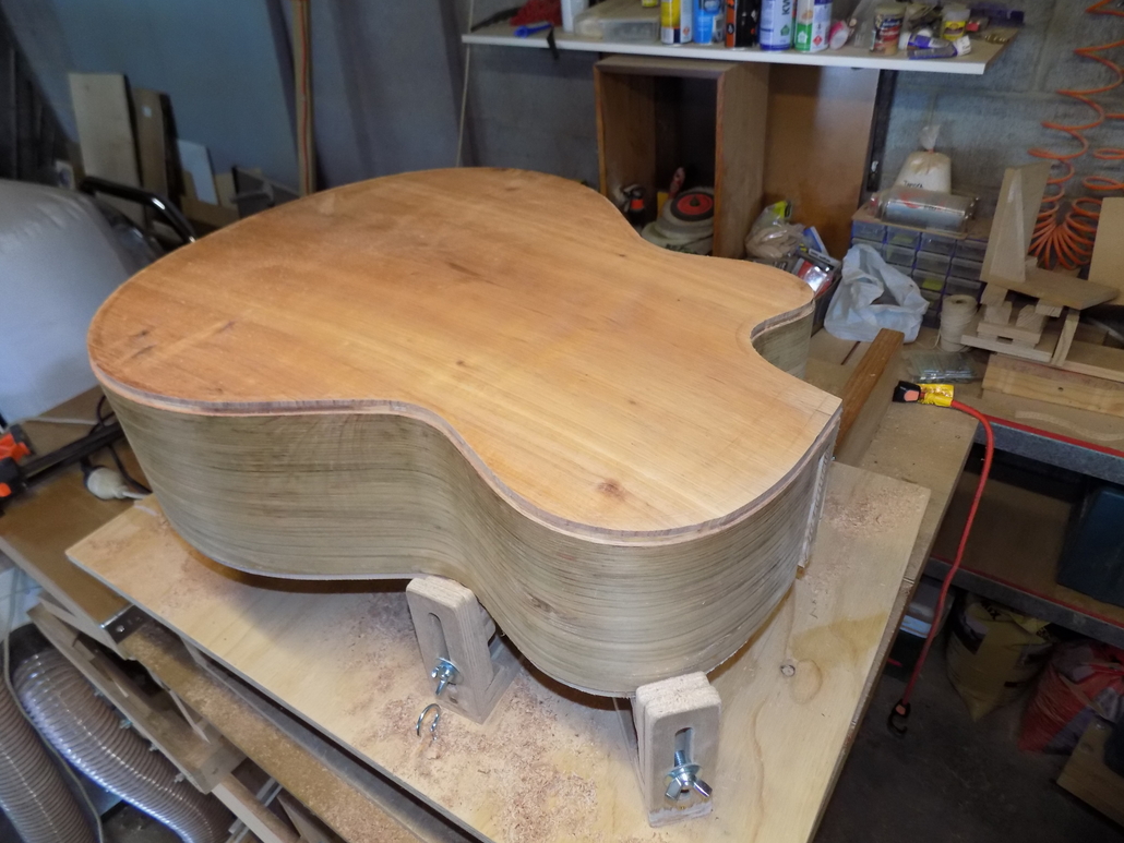

Attaching the soundboard
Soundboard attached
Back attached

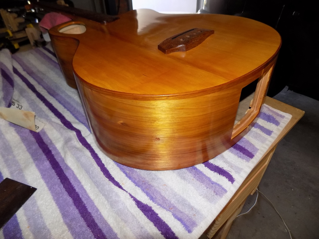

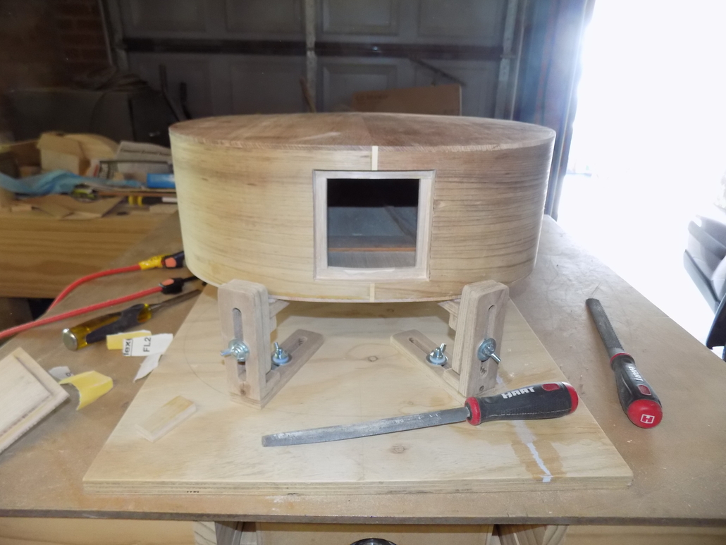

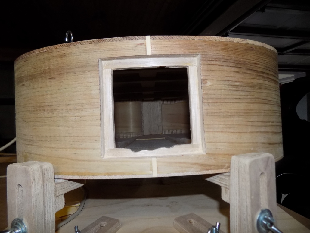

A disaster with the router opening the access port
Partial recovery from said disaster

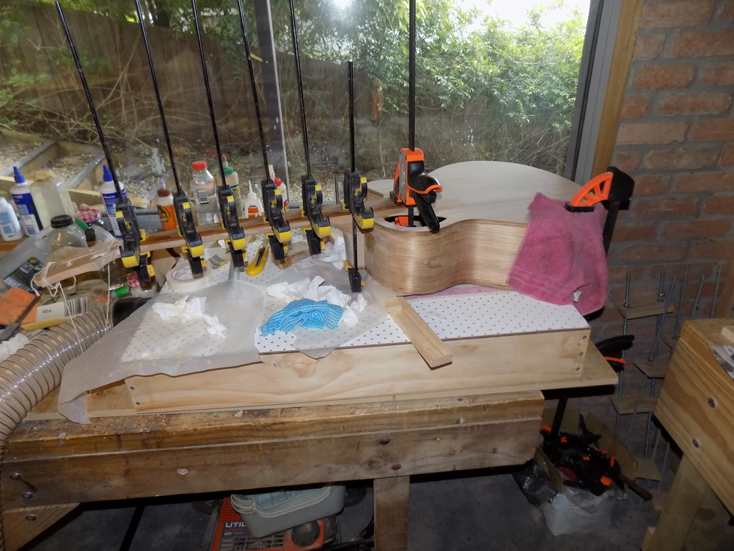

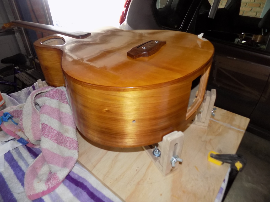

Soundhole cut
Shimmed and bevelled tongue for neck fit

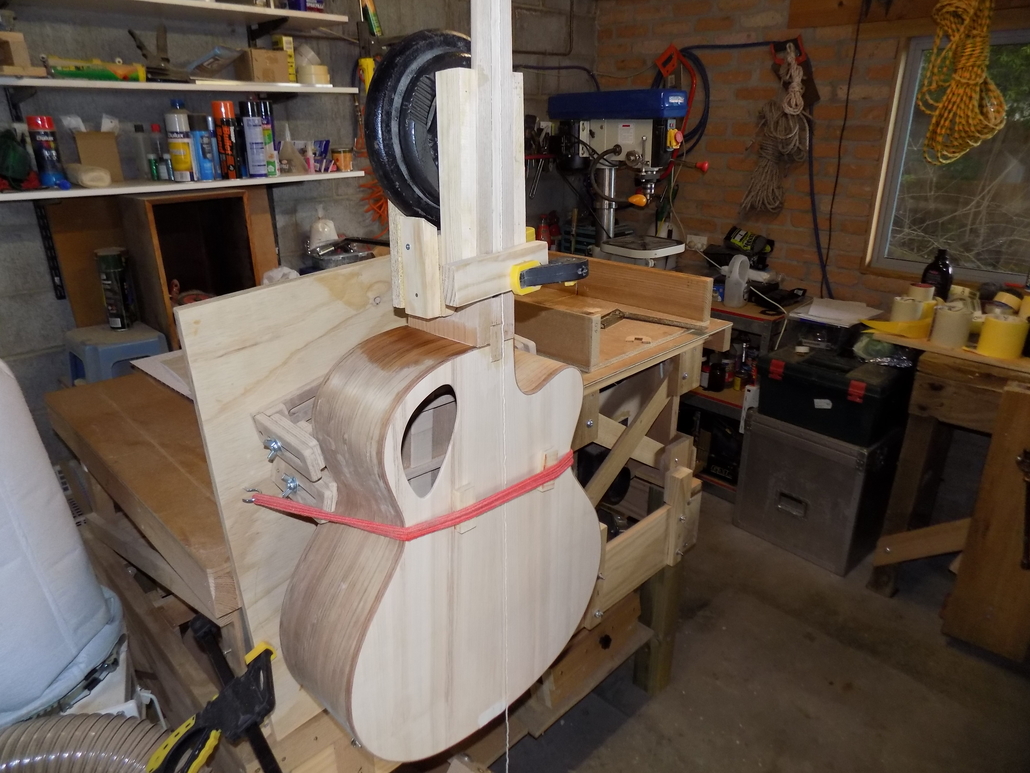

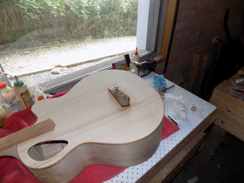

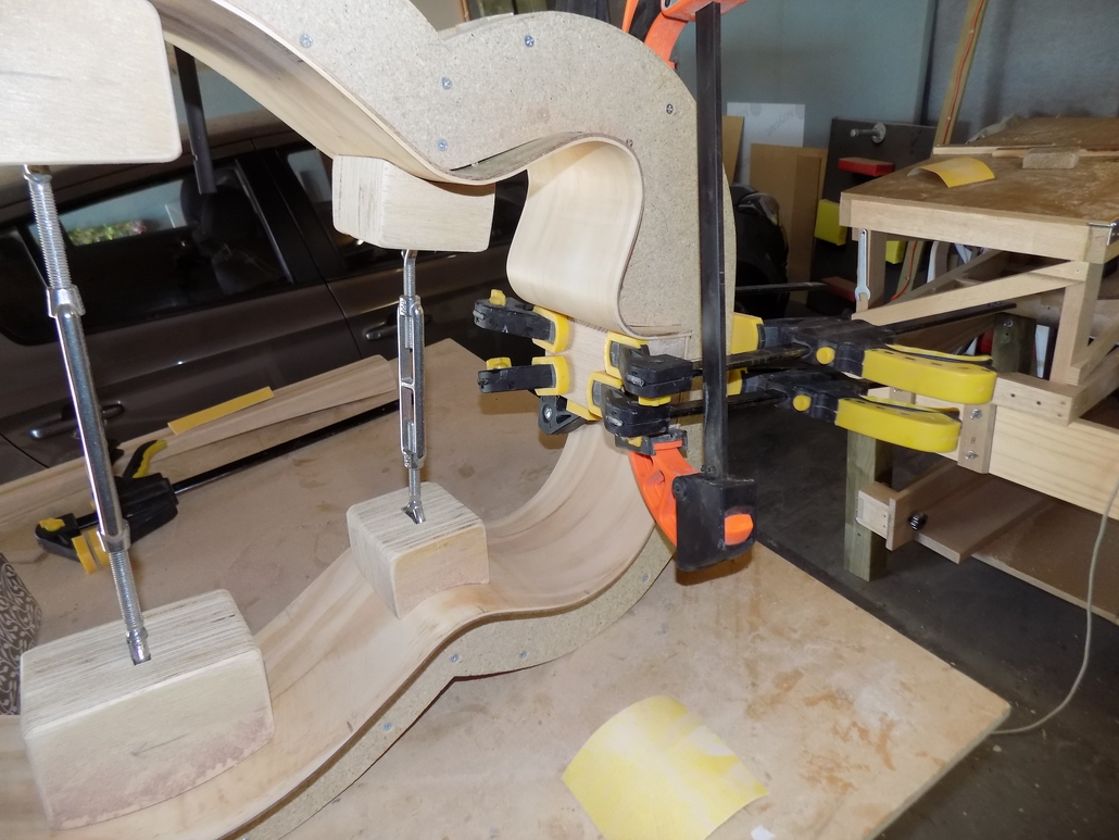

Gluing on the neck - gravity clamping - next time I think I'll use furniture-bolt clamping

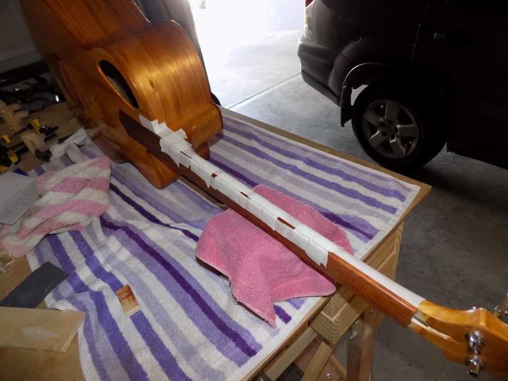

Trimming the fingerboard

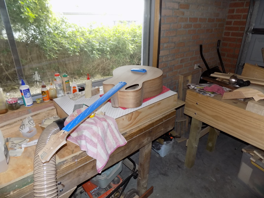

Gluing the fingerboard

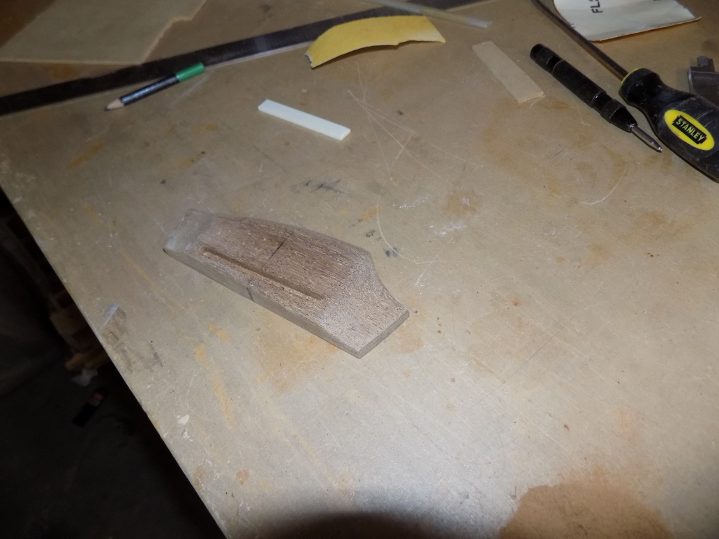

Shaping the bridge
Attaching the bridge

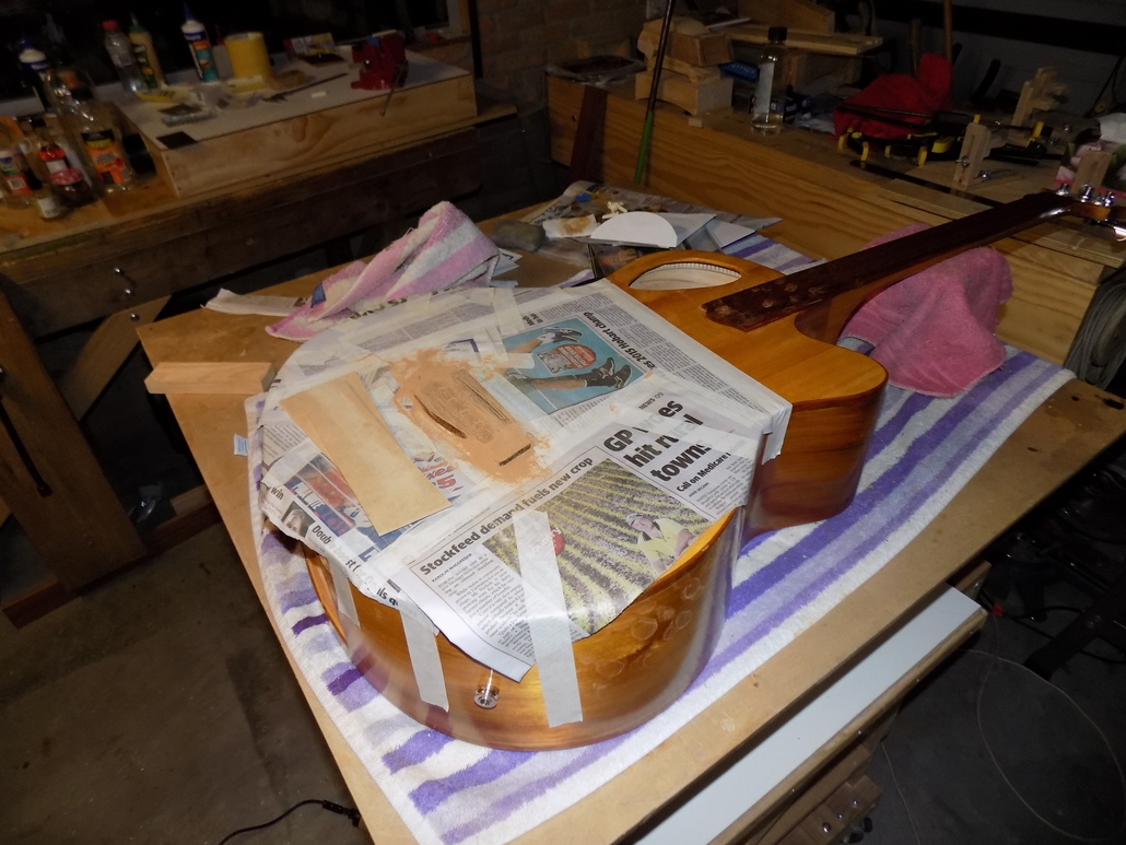

Taped up ready for finishing

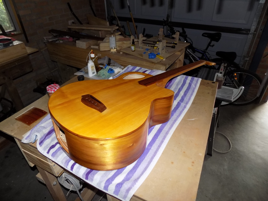

First round of French polishing

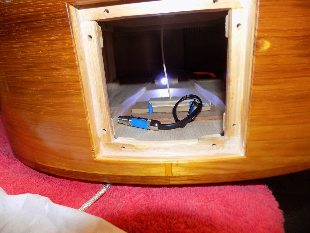

The most idiotic mistake yet - pickup jack on the wrong side...
Cover up
Gluing in the pickup

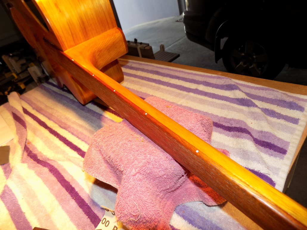

Drilling and supergluing the side marker dots
Side marker dots after cleaning up

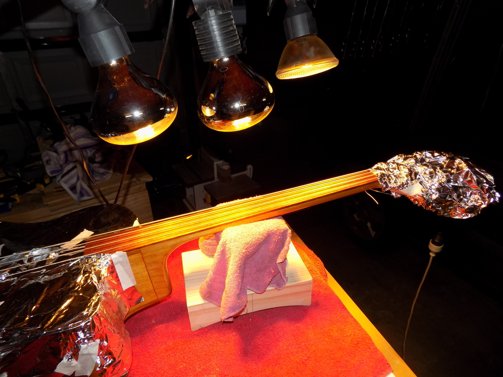

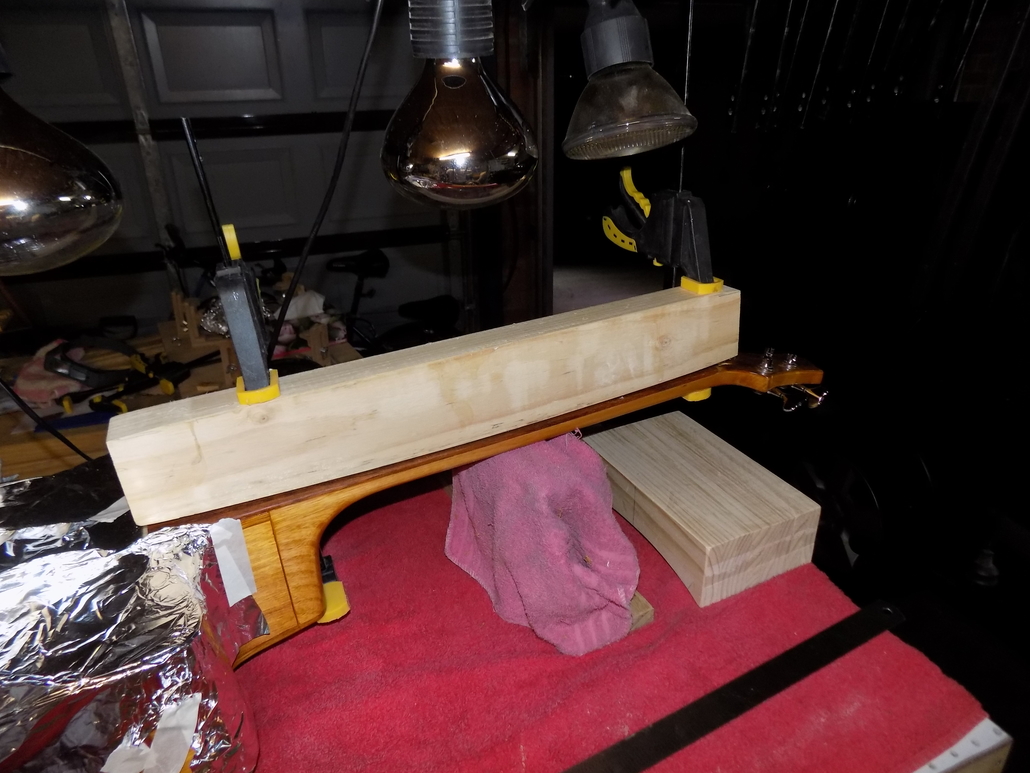

There was a tiny backbow in the neck, but because I used Tassie oak, string tension was not enough to draw it out. Here is how you are supposed to fix this.
Heat lamps and string tensions not nearly enough. Here is how I ended up getting any relief at all!
