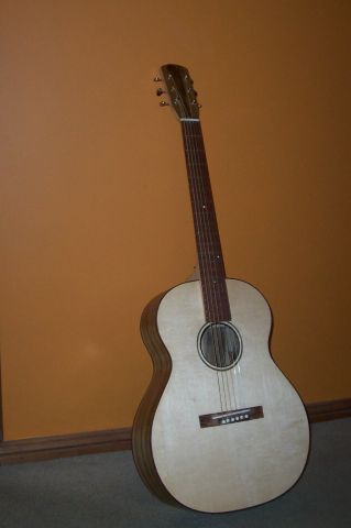

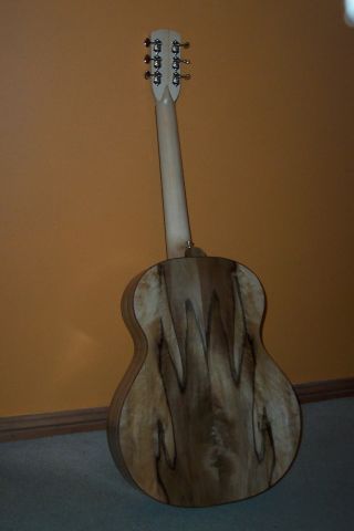

Hi guys, finally got my OM-S strung up
Still a bit of setup and finish repair etc to be done
Neck is feeling a bit chunky and will be reworked
Specs-
Blackheart Sassafras B&S
Lutz Spruce top
Celery Top Pine Neck
Cooktown Ironwood fretboard
Tiger Myrtle bridge and binding
Tru-oil finish
Tried a few different things with this-
Modified OM with rounded upper bout and very slightly rounded lower bout

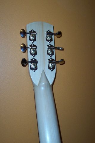

V- joint neck to headstock
Non adjustable neck with carbon fibre rod set towards the back of the neck.
Elevated cantilevered fingerboard extension
One bolt adjustable neck with the bolt integrated as a strap button.

Very nice Jeff.....
Got a couple of ?'s tho..is the celery top as white as it looks and what does it work like......Steve
Post by jeffhigh » Tue Sep 16, 2008 11:45 am
Yeah the Celery top is sitka spruce white with the occasional dark streak.
mine is finished in tru- oil with the birchwood casey sealer underneath which helps to keep the colour light
Works pretty easy except for the occasional pin knot and associated cranky grain.
This is from a couple of boards I got at the Newcastle wood show cut from the log on the day, this piece was nice and clear and perfectly quartered to the face.
When I looked up the wood properties it was listed as stiffer than mahogany so I thought I would give it a try for a different look without the weight of a hard maple.

Lovely work Jeff.
That Celery almost looks like Marble in the pics.
How are you finding the sound of the instrument?

Looks great Jeff,
Would like an update in a week or so when you have had a chance to play her hard, what your impressions are then of lutz for a soundboard. I also like the clean look of the celery top neck.

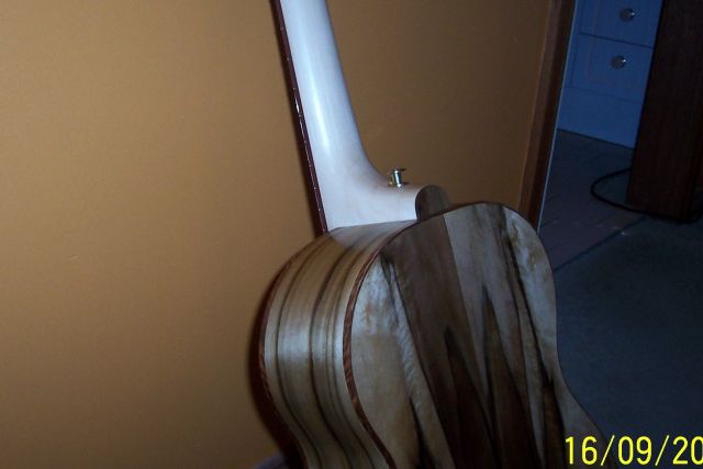

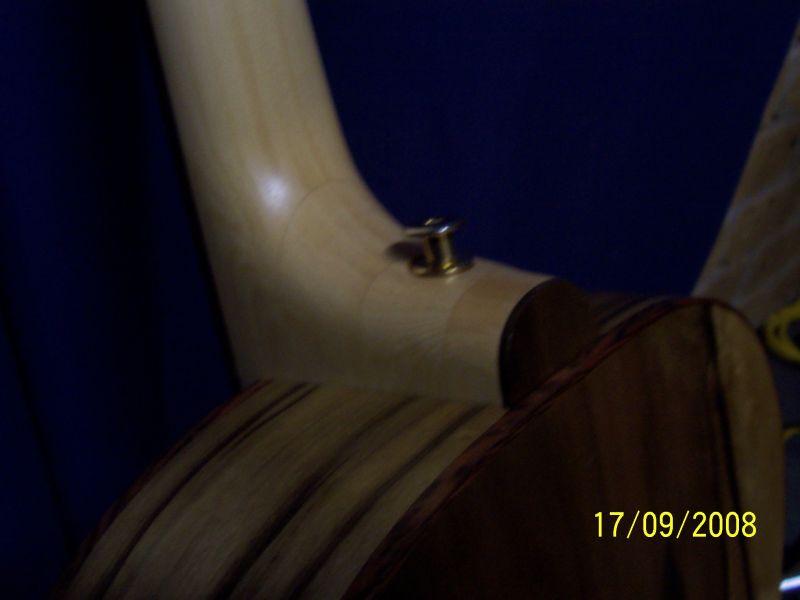

There looks to be some very nice work done on that Jeff. What made you try the style of head stock joint? Just the challenge of pulling it off so well? I really like the volute that you get with that style.
How about the adjustable neck? How did you go about the adjustment mechanism?
Posts: 1077
Post by Taffy Evans » Wed Sep 17, 2008 8:01 pm
Nice looking guitar Jeff certainly an eye catcher, looks great.
I've still got a bit to learn about some tone woods, who would have thought pine for a guitar neck. Could you tell me a bit about Lutz Spruce, I've only ever heard the name on the forum. People that play some of my guitars that are in the show cabinet, all have a different comments on the necks, some fall in love some dont like. It's hard to please every body.
Post by jeffhigh » Wed Sep 17, 2008 8:18 pm
Hi Allen, thanks for the kind words.
I just really liked the look and concept of the v- joint as opposed to a scarf joint and did not want to do a one piece again like I did on my LP Junior.
The neck joint is REALLY simple.

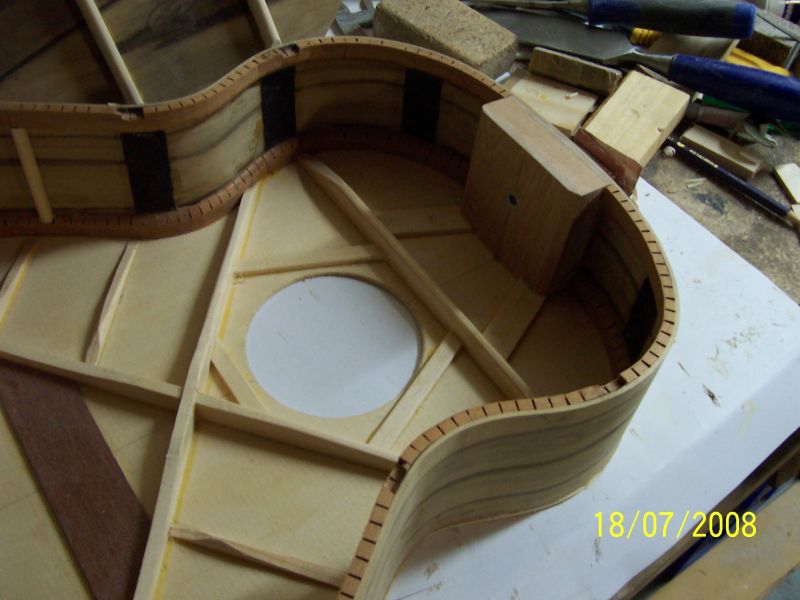

I considered a lot of options, wanted external rather than trru the soundhole adjustment, and in the end went for a sort of Stauffer arangement but with furniture assembly bits from bunnings.
The neck block has a coarse threaded insert screwed in from the inside.
There is a 5-6mm deep neck heel shaped recess in the outside, no tennon etc just a flat surface.
The bolt/ Strap peg is a stack of flat head bolt, brass sleeve, drilled out sleeve nut inserted into neck heel from the outside.
No captive bolt or spring or washers.
The neck just bears on a strip of 3mmx1mm carbon fibre resting part on the top endgrain part on the neck block. yaw adjustment by filing.
There are diagonal braces glued to the underside of the soundboard to support the neckblock.
It takes a lot of pull to displace the neck backwards against string tension.
Havent got any neck pocket pics but will do next string change

Do you have photos and documentation for the adjustable neck joint? I'd love to see what you did, then hear your engineering thoughts as well as your thoughts now that you can test it out. Please add it it to the Adjustable Neck thread.
