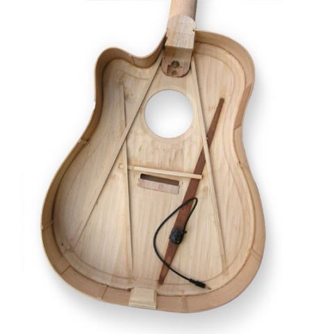

im jake, in year eleven and am going for my first build in my major work for year 12. i aspire to make something similar to the cole clark fl1a. can anyone help me out with the different processes cole clark use? or any general info?

Well you're going to need plans, so look through these
http://www.grellier.fr/plans.php?lang=en..... they're free and might suit you
better than trying to copy the Cole Clark.......Steve

I'd get the book by Jim Williams if you want to build a steel string in the spanish heel method.

The guitar youve chosen to copy is maybe not a good choice for a number of reasons. The design is a bit radical in some areas and youd really want to get some specs from Cole Clark on same if youre going to copy them and have them work. The bracing for example is not standard and the face brace pickup is a patented product which would be impossible to duplicate without authority (and assistance) from Cole Clark. There are a few things I dont like very much looking at the pics of the internals of the guitar in question.....theres no bridge plate for example.
I always advise people making their first acoustic to stick with a conventional design and either start with a kit or a set method from one of the many books that are on the market.
Jim William's book is a good start if youre happy building a steel string using the Spanish Method (neck and top one integral unit, ie no neck joint). My first guitar (an OM flat top) was built largely using Jims method.
If you want to build with a neck/body joint then Campiano's book is a good start but make sure you read his website notes as hes updated some of his methods and philosophies since the book first came out.

jmuller92 wrote:hey everyone,

The Cole clark guitars sure look nice but to replicate one it would be fairly difficult because they use alot of CNC machining, especially on the inside on the back of the guitar. Next time you see one look at the inside of the guitar and compare it with another brand like Maton or Ashton and you will see a difference in the bracing and the carved out sections on the cole clark's as opposed to a flatter looking surface from a normal guitar.

ok so i have never actually played a cole clark and it was more the look that i was going for to clear all that up. im not overambitious and i understand that it would be something major to pull of something that hasn't really been publicised. im a hard worker and passionate about guitars so i think thats going to be what helps me get through.
