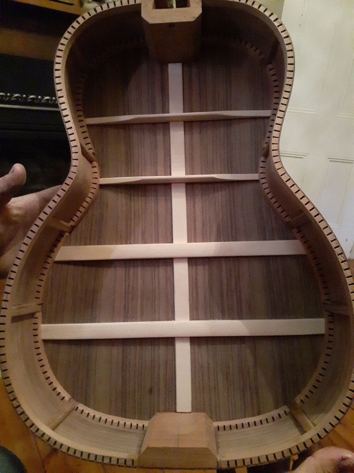

Re: Applying G&G techniques to a kit guitar
Might as well turn this into a build thread to keep me honest.
Back and sides - sorry I forgot I did follow G&G here with reversed kerfings and largish side splints.
And the top getting braced up. Just followed the 000 plans to a tee.

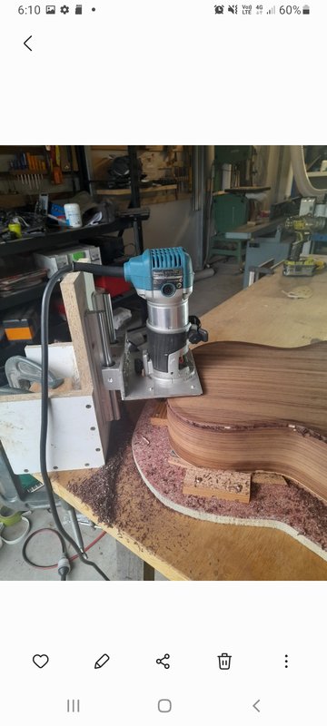

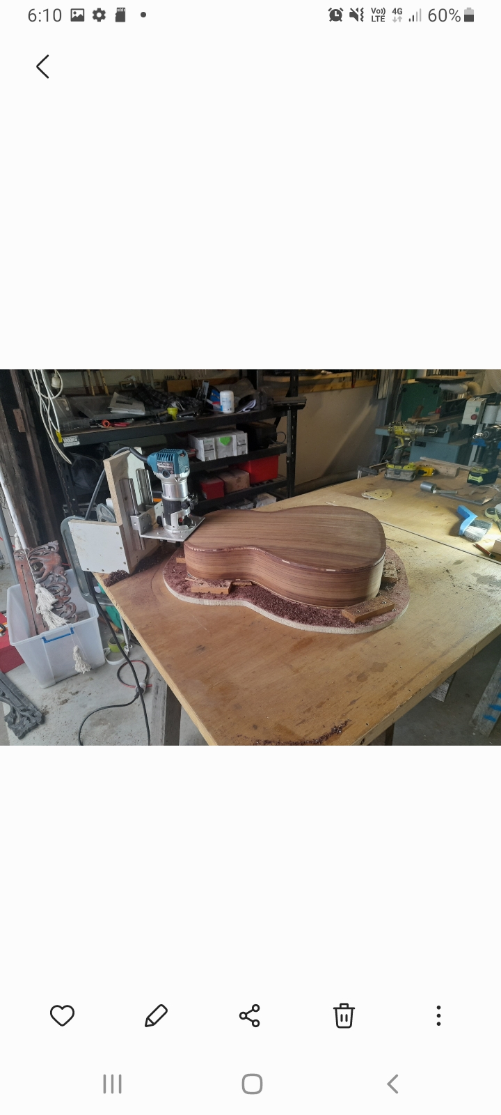

After a wild 2 years, I finally got back into it this afternoon.
Binding and purfling channels routed with no epic disasters. All I could hope for!
Sorry the photos got a bit weird, I've put them in below as screenshots instead.
Ta, Steve
Ta, Steve

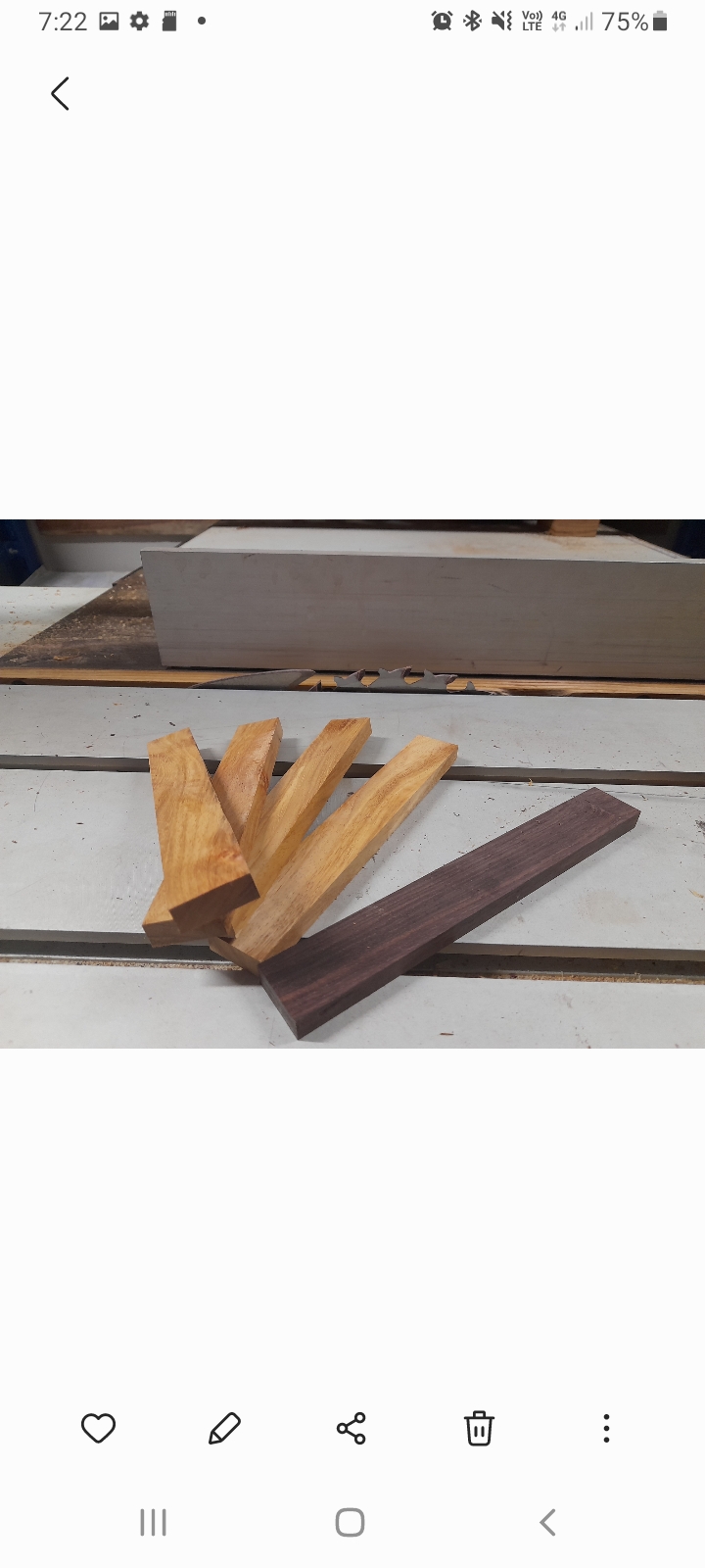

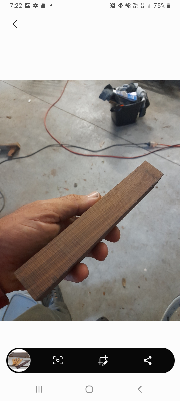

Well thanks to the confidence you've inspired in my desire for old school aesthetics, I rummaged under my house and found my 'special' scrap milk crate among the 20 other crates of offcuts I've hoarded, from which I found a nice 30 x 35 chunk of quarter sawn rosewood.
Off to deep dive into the long history of Martin's pyramid bridges for some inspiration!
A question to the brains trust, to rout the saddle slot now, or wait till it's been glued on? I can see merit in both ways....... not sure which way I'll go.
Cheers, Steve
I departed Gore and Gilet's recommendations for hand tools, turned on my jointer and panel saw and 5 minutes later had a rosewood blank 25x10 mm dead square and dressed, along with a few spare scrap blanks to test my machining setups.Off to deep dive into the long history of Martin's pyramid bridges for some inspiration!
Cheers, Steve

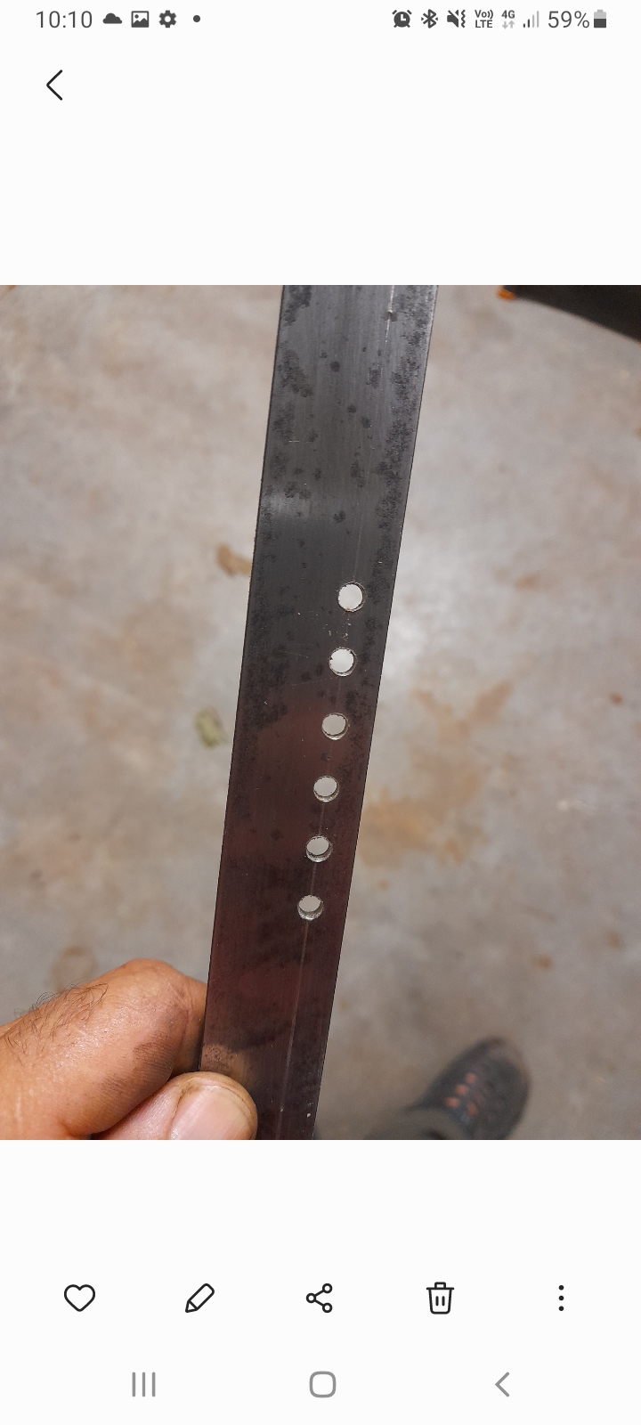

More good ideas from the books!
I've always struggled with accurate marking out and drilling etc, so instead tried to make a drill guide from 25mm bar steel.
Wow, so much easier than working with timber! Highly recommended strategy for bridge pin layout and drilling, even without the need for avoiding braces etc as described for the more modern bracing designs.
Thanks!
Thanks!
