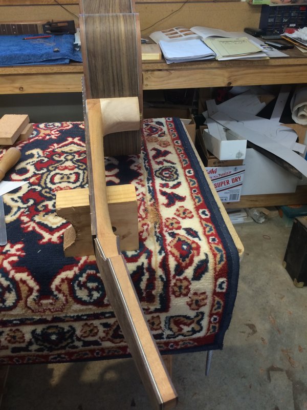

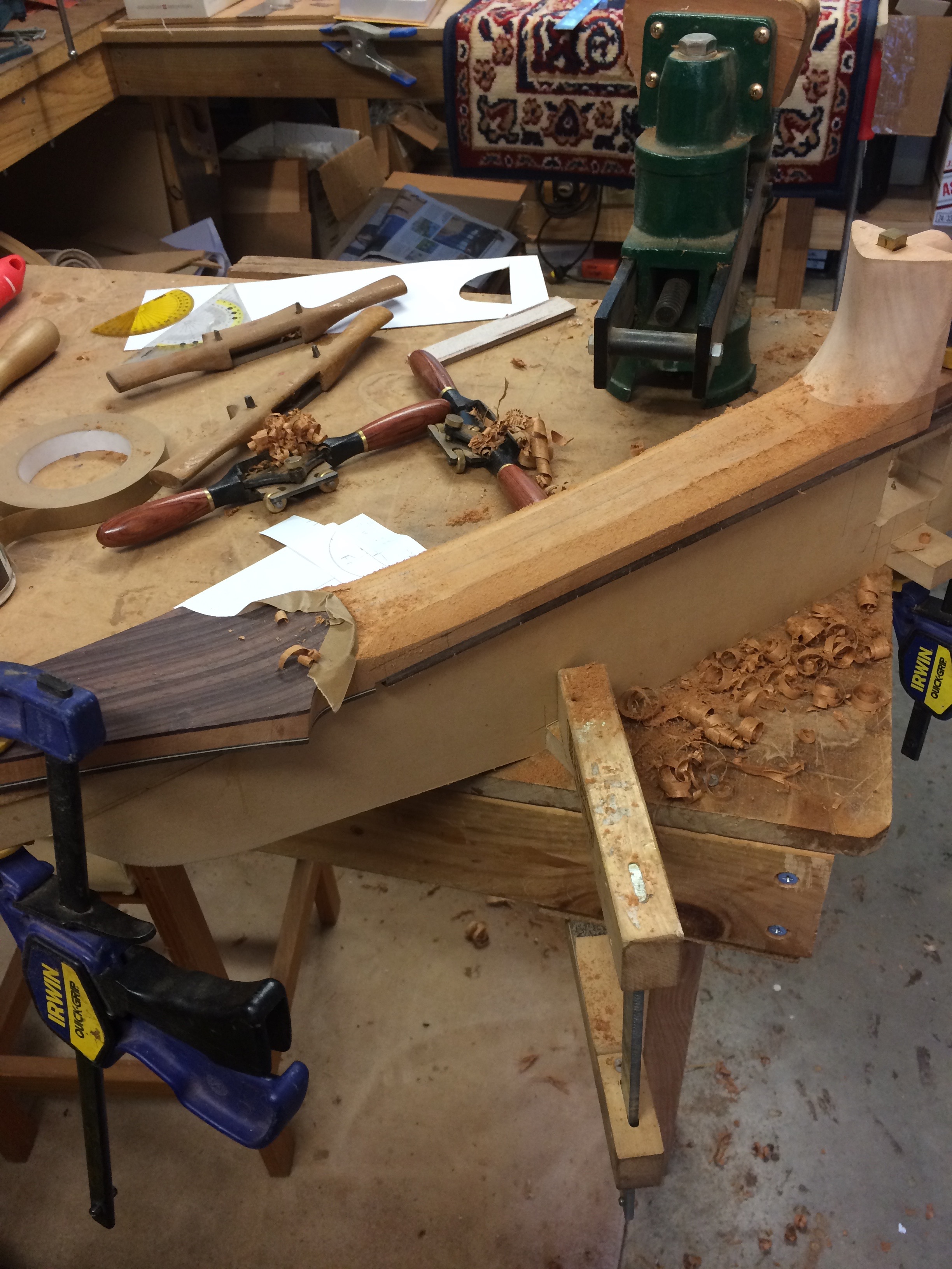

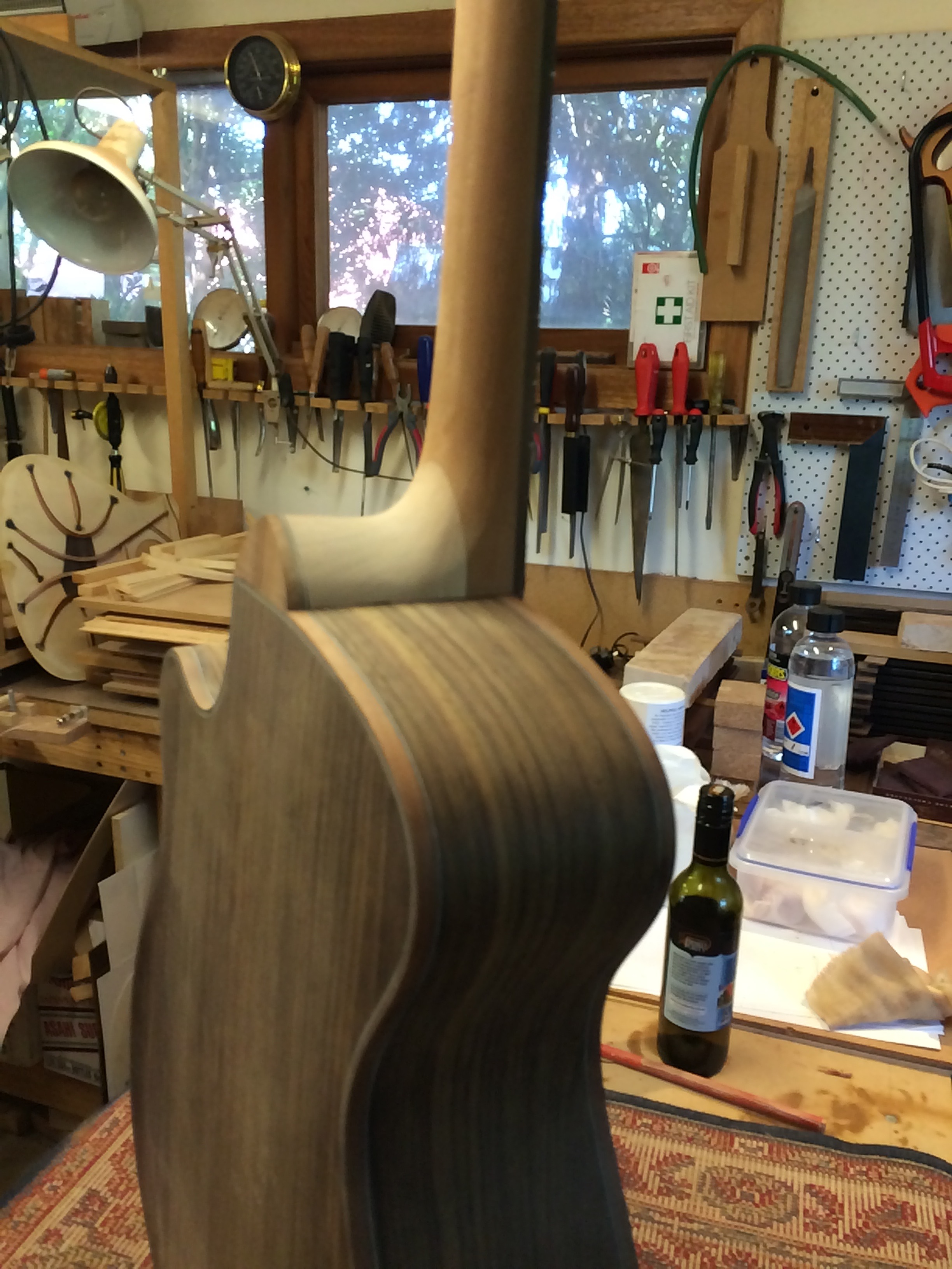

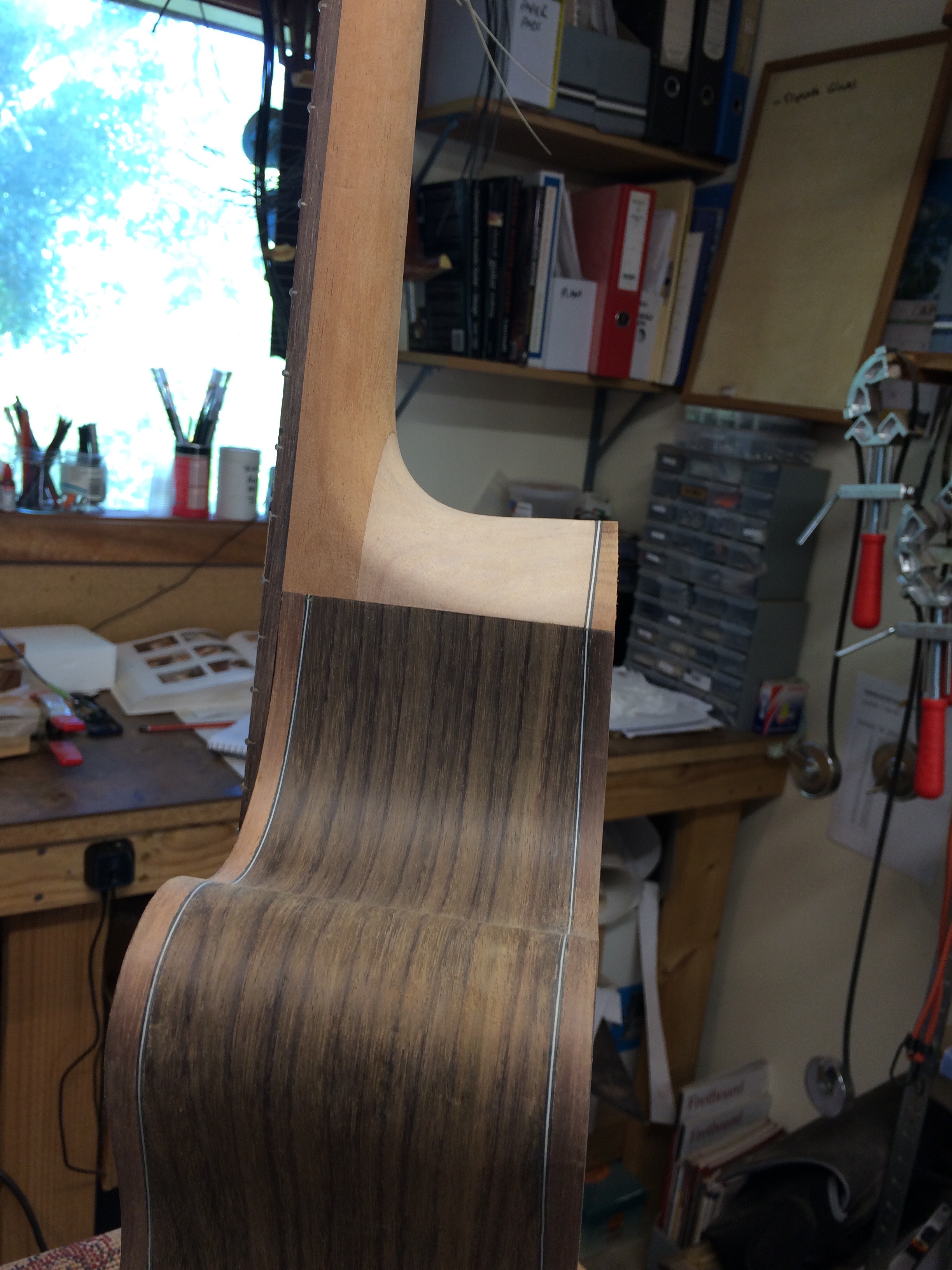

A few pics of the neck shaping process on my last G squared build.

Rod and Martin thanks for that. Don't know what was wrong with me to cause such a brain fade - I have successfully done many other necks. Anyway I am now happily carving away.
Martin thanks for taking the trouble to load some photos. very Helpful
