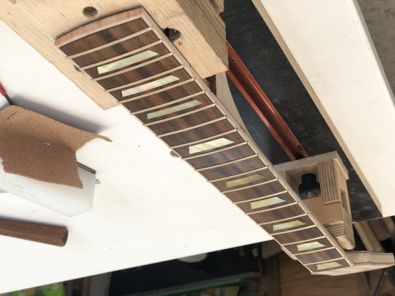

I have a buyer that wants all Australian wood. I have been collecting some spotted gum to play with but I don't know if I can trust it for a fingerboard on a steel string. Has anyone had long term good results with it?
