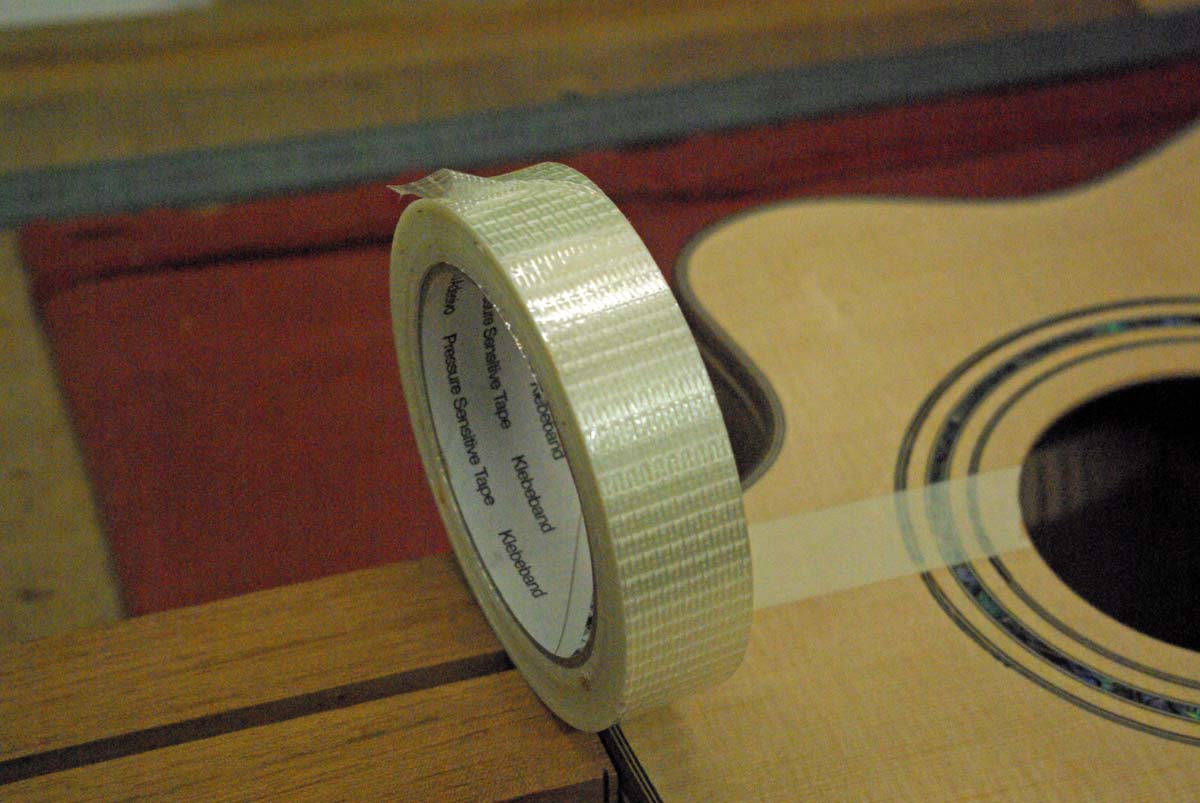

I use the pretty standard tape from 3 M. I am in the UK but I'm sure it will be available in Oz. Having recently bound the guitar in the pic it is probably the best I have done so far because the bindings were bent accurately. This I think is key.
Unlike Martin I have had issues with some Engelmann spruce losing fibres but I think that was me being impatient. This one is Sitka and the tape came away cleanly.

Trevor Gore
Posts: 1642
Re: packaging tape for binding
Post by Trevor Gore » Wed Nov 20, 2019 9:45 am
blackalex1952 wrote:
Mon Nov 18, 2019 3:50 pm
I am looking for a source of the reinforced packaging tape to use for binding work...any recommendations? What are you using and do you find that the tape is strong enough by itself or do you still bind with stretchy cord or rubber as well? Cheers! Ross
I use the two-way filament tape from these guys who happen to be just down the road from me:
https://www.getpacked.com.au/c/adhesive-tapes/12 - (near the bottom of the first page, available in a variety of widths - the narrow stuff being good for cutaways, etc.)
The two-way tape is easier to get off as the cross filaments hold the long filaments together. Use a good, heavy tape dispenser with a serrated cutting edge (or pre-cut prior to use). There is no need for anything other than the tape. Shellac first.
