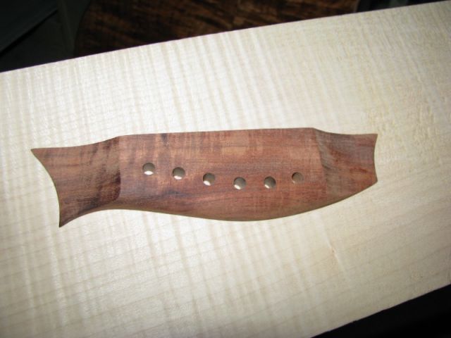

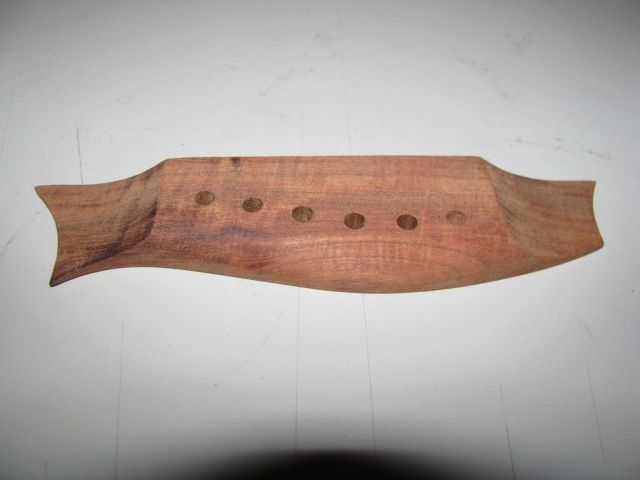

It's definitely Blackwood. Just bloody hard, dense and heavy Blackwood.
The supplier I get them from knows his wood fairly well and I've got a heap of other desert acacias from him.
I built some bridges out of all these different woods a while back.
The Tassie blackwood weighed in at 21 grams. Queensland Blackwood 38 grams.
I re-designed our bridges, making them narrower with this in mind because I want to use the local wood but I also like a bridge weight of 27-28 grams for most guitars.
Most of the other desert acacias I've messed about with (Acacia harpophylla(Brigalow), Acacia Exelsa(ironwood),Mulga and the like come in at about the same weight.

Here they are.

It would be interesting to know which bit of Queensland it comes from. Looking at your bridge pin holes, I was wondering if you notice any difference string to string from the different break angles over the saddle?
(though I have just realized that that is a left handed bridge?)

I'll see if I can find out Graham.
