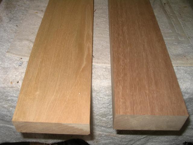

Post by Bob Connor » Sun Sep 07, 2008 6:04 pm
Here's a pic of Mahogany and Queensland Maple.
