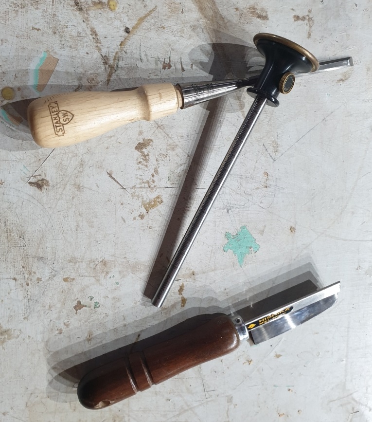

Sure, here's my jig -
Works a treat, takes about 5mins to do 6 notches.
