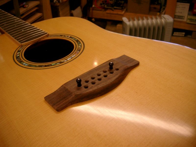

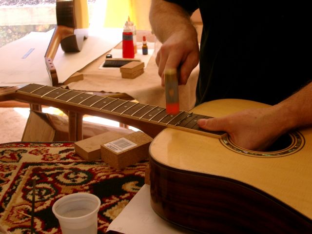

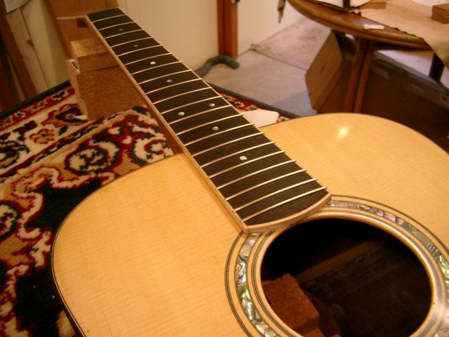

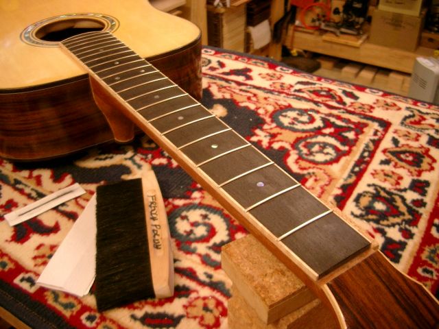

Finally got an hour in the workshop today and managed to get fretboard markers glued in. Also got the bridge roughed out and pin holes drilled. Dots are 5mm paua jobs and theyre glued in with 5 minute epoxy coloured up with ebony dust. The bridge isnt glued on yet...I stuck it on the top just to see how it would look. The bridge is based on a Martin 12 string bridge. A bit on the chunky side and nowhere near as stylish as the one on Craig's masterpiece but one day.......

That's looking great Martin . Your binding around the fretboard looks very sylish and gives a nice tailored look to it . I'm fond of the rosette too . My Mahogany 6 string has one similar with the wider type paua ring ,and I have found a lot of folks comment on it.
Looks like it's not far to go now mate . I'll bet your getting excited about how she will sound . Stringing up a six string for the first time , as we know, is pretty exciting stuff , but you wait till you string up a 12 !!!
Great work mate

Yes Martin she looks sweet. I really like the over all look of this one, very well balanced, and the silk in that top is enormous.

Thanks for the positive reinforcement guys.
Kim..the top is some of Shane Neiffer's classy Lutz....I really love the stuff. Ive got some nice Sitka and Englemann in the shop but the Lutz is something special.
Craig....my efforts cant really be compared to your work of art. Always good to have something to aspire to though.

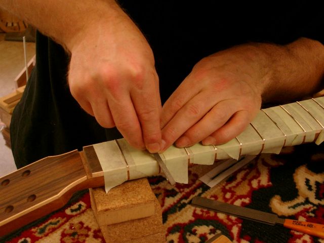

A few more hours in the shop today and I bit the bullet and whacked the frets in on the 12 string.

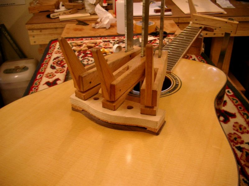

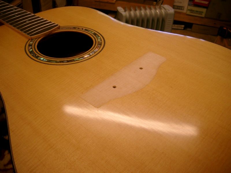

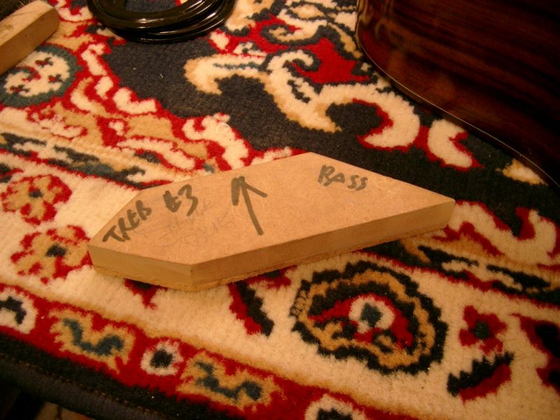

Post by kiwigeo » Fri Sep 19, 2008 5:12 pm

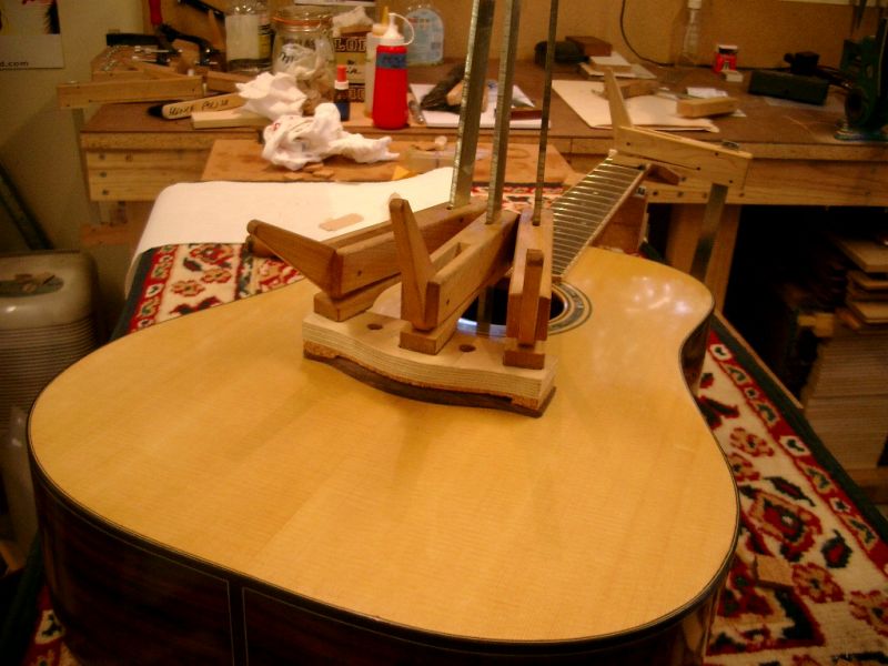

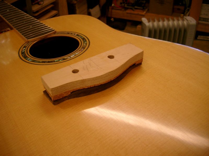

Gluing on the bridge is my least favourite part of building a guitar. I usually spend 3-4 days working out intonation and the best position to put the bridge. It then reaches the point where I say to myself....."stuff it if I dont just glue the bastard on now it'll never get glued on".
Pics attached of the process.
Finish scraped away to bare wood in bridge area.
Bridge positioned and anchored with shortened bridge pins in holes 12 and 1.
Upper bridge gluing caul. Holes are to clear the bridge pins used to anchor the bridge while gluing.
Lower Bridge gluing caul....make this while youre bracing the top.
Glued up and clamped up. The underside of the bridge got a wipe with acetone to remove some of the oil in the rosewood and reduce chances of joint failure. Im using Titebond I AR glue.

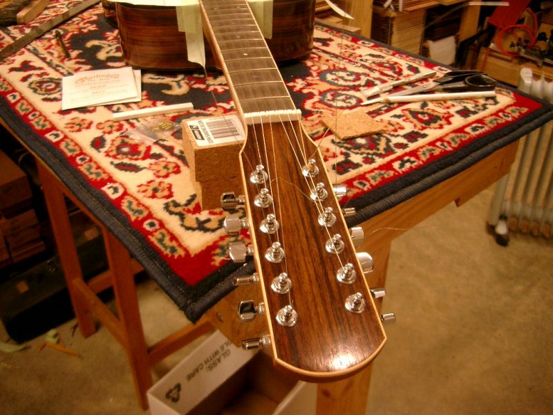

Post by kiwigeo » Sat Sep 20, 2008 10:22 pm

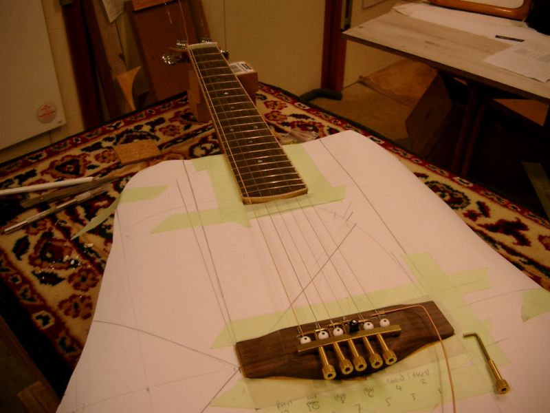

More progress on the 12 string. Got the nut roughed out, bridge pin holes drilled and tuners installed. Got half the strings on and am currently determining saddle position prior to routing slot for same.
Posts: 1086
Location: N.S.W. in the bush
Post by Craig » Sat Sep 20, 2008 10:37 pm
Ahh !what a moment Martin . Thanks for including these birth shots. Take your time at this stage. Hope my suggestions on your " compensation thread" have helped out.
