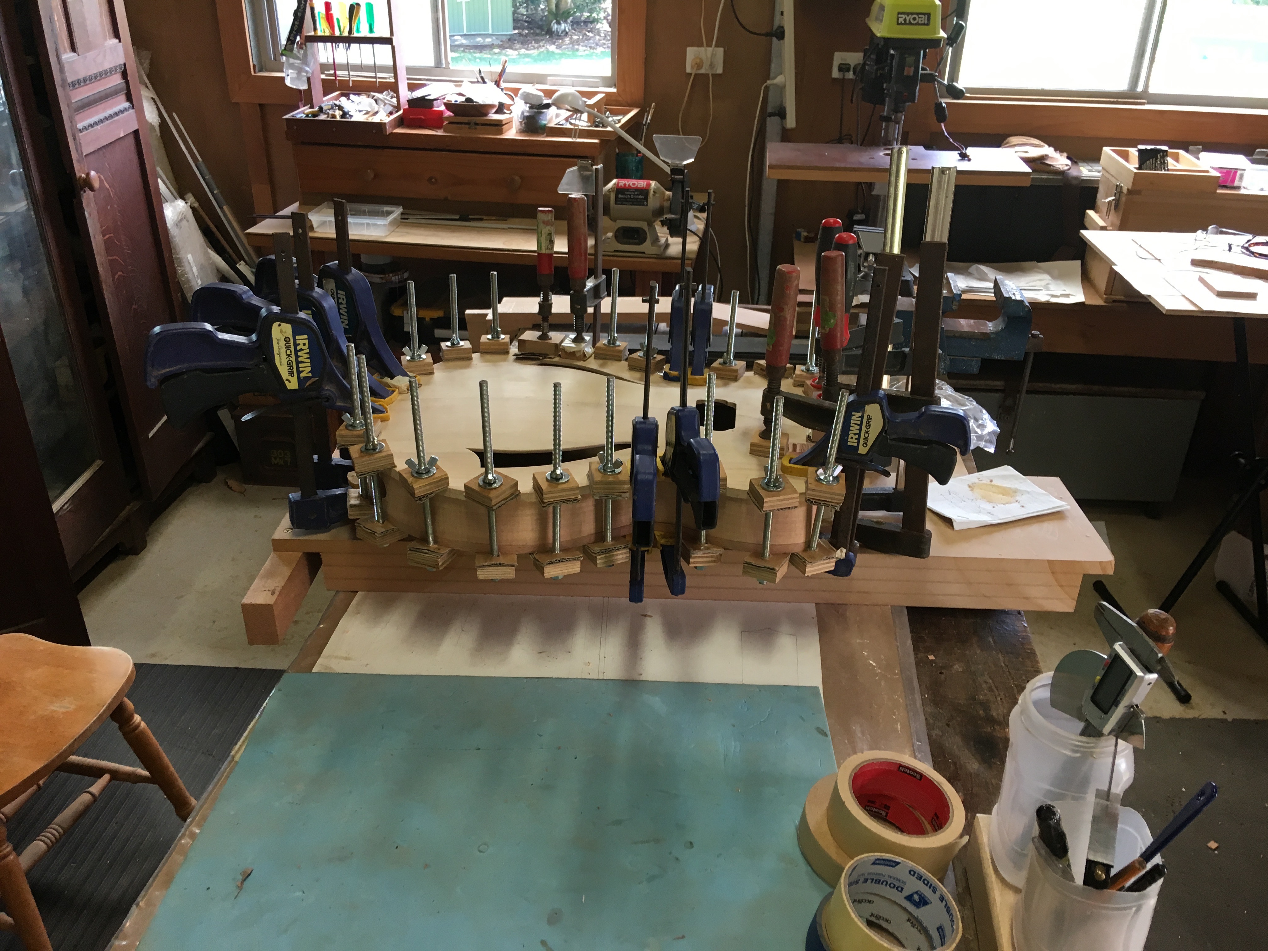

Here’s a few pics of my latest based on a typical archtop.
The photo of the whole bench shows my bending pipe setup on the right along with and the old coffee machine which supplies steam to the bend. Silky Oak can be a bit cranky as the figured grain on the outside of the bend is very short. I find the steam very helpful on that side of the bend.

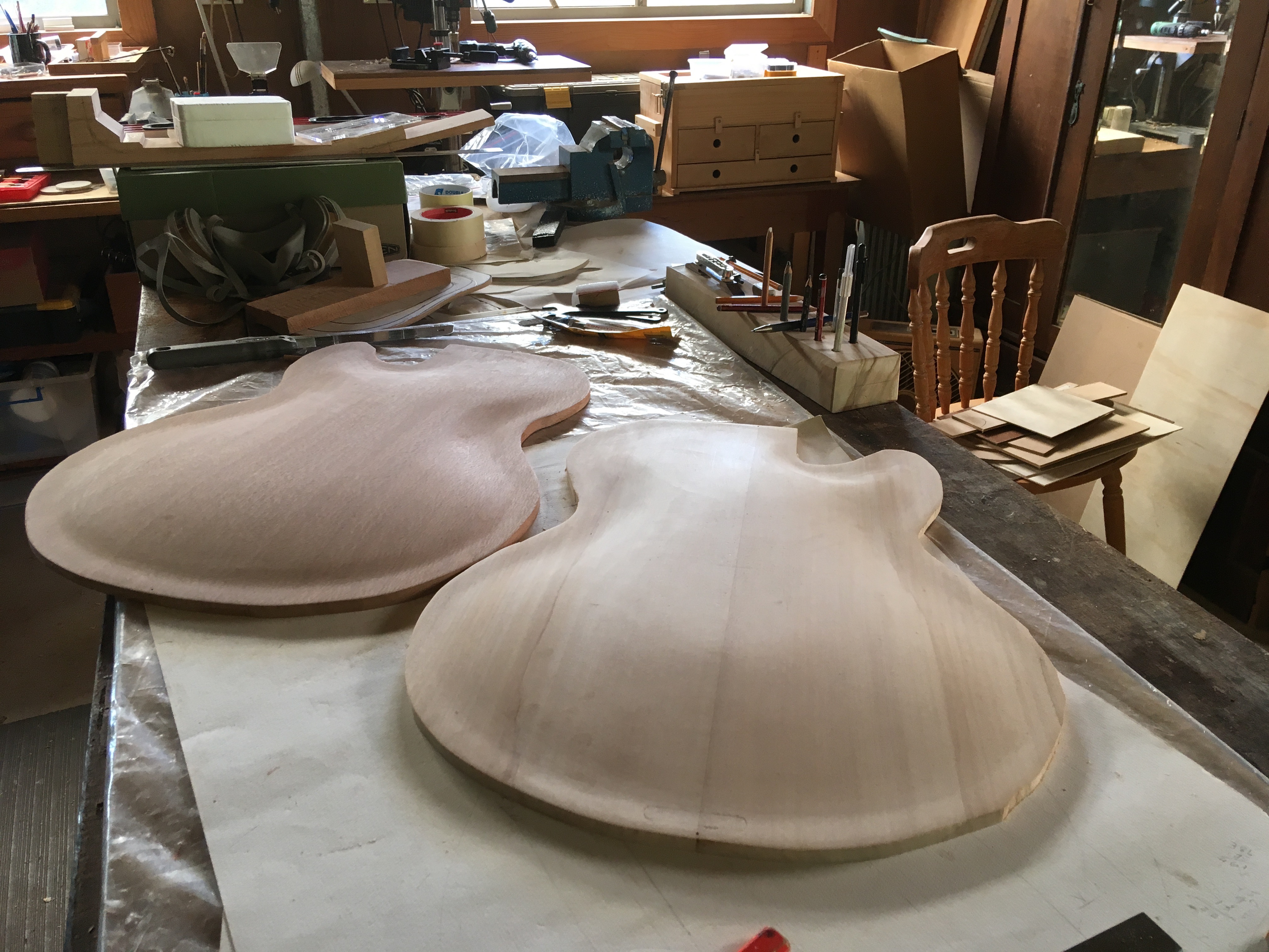

It's been almost 18mths or so but life and repairs/setups for numerous players got in the way. Here's the usual routing of the top plate.
Re: Builder Just Joined The Forum
After a month or so I had both the top and back roughly shaped. After this stage I spent some time fairing the contours

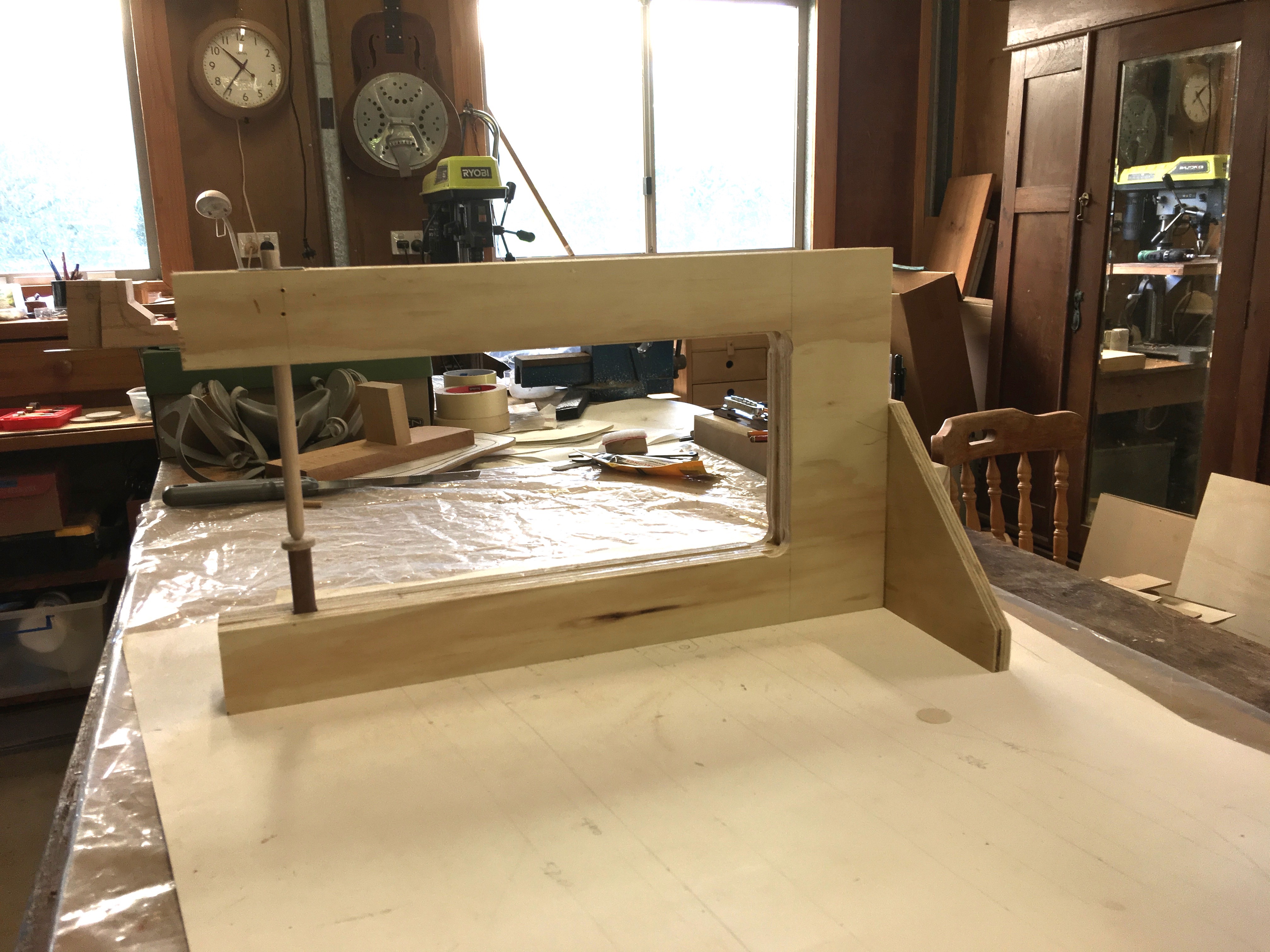

Here's the crude depth gauge I made with the dowel marked at 2mm increments. It worked well for me but others might say it's not accurate enough for their liking.

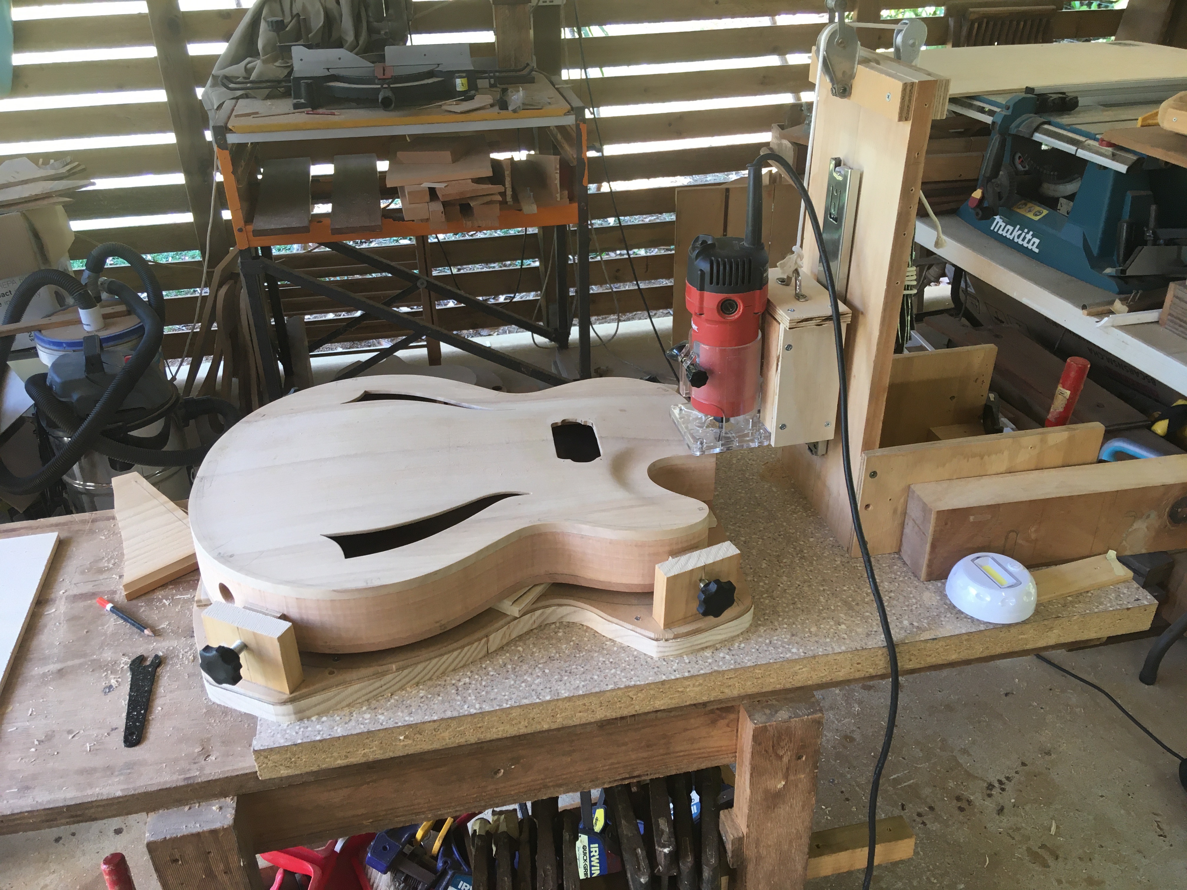

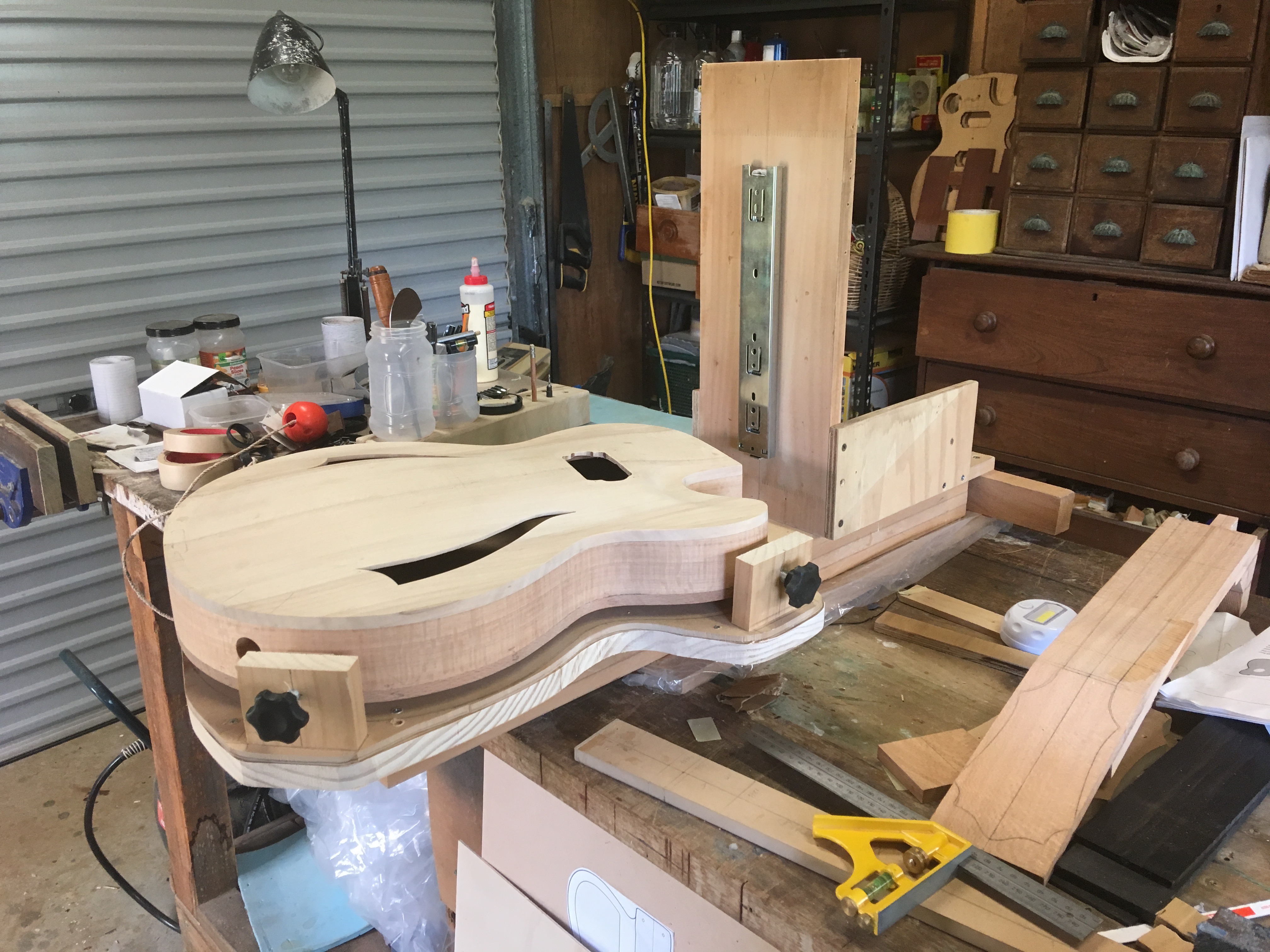

Another couple of pics here one shows the construction of a typical sliding router setup to make the binding channel. The is neck also shown which out of quartersawn silky oak. The other pic is the routing setup ready to make the binding channel.
