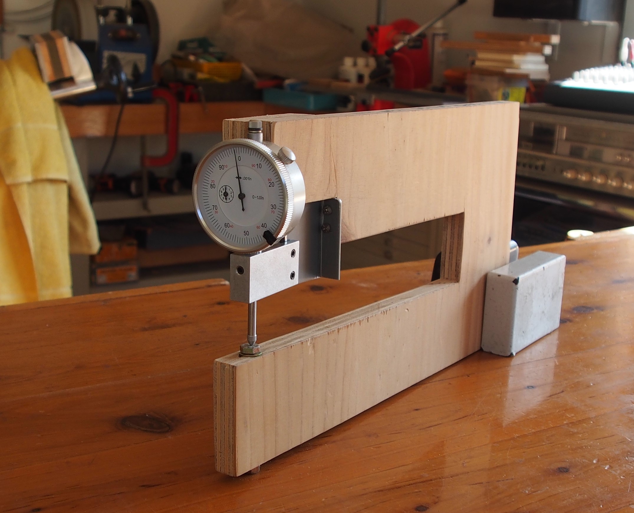

I made my own thickness gauge using the plans shown in the Gilet /Gore build book. I think 'Carbatec' supply gauges. I had a spare one that I obtained from 'Stewmac'.

I made an aluminium thickness guage, but have concluded that a marine ply structure is way superior...the aluminium is extremely temperature sensitive and the guage jaws move with temperature, even from the body heat of hand contact. I would surmise that the Chinese aluminium thickness guages also move the same way. Beware online as many are only big enough for violins, not guitars....best to make one imop. Cheers! Ross
