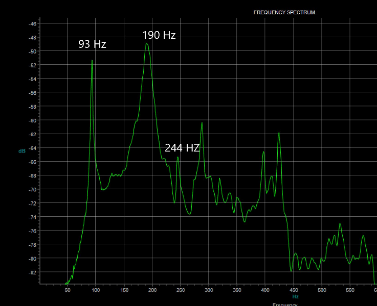

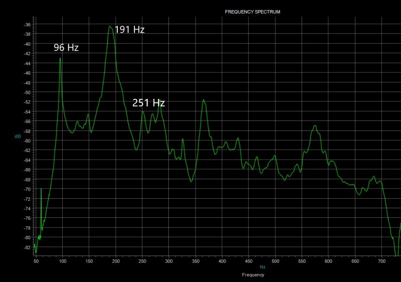

I do have spectrum graphs of the tap for this and the Osage Orange guitar I posted last week. You will see they are very close. The Pernambuco has a sound port which accounted for the higher Air resonance. I am not sure what the cutaway does to the air resonance T(1,1)1, I do know the sound port would raise it. In any case the Gore techniques are letting me get pretty consistent.
First this one the Pernambuco.
Tap spectrum after some adjustment.jpg (76.4 KiB) Viewed 6248 times
The Osage Orange
strung up to tune with close setup riszed.png (115.36 KiB) Viewed 6248 times
