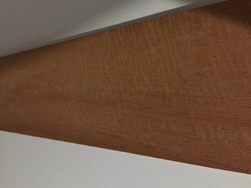

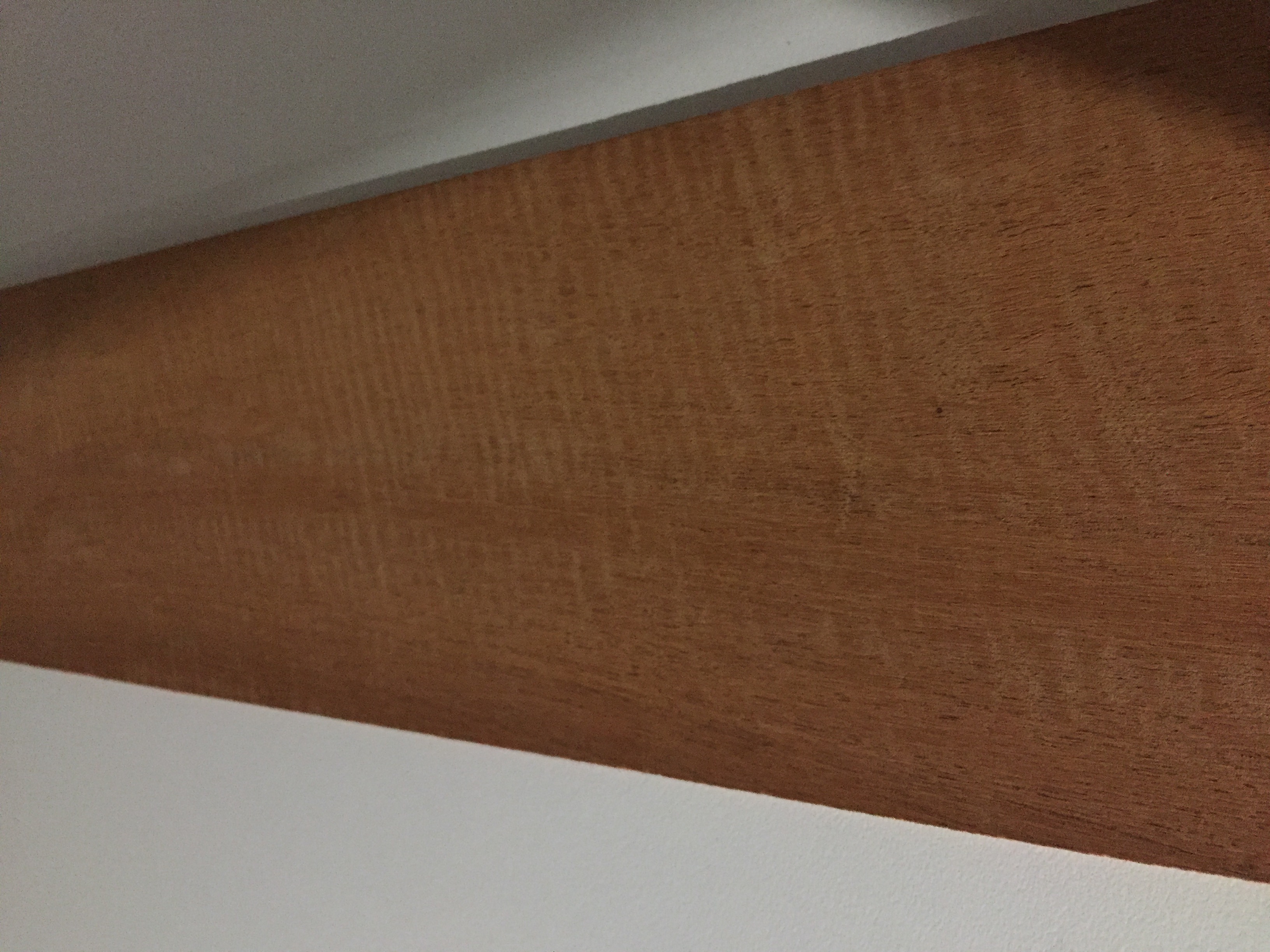

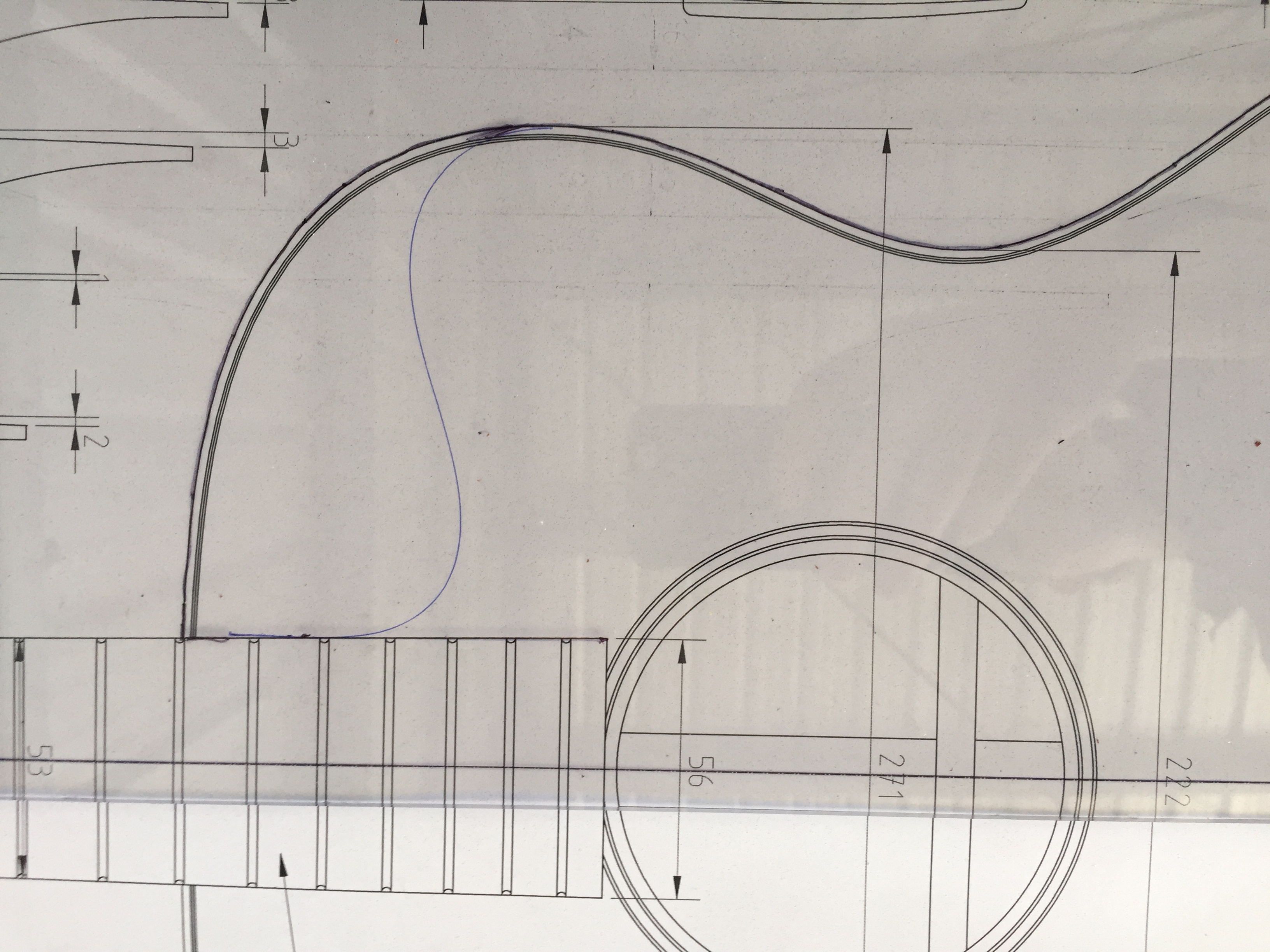

Post some photos shall I? Probably not what you guys call figured! Made up a stencil with a center line and marks top and bottom to create the cutaway shape as the plan didn’t have one.
Joseph
I’ll more than likely scrape the cutaway section thinner...
Also like the idea of some practice sets but I can’t see that becoming a reality.
Joseph
