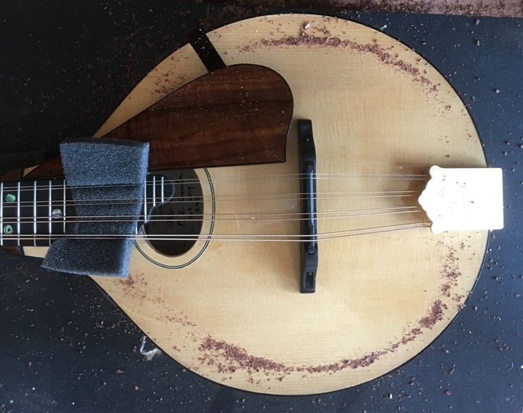

Here is a picture of the main top mode on the latest mandolin. You can see the fingerboard extension over the sound hole. Without it the main air mode was bang on G#, the fingerboard extension lowered it about 1/2 semitone. Mandolins are a bit more complicated than guitars because there is a tailpiece, and the tailpiece does change the frequencies, as does the tuners and pickguard, and the mass of the bridge of course lowers the main top mode. The tuners and tailpiece change all the frequencies quite a bit on flat top mandolins, but not much on arch top mandolins, but the interval between the main top and main back remains pretty much the same. The pickguard does add a bit of mass to the sides, so the main top mode is lowered a small amount.
The final frequencies of this mandolin are
main air - 205 Hz
main top - 507 Hz
main back - 633 hz
main air - 205 Hz
main top - 507 Hz
main back - 633 hz
