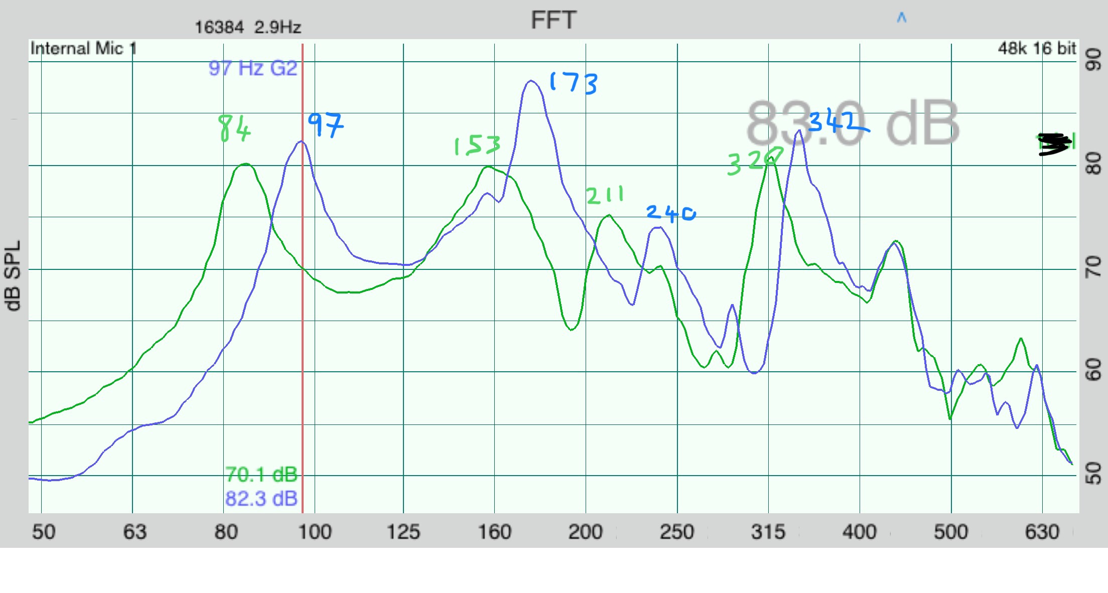

I have recorded the frequencies of two guitars, fully strung tapped with a hammer at the bridge and averages taken.
One is made of Walnut and is a good guitar. The other is made of cocobolo and is the nicest sounding guitar I have ever heard/built. Cocobolo is more dense than walnut so one guitar weighs more, aside from that they are from the same mould, same tops batch.
Two questions which is the best blue or green or is it just not possible to tell?
Can I aspire to construct all guitars to have the same frequencies as the better one or do material differences just not allow?
Which is the best Guitar?

That main top peak on the green (153hz) is very low. I notice that there is also a peak on the purple at same spot, could this be something in the environment ???
Because of the very low freq of the green I'm going to say the blue is the better guitar.
Unless the main top frequency of the green is the 211hz peak???
Either way, still backing the blue.

Steve you are bang on the money. Just need to stiffen the top I think to try and re-adjust those frequencies. With big hands like mine that’s going to be painful.
