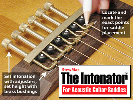

My main concern is intonation...I don't want it to be close ..I want it to be spot on. Which leads me to think maybe cutting the saddle slot after the bridge is glued on might be more accurate for intonation..(although I don't really want to shell out the coin for a stewmac saddle slotting jig )even though it looks good.
Or maybe locate the bridge position ( maybe screw it in tempoarily and use something like stew-macs intonator) and remove bridge and cut the slot with a homemade jig prior to gluing on.
How do you guys do it?

Hello Grant,
First thing to remember is that guitars do not play in tune. The frets are an average, and unless you want to have a different fretboard for each key you play in (as was sold some years ago) you just have to deal with that and not stress out too much about it.
Adding compensation helps, and using a 5mm (3/16") wide saddle helps even more. Cut the saddle slot at the usual angle and glue the bridge in place with the front of the saddle at the top e string position 2mm further back than the theoretical scale length. Jim Williams' book has a very efficient way of setting the contact points along the length of the saddle using bits of cut-off b string and a good tuner. The usual 3/32" saddle is not really wide enough to get accurate intonation on a steel string guitar.
Remember as well that all you are doing is setting the intonation at the 12th fret and that does not necessarily mean accurate intonation at the rest of them. There are those who use the Buzz Feiten (spelling?) nut compensation as well.

I've been cutting the slot in the bridge prior to shaping it. I use the Ibex fret scale rule to give me the length for the high E and using Luthier Supplies center line finder with bridge locator to place it.
Also I'd finish before gluing down. It'll make finishing sooooo much easier. You could locate the bridge prior to finishing. Even drilling a couple of holes through the outside pins, just to make it simple to locate once you have your finish on. It's also possible to mask off the area of the bridge footprint so you don.t have to scrape the finish back. I've done it both ways, and kind of prefer masking it off prior to finish.

Not necessarily Bob. I'm very serious about getting the intonation right - so much so that I do split saddles and have different rake angles for different designs (travel to britone) and have appropriate variants in my slotting jig, I find it easier to slot them off the guitar and then radius the bottom to match the tops arch, then make the bridge and then position on the guitar with neck fitted and bolted on the prefinished top, clamp the bridge and then drill and ream the two outside bridge pin holes for the plastic tapered pins that will hold it there for gluing. No guessometrics in terms of measuring as with the nut fitted roughly and marked I can measure each string length individually. Using a 3mm wide saddle and split saddle this way usually gives me spot on intonation on each string along the middle of each of the split saddles, and if not quite there is more than enough wriggle room.bob wrote:If you cut the slot before you glue the bridge to the top you are doing it by "guessometrics".
If you are serious about getting the intonation right you will cut the slot after the bridge is glued to the top.
Given that my bridges are curved side to side and front to back I would have more trouble making an appropriate slotting jig for doing it on the top and it would scare the bejesus out of me too - coward luthier
Horses for courses I think.

I can't see how it can be any more inaccurate to glue a preslotted bridge in place, than it would be to glue an unslotted bridge and then slot it. The front of the bridge slot is always going to be a certain distance from the nut which is not really going to change. I suppose there might be arguments about action height and string gauges affecting the amount of compensation, but I would think it very risky to establish a bridge position for anything else but an average action and string gauge. Once you have done it right once and know the position in relation to your scale length, what is going to change? I always think I should make up a jig that will fit in the nut slot and the saddle slot, but I have never got around to it. In any case I have been using the bridge position marks on an Ibex scale ruler for 25 years and it works just fine.If you cut the slot before you glue the bridge to the top you are doing it by "guessometrics".

The other thing to think about is that it is a lot easier to slot and drill a bridge when it is a rectangular piece of timber rather than trying to do it with a jig clamped on a domed soundboard.

Thanks for the pics Taffy...In the pic of your intonator jig I'm just wondering what the bolt at the back of the jig is for? Is that a stop bar that contacts the back of your bridge?

If you get the pre-slotted bridge saddle to be covering the right area then the process of using an "intonator" (at its simplest some offcuts of treble strings) to mark where you need to shape the saddle is exactly the same (with your saddle height and chosen gauge of strings on) as if you slot with the bridge on the guitar. You'll get exactly the same result. The precision is in pre-slotting in the right place and gluing the bridge in the right place - this can be done with monotonous consistency.bob wrote:I can't see how you can get it any more accurate than doing it with the bridge atached to the guitar and with the strings at the height that you they will ultimately end up at, and with the gauge of string that the guitar has been built for.
The idea of having to seperately shape and intonate saddles for going from say light to medium strings (or from say standard tuning to DADGAD with the same gauge of strings) is a puzzle to me by the way.
