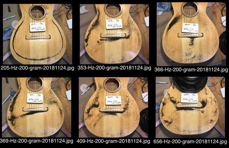

The tops are lightweight and efficient (top panel weights: 135 and 150 grams, bridges about 15 grams) and the main monopole resonance in the top as well as the main air resonance appear to have enough power to shift the pitch measured over a larger range of nearby individual scale note than I expected.
A few more details below (lots more in the page linked above):
I was surprised at how much the Helmholtz and T(1,1)2 resonances affected the intonation in the scale tones. Multiple scale tones below a resonance were flattened while those above were sharpened.

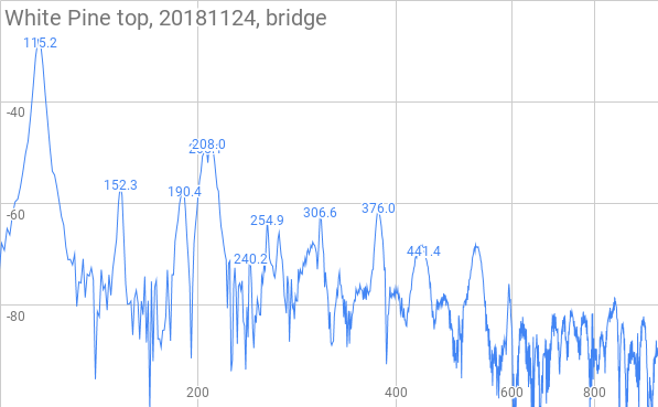

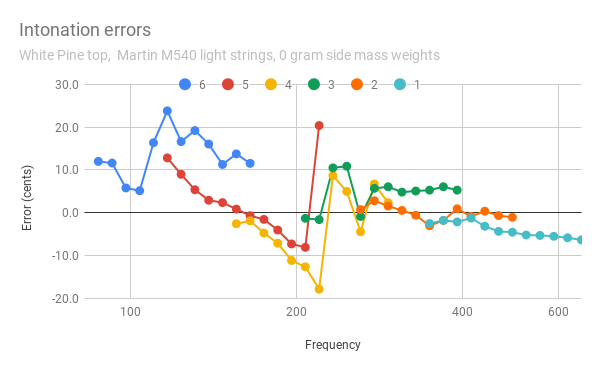

Re: Interesting intonation problems with two small high-performance guitars I just completed
Hi Jeff,
The graphs and intonation error tables are all from the White Pine guitar using Martin M540 phosphor bronze light strings.

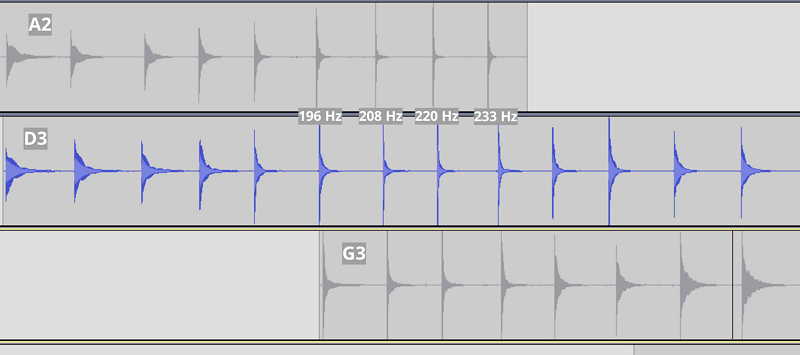

With the sound hole open (without any side mass weights) I measure the Helmholtz at 115 and the monopole at 213.
In the intonation error table for no side mass weights I see this amazing shift from D3:5-7 where the notes are getting progressively flatter: -11, -13, and -18 cents and the next three scale tones: d3:8-10: +9, +5, and -4 cents.
It seems like something is coupling with a frequency close to 218 Hz (which is 5 Hz above the measured monopole) and pushing scales tones below that flatter and shifting ones above sharper.
I also marked D3:7 which I measured at 217.7 Hz with an "unstable pitch when tuning" background color (yellow). There are certain notes that when playing them I can't get them to settle at the pitch I'm tuning for in a stable fashion. Getting as close as I can they start sharp and within about 0.5 s have switched to flat. A tiny bit tighter on the tuner and they are just sharp, a tiny bit looser and they stay flat. My interpretation is that they are coupling with a similar resonance.
I wonder if I have some small systematic error in my spectral measurement and the monopole isn't 213 Hz but more like 218 Hz??
This gets more confusing however with the data from the measurements taken with the two 300 gram side mass weights attached. In this case with the sound hole open the monopole measurement has dropped to 201 Hz but the intonation error inflection point is seemingly still sitting in between D3:5-7 and D3:8-10.
D3:5-7: -8, -5, -9
D3:8-10: 13, 9, 10
D3:5-7: -8, -5, -9
D3:8-10: 13, 9, 10

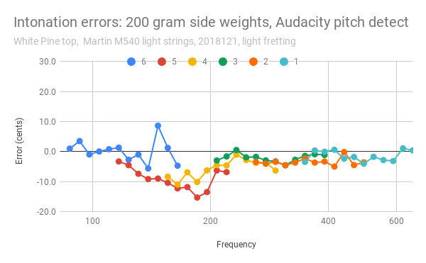

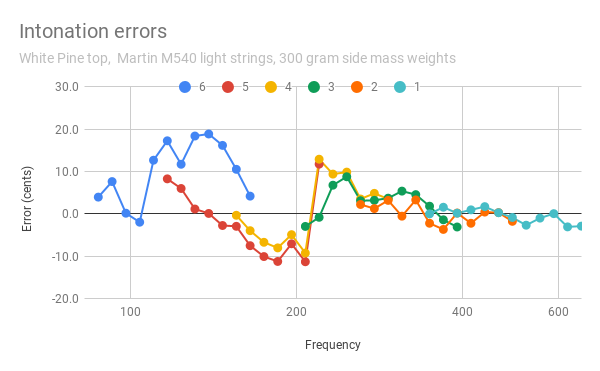

I added two graphs to my article (and attached images to this post) showing intonation errors for the guitar with the White Pine top and Martin 540 phosphor bronze light strings. The first is for the case with no attached side mass weights. The second is for the case with 300 grams of attached side mass weights.
The X axis is frequency over the whole range of scale tones from E2:0 to E4:12. This presentation of the data make it easier for me to compare intonation errors on different strings in overlapping pitch ranges.
This is just a new visualization of the same data I collected earlier. I haven't yet made any changes to the guitar or recollected intonation data by fretting lightly.
Looks like the monopole T(1,1)2 resonance is affecting multiple scale tones on strings 5, 4, and 3.
I find this presentation where fretted notes on different strings with the same pitch are at the same location on the frequency axis much easier to reason about than the same data in a table form.

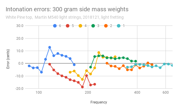

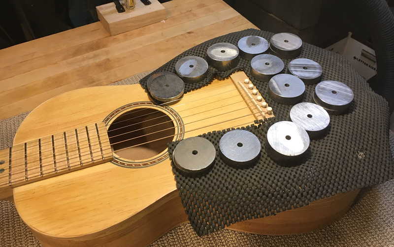

Without changing the guitar I collected the same intonation data using the lightest practical fretting pressure to get a clear note (presumably simulating what the effect might be if I lowered the fret height bit).
While many of the intonation errors are less there are still similar patterns of errors.

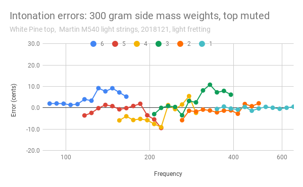

I then collected the same data however this time I worked to mute the resonances in the top lower bout by covering it with a rubbery friction fabric and piling 2300 grams of unused side mass weights on top.
I was especially interested in seeing what strings 6, 5, and 4 looked like around the T(1,1)2 resonance.
The T(1,1)2 resonance and presumably many more were reduced but not eliminated. The large flattening below 210 Hz and sharpening above have been reduced.
I am quite surprised that the intonation errors in string 6 around 110 Hz seem to have almost disappeared.
Here's what the actual top muting attempt looks like.

I re-collected all the scale tone intonation errors by collecting audio samples of each scale tone in Audacity. I actually had to do this twice, once at 8000 Hz to get high-resolution spectral data and again at 22050 Hz to get better resolution data for the pitch detect plugin to process.
I used my extended version of the Pitch Detect plugin which allows me to additionally specify an offset time to start sampling. My settings were a 0.25 s offset followed by an 0.5 s sampling period.
New intonation error chart as well as spectral data for scale tones with larger intonation issues.
https://learnmaketeachshare.org/instrum ... he-problem

Did you find a body resonance at ~ 430Hz?

I made a few changes and collected more intonation data and tried to force some visible chladni patterns on the top.
Changes:
1. Reduced the side mass weights from 300 to 200 grams.
2. Took 0.1 mm off of frets (about 1.15 to 1.05 mm) and re-crowned.
3. Lowered nut 0.1 mm.
4. Lowered saddle 0.2 mm.
Changes in measurement procedure:
1. Collecting 12 scale tones and the 12th fret harmonic with Audacity and later generating pitches using Pitch Detect plugin,
2. Now muting other strings during collection.
Now the maximum flat intonation error is visible on the 5 and 4 stings and is deepest around 185 Hz.
I put a loudspeaker over the sound hole (strings under tension and tuned), sprinkled black tea leaves and swept through a range of frequencies looking for resonance patterns. Didn't get very many but there was a strong resonant responses at 353, 366, and 369 Hz which is just about exactly twice the deepest intonation flattening at 185 Hz ... hmmm.
Here's a picture of what I was able to collect.

Hi Stephen,stepheneb wrote: ↑Sun Nov 25, 2018 8:09 am
When doing Chladni testing I generally hold the speaker over the bridge or lower bout area...depending on where the antinode(s) is/are. I also find that the higher frequency modes are usually never as distinct as those at lower frequencies.
Looking at some of the frequency plots you did earlier on in the thread I'm pretty sure I saw a peak around 430Hz. It was the test you did with soundhole open and no weights.

An interesting aspect of collecting the intonation data in Audacity is that it's very easy to correlate the much sharper initial drop in the shape of the amplitude decay curve with notes that seem "dull" and more "thunky" when I play them compared to nearby notes.
I already knew the most likely reason is coupling with a resonance that matches the scale tone -- but I find I understand the connection at a deeper level when I can combine multiple senses and representations.
The notes pitched around G3, G#3, A3, and A#3 all have sharper decays than nearby notes.
Intonation waveform data from A2, D3, and G3. Tracks are lined up so similar scale tones are vertically aligned.
Hi Martin,
I started by holding the speaker just as you describe, as close as practical to lower bout and over the bridge. I had a hard time getting the tea leaves to migrate effectively. By resting the speaker on the strings over the sound hole it seemed to work a bit better.
I was also under a family constraint to get this over as quickly as possible. I was in my basement workshop, with my good hearing protectors and the volume all the way up. The folks upstairs thought it was unreasonably loud!
I'd like to explore this much further when no-one else is home.
In that test with no side mass weights there was a set of four resonances showing up: 375, 399, 435, and one with a bit less energy at 482 Hz.
The first three peaks were also easily visible and somewhat dropped in pitch in similar spectral data collected when 300 gram side weights were installed: 363, 379, and 401 Hz.
I'm going to replicate that test with the 200 gram side weights installed.

Frequency response for the White Pine top with 200 gram side weights.
