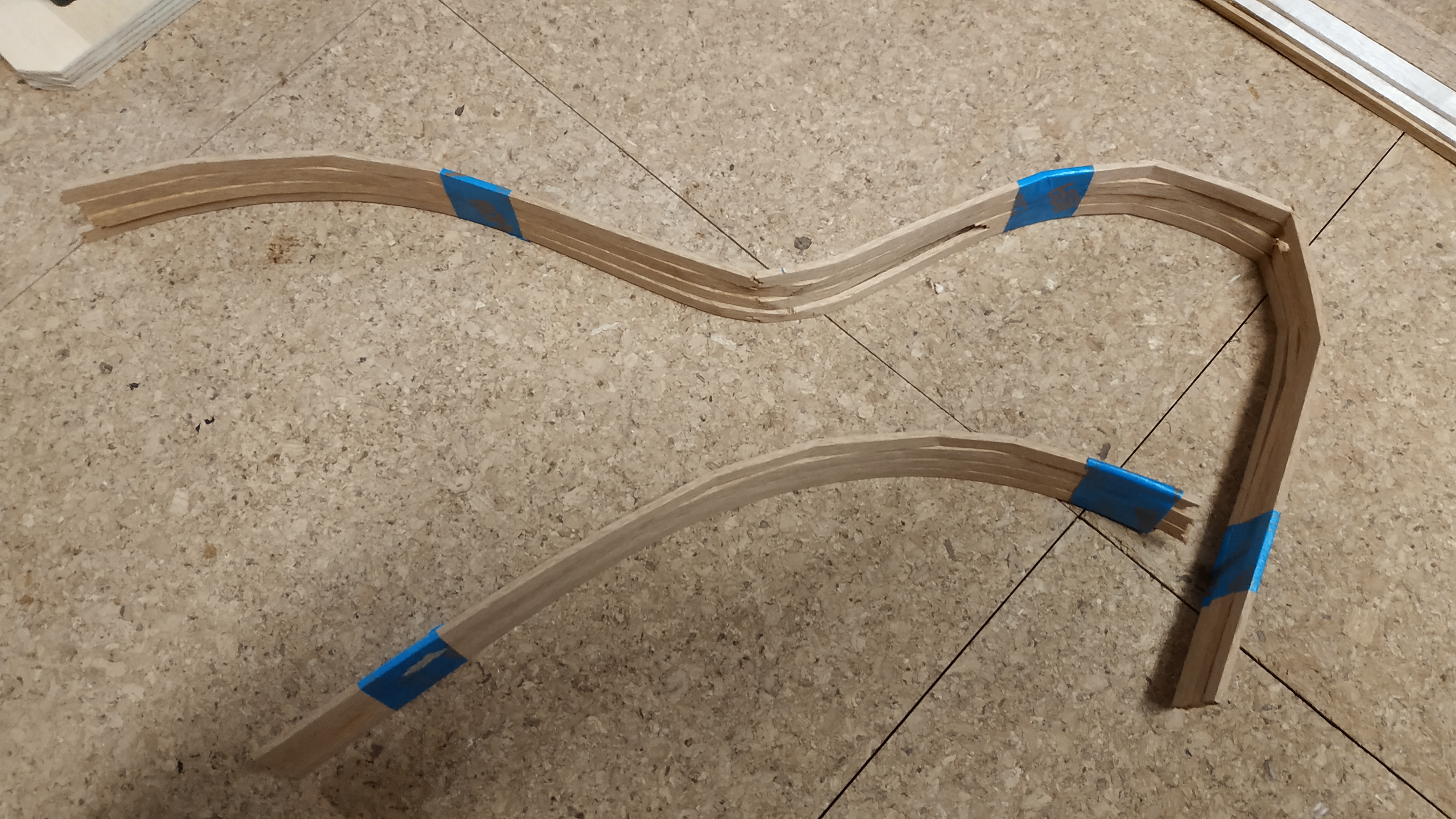

Post by Valben » Tue Oct 02, 2018 11:42 am
I had some strips of Louro Faia (kind of lacewood) and got the idea to use this timber to bind my next project. The result can be seen below:
I thought was funny enough to deserve sharing... :D

Post by Mark McLean » Tue Oct 02, 2018 7:40 pm
Well those pieces just didn't want to bend! You gave it your best shot. It's lucky that you have a plan B (right??). I am sure it will all be OK in the end. You just need some other bindings.

Post by Valben » Wed Oct 03, 2018 9:12 am
Yes, plan B is for blackwood binding which bends nicely and will properly pair with the Jarrah back & sides :wink:

Oh wow, I have never seen binding so cracked and faceted. How thick were they and what procedure (temp/water etc) did you use?

Post by Valben » Thu Oct 04, 2018 8:52 am
good question :) I have followed my standard procedure for binding (with little variations according to the timber in use).
Thickness 2.05mm, tape the binding strips and protect them with paper after wetting the wood (wet but not soaked) with a spray bottle containing tap water.
I usually start bending the lower bout at 230F & upper bout at 270F (290F if I have a cutaway), keep heat on until reaching 300-310F max and then remove heat and let it cool down for at least 1hour.
The lesson learn here is that the Louro Faia looks nice but it is not a proper timber for binding job but, I am curious.... has anyone from the forum successfully used Silver-oak, Rewarewa or other Lacewood timber for a binding job ?

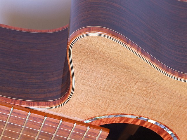

Dave M
Posts: 629
Location: Somerset UK
Re: Louro Faia for binding .. a complete failure
Post by Dave M » Tue Oct 09, 2018 3:18 am
Yes Trevor has caused a fair bit of grief pretty much round the world with that cutaway!

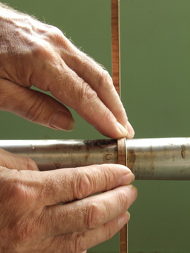

:D I must have done dozens of those cutaways and never really had a problem. In terms of binding, the figured blackwood and figured sycamore/maple are the easy ones, because the wood is pretty floppy. The tough ones are the bloodwood ones (Brosimum rubescens) because that stuff is so stiff that the bending has to be nigh on perfect, because there is no way you'll pull in any misfit even with filament tape. The stuff just doesn't flex once bent. Here's another blackwood one (from over ten years ago) and a bloodwood one.
And here's the instrument of torture. I made it from thick walled aluminium tube, 38mm diameter, 3.2mm wall, squeezed a bit in a (big) vise to form a short flat on it. It has a very similar shape to the "point" of the cutaway, as it happens. It has 500w of heaters in it. More details in the book, of course.

Post by blackalex1952 » Tue Oct 09, 2018 4:31 pm
Trevor, you look pretty close to burning your fingers...I use good quality leather riggers gloves and an apron to do my hand bending on an iron I made then installed eBay Chinese ceramic elements, and an eBay PID controller.I had an aluminium casting works in Port Melbourne pour the aluminium from a craftwood shape I made specifically to do the Selmeroid cutaways. I shaped the first piece of craftwood then kept screwing the subsequent pieces in, using a bandsaw then a pattern following bit to refine, followed by a little sanding and squaring up. .....
Then I refined the aluminium on a belt sander, and drilled 10mm holes for the elements. I also had them pour some aluminium into a couple of pieces of stainless tube which I also drilled and installed the creamic elements in. I used fire cement from the local hardware shop or Bunnings...it's used for sticking new faux asbestos woven door seals into wood heaters. A sparkie gave me an offcut of the fibrous material that electrical switch boards can be custom made from then mounted the whole shebang on some timber which can be clamped to the bench or held in a vise, either vertically or horizontally. The reason I use the apron and gloves is because I was merrily bending away and got a bit hot, only to find that I'd melted the zipper on my jumper permanently closed. :mrgreen: I use a lot of figured plane and Silky oak for my bindings. No problems there. If I have a problem with bending by hand I spritz the wood. Don't even have a bending strap which I'd like but a ceramic element will be before that and a fox style bender, I guess....ahh luxuries! I'm going to try bending some bulloak bindings soon for a tight Selmer style and will of course, report here! I also hand bend solid liners, I have been using Japanese Beech for that but also have some Hawthorn which is related to boxwood. Solid liners are essential for the Selmer style guitars, particularly the tops. The Selmer projects have stalled for a while due to health reasons, winter in the mountains, an OM build, a Gibson L-00 flat top, and numerous restorations and repairs which I have decided not to do anymore... So keen now the warmer weather has returned to get right into the projects, my ones, for me! I'll soon be able to spray again in the warmer weather. It's cold in them thar hills, just below the snowline! Cheers! Ross
Well, that shot was posed for the book. I was operating the camera at the same time as posing for the shot. But I don't wear gloves when bending wood anyway. I haven't burnt my fingers yet, but that's perhaps not a recommendation for others! Not wearing gloves certainly keeps you focused on what's going on, lets you feel the temperature, the wood and how it's moving.
I frequently get asked what the trick is to bending wood. My normal answer is there isn't one (other than patience). Maybe this is the trick: don't wear gloves! :mrgreen:

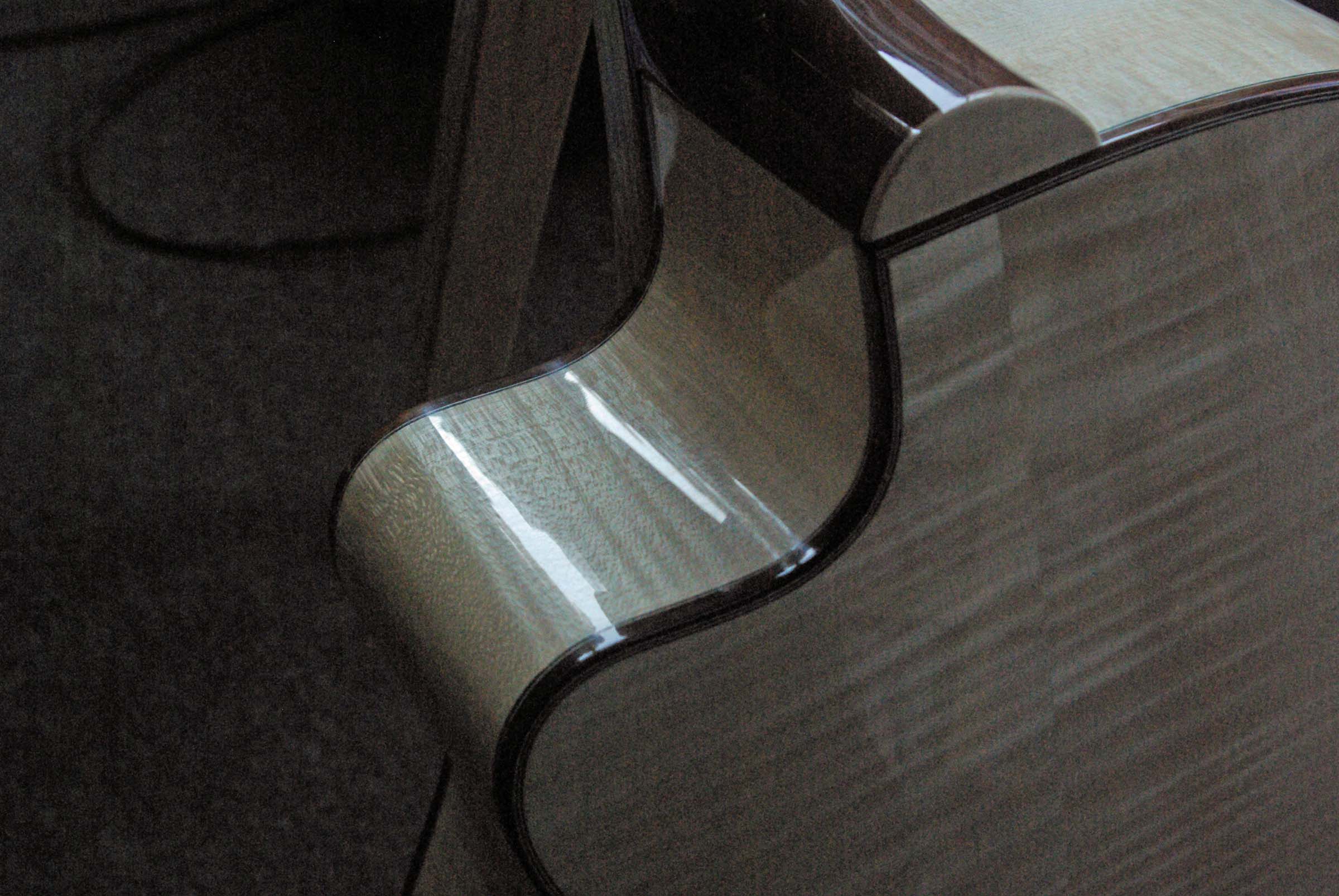

And of course it isn't just the bindings it's the side as well. But we persist because we like the shape and because we love the cutaway, even - actually - especially on classicals. I haven't been quite as sharp on this one but I do like it.
