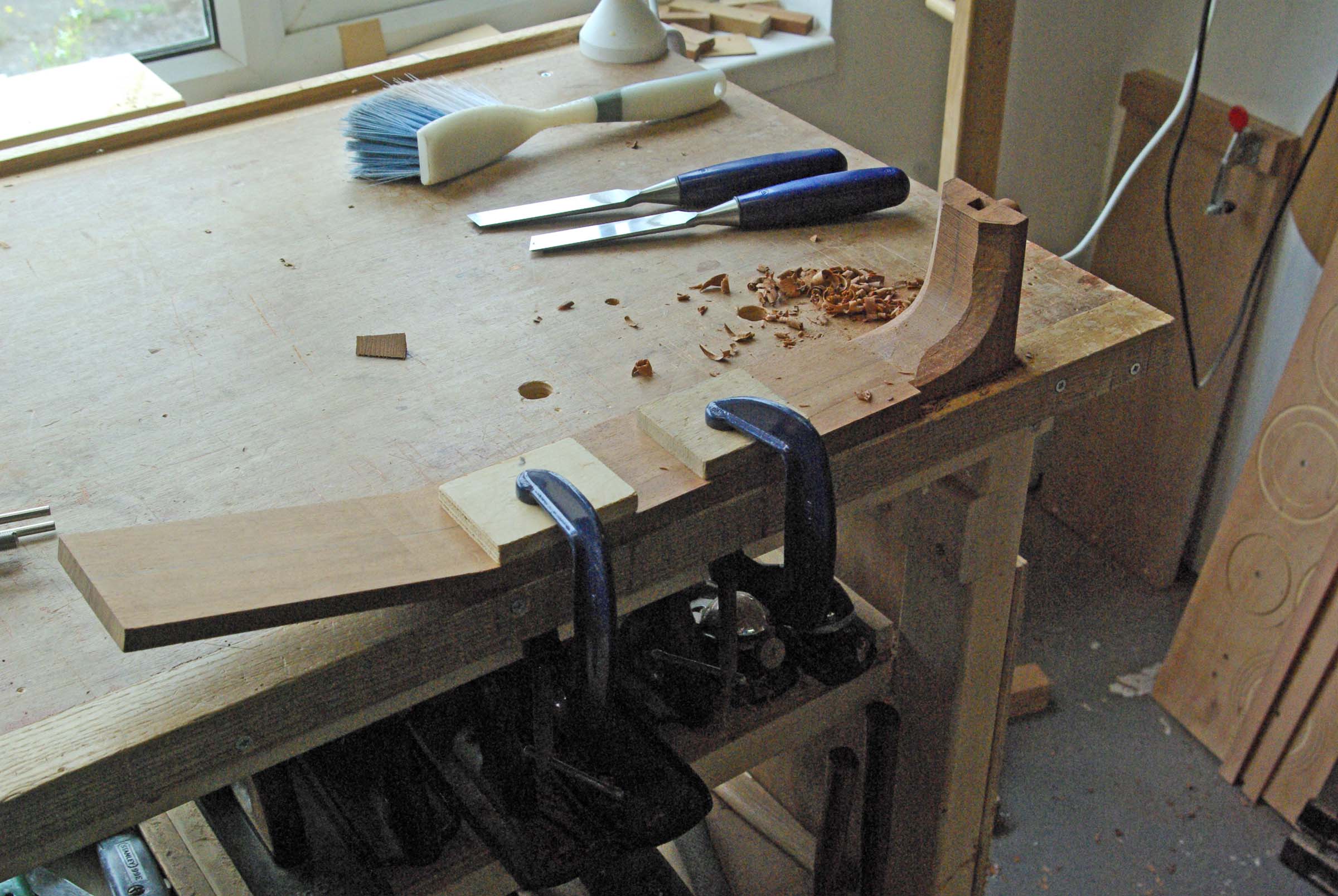

I have inadvertently taken my neck down to 15.4 mm around the 1st fret. It will get a bit thinner at the zero fret position. This a Steel string done in Mahagany. Is this too thin? Do I have to consider glueing on a veneer or is this going to work? It really feels very thin to me. I have already put a lot of work into this neck to get the geometry right so would love to be able to use it. It is also down to 17 m at the 10th fret which I guess is not so problematic.

I didn't explain too well... this is the neck without fingerboard. I have a minimum of around 6 mm to the truss rod groove so that should be OK.
I take the comments on neck feel but my real concern is whether it is going to be strong enough. I guess I could leave the fretboard at 6.5 to add a bit, but there is still that section under the nut left a bit thin.

You’ve got nothing to worry about. When you said neck thickness that’s usually inc board! If you’re at 15mm and add a 6.5mm board, that’s plenty thick and 5mm beneath the truss rod slot is ample.
I drum sand my fingerboards to 6.5mm and then radius from there, when radiusing i dont loose much center thickness.
May I ask why you’re carving the neck before the fingerboard is on? It’s ususlly carved after, so you can carve back to the fingerboard. There’s always more than one way to do a job, so I’m not saying it’s wrong, I’m just curious on your thinking behind doing it that way.

The thickness below the truss rod channel on my SS String guitars is around 4 to 5mm near the nut. I also carve a volute in the neck for extra strength. The truss rod adjustment is also at the nut end. Refer to photo.I was wondering if anyone takes theirs down to this thickness...?
All should be OK for your guitar neck build.

Thanks for the reassurance. It was just a moment of panic seeing this slender piece of timber and thinking of all the stress it would be carrying.
Alan I don't think I would even try a harder neck material! Also I am simply following the G&G methodology. Previously I was blending the tapered neck shaft into the headstock. I am now carving the heel down to about the 10 fret. Having the neck shaft square at this point makes it easy to grip. Then I shall glue on the radiussed fretboard and shape the neck shaft as you say to meet the fretboard, plus any adjustments at the heel, and the transition to the shaped headstock.
The mahogany is behaving much better under the chisel than I expected.
