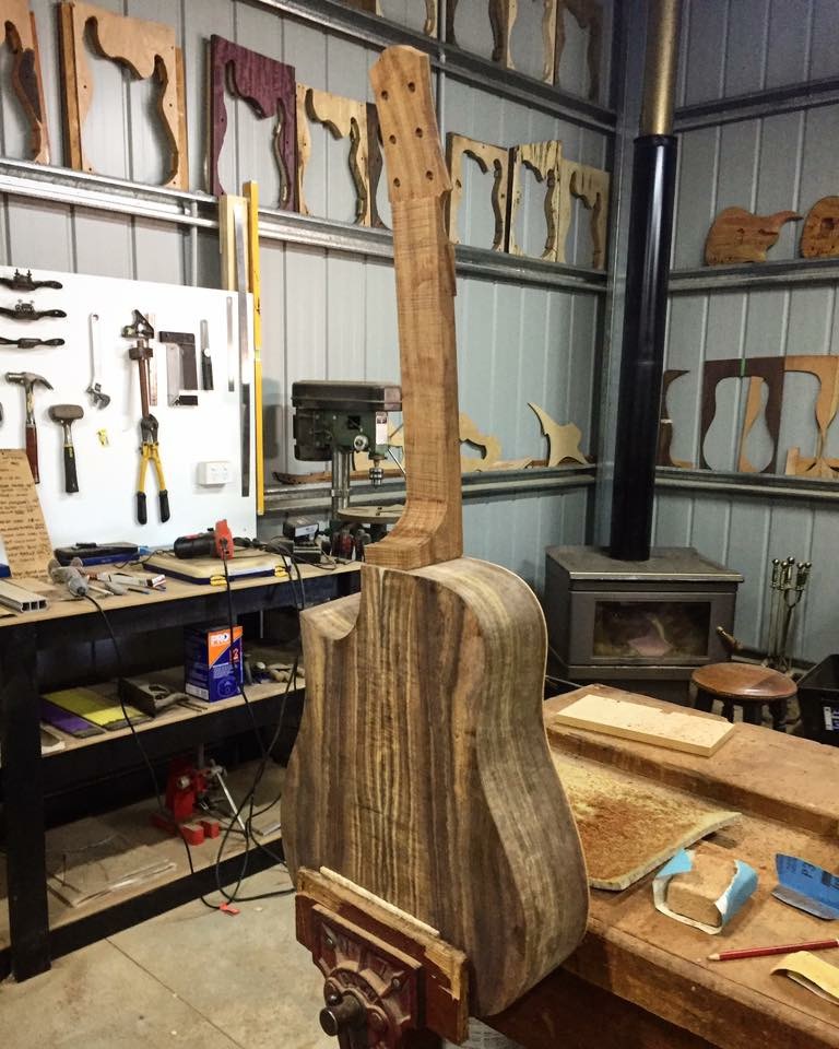

For guitars, yes, a couple of times. Here's one. The other one looked much the same, but I left out the sap wood. Hard to bend the figured wood without leaving flats in it and very dense at ~1300kg/m^3. The straight grained wood planes fine, but the figured wood is pretty much sanding only. It won't even scrape very well. Very hard to male a live back guitar out of gidgee.

I've used it on a uke (posting.php?mode=reply&f=1&t=8173 ) with a cutaway, I never really had any issues with it, I also have a guitar set here which i'll be using on a SS when I get a chance.
