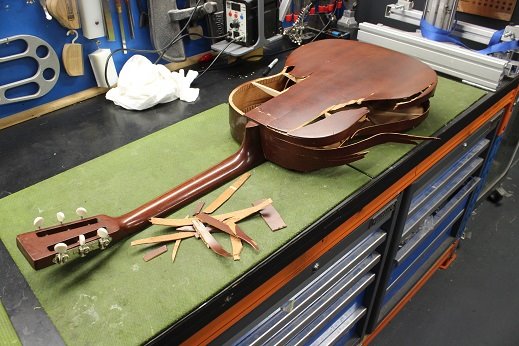

Here’s the newest back burner job started today..it was a Martin.

That looks like a challenge! Look forward to seeing the results in about 6 months.

I call these jobs "Train Wrecks" :mrgreen:

Times are going to have to be very quiet :shock:

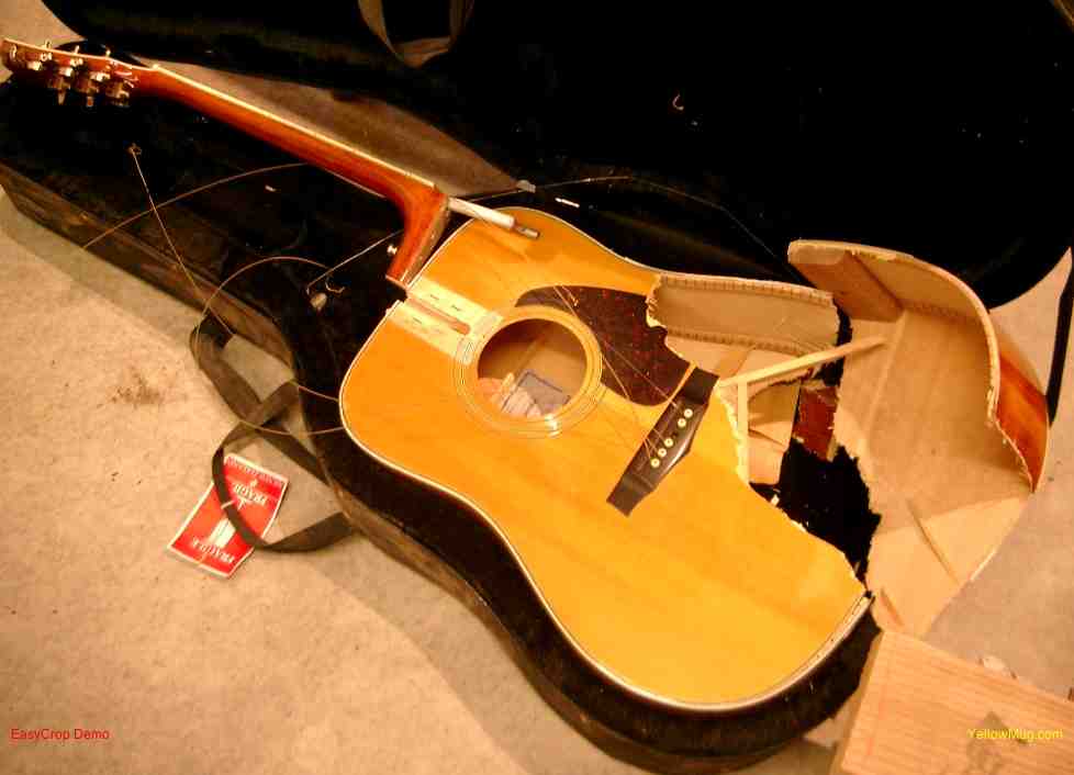

Had a similar job come in a few years ago....

Are you sure that wasn’t a case you doing your block Martin??

I had to rebuild a similar Martin which had similar injuries. I opted to rebuild with new back and sides upgrading from the original mahogany to Indian rosewood, keeping the soundboard and neck. The client was happy with this approach. The result was a much better sounding guitar than it was originally, ie more punchy and defined bass response and sustain. Also no obvious patchwork repairs. He was comfortable with the guitar not looking like it had come out of the factory as I opted for rosewood bindings rather than the plastic Martin was using on the rosewood version of that model. The only issue I encountered was keeping to braced soundboard in shape while I constructed the rest of the box.
So my back burner became a back and sides burner as I warmed my hands on it by the fireplace...Ross

Ouch to the other guitar, thats possibly where I would say, Mmm maybe not its cheaper and quicker to buy another one.
This one we are going to patch the sides, he wants the scars to remind him of what happened, but its going to get a new back

This one was the classic guitar left leaning against a wall at a raging party......you see it so often.

Won’t be for a while, I don’t see the point of doing a walk through on this one, as it’s not a typical repair one comes across.
I may when I make a new back for it, do a simple tute on how to make and fit a new back?
