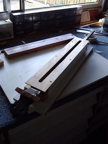

Grant,
Routing a truss rod channel deeper with neck on the guitar is not a huge issue. Make up a routing jig from plywood or MDF and secure it temporarily onto the neck using wood screws. My jig is just a length of MDF with a slot routed through it to allow the router cutter to protrude below. Onto this I have two lengths of MDF attached to act as guides for the sides of the router sole plate. The router runs along the recessed area between the guides and Bobs your uncle. Sorry I dont have any pics of my jig handy.

Post by matthew » Sun Aug 17, 2008 5:56 pm
I use the same jig as Martin. the MDF routing template tacked onto the neck and a sliding baseplate for the router
A trick I use to help you know when you're reaching the end of the slot is to place the router in "end position" and mark two converging lines ending at the edge of the baseplate. Do this at both ends. Now you can be sure where you are, even with the router screaming atcha and swarf flying everywhere ...

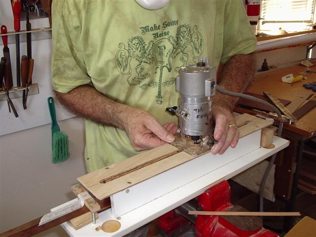

Post by Taffy Evans » Sun Aug 17, 2008 6:56 pm
I think its pretty much covered, but heres a pic of a banjo I had to do. There no body to worry about but the jig is similar

Just for some closure on this thread...just in case anybody is researching this topic in the future this is what i did.
I followed Martins advice to a simple jig that screws into the neck and used my straight edge as a fence..Thanks for those pics as well Taffy..
I've read so many different opinions as to how people install their truss rods..I did this.
Ran a very thin bead of silicone down each bottom edge of the channel and put 3 small dots of silicone on each side of the rod.
I'm using a gotoh 2-way rod so i roughed up the top of the rod with some course sandpaper...placed epoxy on the bottom of the filler piece and titebond on the edges of the filler piece...clamped up and...bob's your uncle...
So ,...thanks everyone for your advice ..I'm so glad to have gone with a filler piece instead..It feels like there will be less of a chance of a rattle ocurring now.
