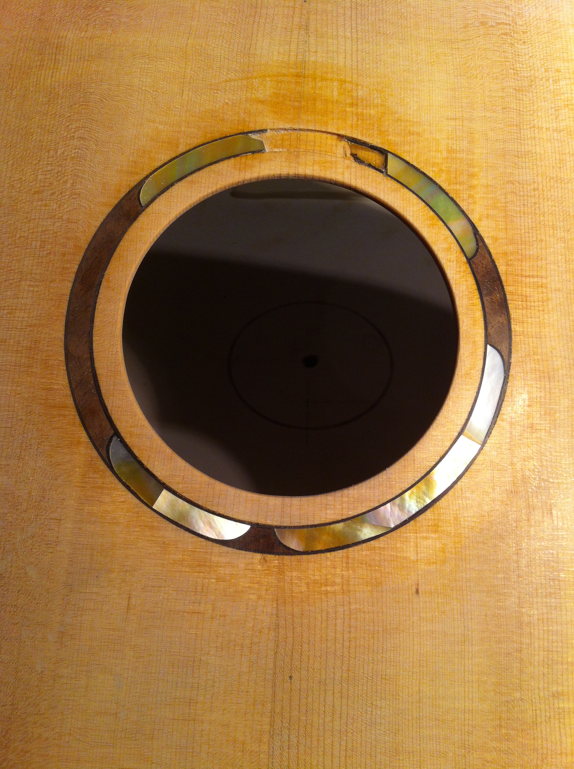

I use it for many tasks, drop filling finish repairs, fixing tear outs, fine crack repairs, some binding work, MOP inlays, rosettes, electronic repairs, hole plugging with a dowel and the glue-the list goes on.

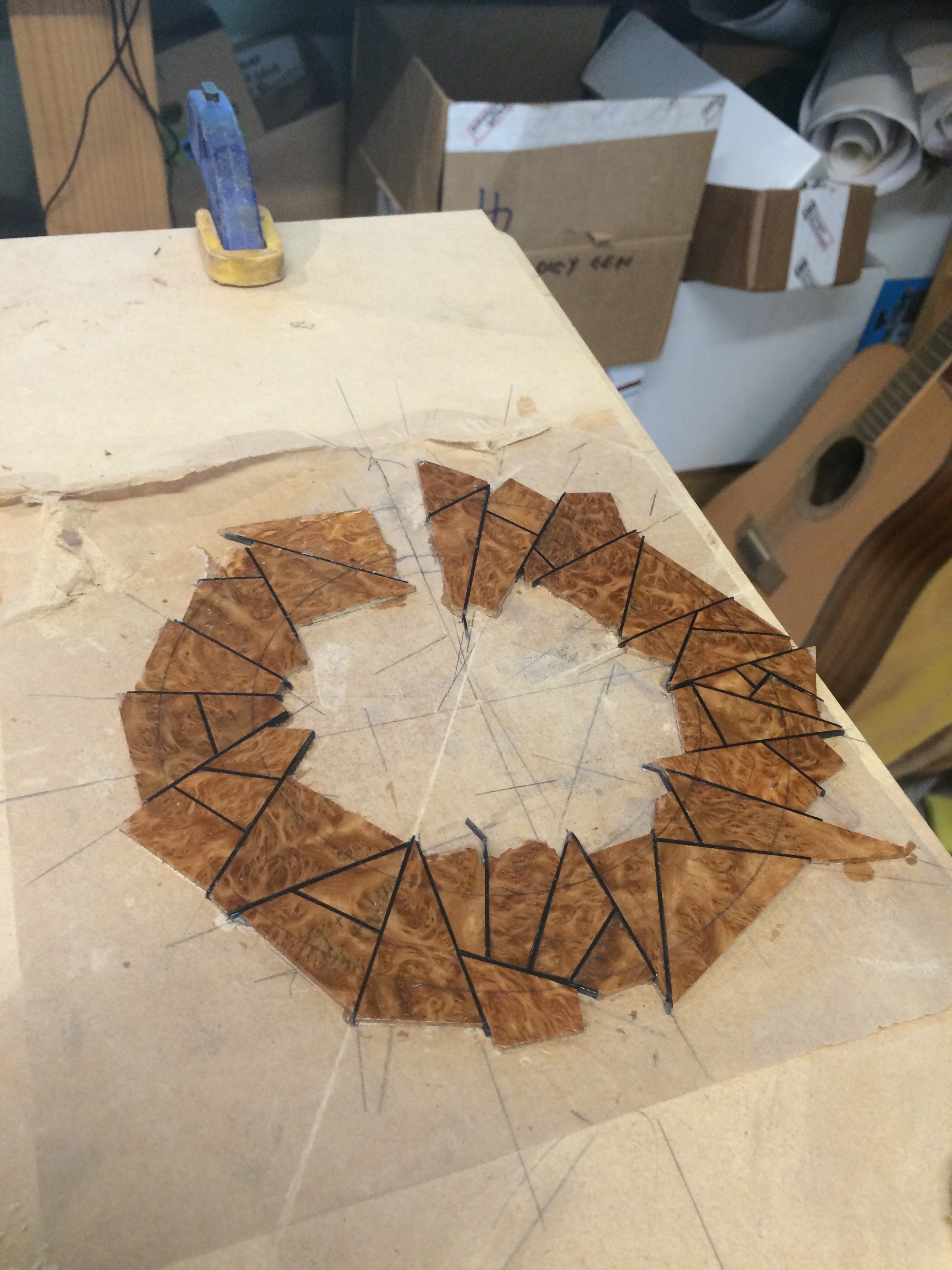

My stained glass style rosettes rely on superglue to hold them together..I wick the glue in between the pieces and also into the Coobah burl to give it a bit of rigidity and fill in any gaps.
