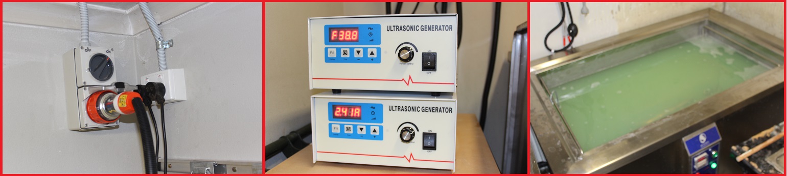

This one has taken a while to finish as we are at the start of our christmas madness repair schedule for schools.
Just had a new Ultrasonic cleaner fitted to handle this years christmas chaos, this machine is big enough to take a tuba
Car parts need cleaning anyone

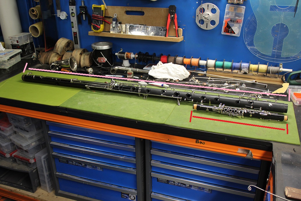

There is good money in repairng Woodwind and Brasswind, its hard work but pays well.
This photo I took this morning of a Contra Bass Clarinet being Mechanically rebuilt, its costing them 2200 dollars, its the pink one.
