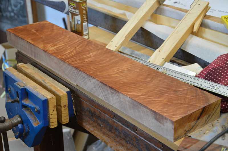

Thanks for the suggestions. Here's a pic of the timber:
(It's 2" thick)
I'm thinking of slicing it up for B&S for a terz (ie Martin size 5).
I'll cut the sides thin and soak in hot water and fabric softener and try to bend by hand on an iron.

Lovely looking stuff. Just cut one set and try in water and maple. If it snaps (and short grain can, even with fabric softener) I'd be hunting someone with a good quality saw to make that into veneers. In Germany here, there are several shops who offer the service.
Vacuum veneering is a lot easier than folk think.
