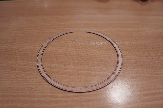

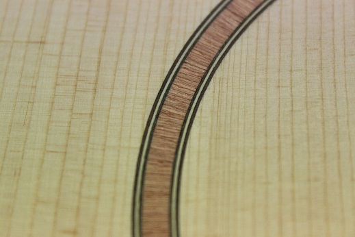

Having done a walk through on making a very basic rosette, I did a follow up using my LMII rosette channel cutter.
Again I would love to get hold of one of Allens rosette channel cutters as they are super fancy, anyone want to sell me theirs?
This tool from LMII is IMHO, one of the neatest channel cutters on the market, super clean edges

No tear out.....that's pretty good for a fly cutter. Ive tried a number of the hand cutters, a few fly cutters but in the end I went back to the Stewmac Dremel rosette cutter jig. If there's a risk of tear out I'll do a run around with a hand cutter and then hog out with the Dremel. I stiffen up the top with a few coats of shellac before cutting the rosette.

I too have the stewmac router sleds, I have some brass block rosette channel cutting jigs as well, my circle cutter and so forth, the one from LMII works really really nice, but it's important to cut slowly and store the cutters in a box where they won't get damaged,
Good idea on preshellacing the top, never really needed to do it with the LMII unit, but it's a very good precautionary step.
I see the partial rosettes capable of being done with Allens rosette cutter and that is my next goal as I have never cut one of them.

I use the dremel with Kyocera diamond spiral cut bits. The shellec trick also minimises wicking into the spruce when using superglue, thus avoiding the greenish discolouration of the wood and it is a good idea to use a fine applicator of some sort to shellac the sides of the rout but not the bottom if there is a problem with the superglue wicking.
